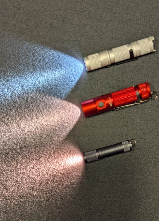

Did a few emitter swaps the past couple of days. All 519a DD’s. 5000k, (not sure on the middle, probably 3500k?, and 2700k for the bottom.
The AR glass in the Tool AA really changes the tint on that light. Almost removing the effects of dedoming.
You can remove the AR coating.
I removed the AR coating in one of my S2+ that had a purple coating and it made a big difference.
Thanks! And I just realized I posted this in the wrong thread. LOL! I thought it was the “What did you mod?” post. Oops!!!
