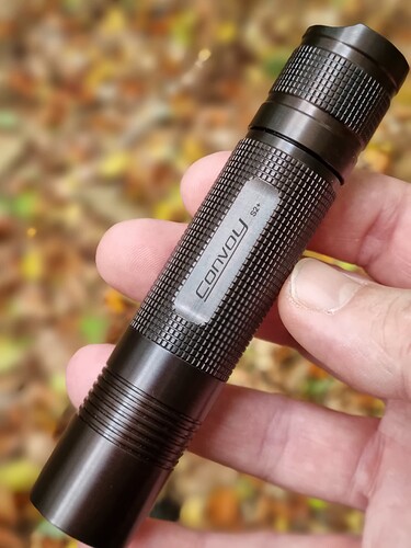

Convoy S2+ Brass “Dark Chocolate” (oxidized) :smiling_face_with_three_hearts:

Did you put it on the gas stove to burn like this?
I left the parts soaking in drain cleaner for three days. As a result, the protective coating has been completely dissolved, and the discoloration is evident.

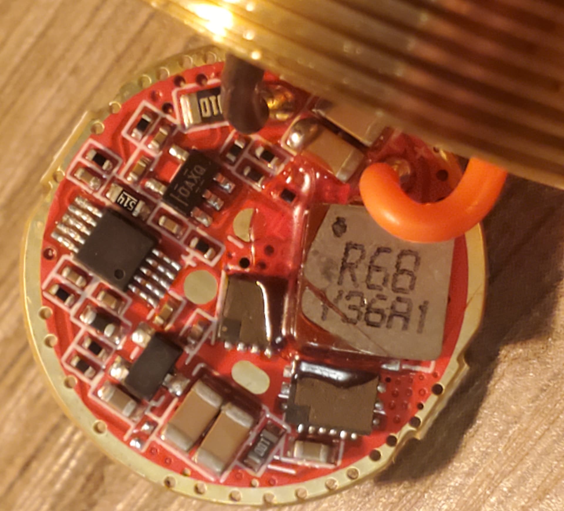

Hey all, I’m hoping to identify the driver in my Z1 with SFT40.

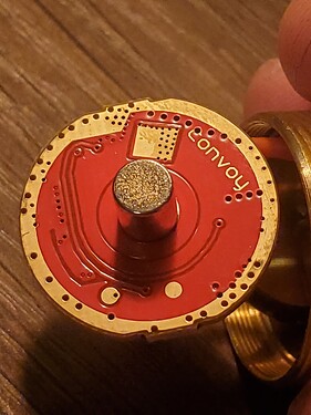

I was going to get a new 3v 8A driver (and SFT-25R )for it as I thought I had a linear driver because of how long ago I got it, but on inspecting and comparing to the ConvoyLight website it appears to match the 3v 8A driver besides having a brass post instead of a spring.
Can someone confirm this is correct? I didn’t think that these buck drivers were for sale at the time of my purchasing this Z1 unless the 22mm is an older variant.
Thank you everyone.

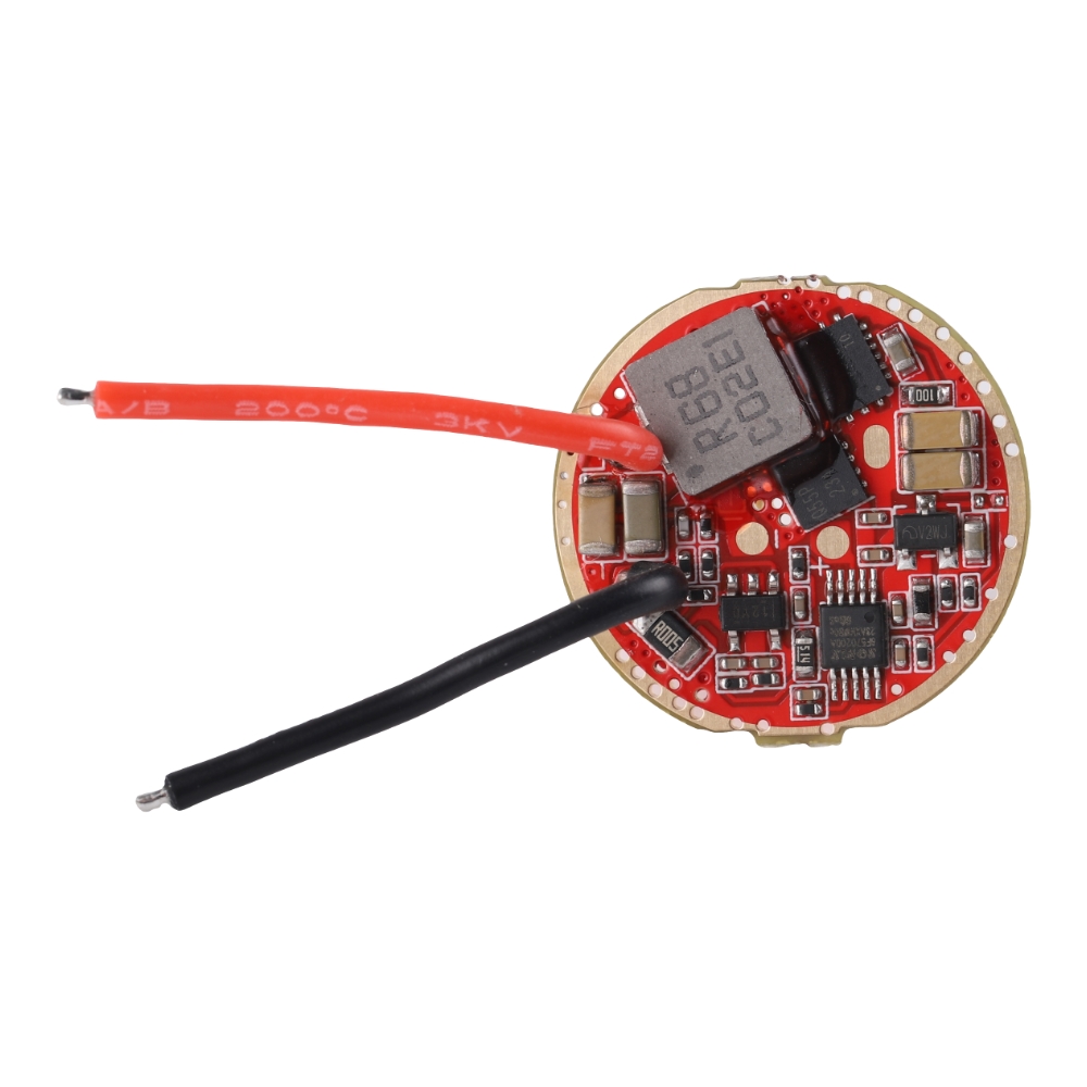

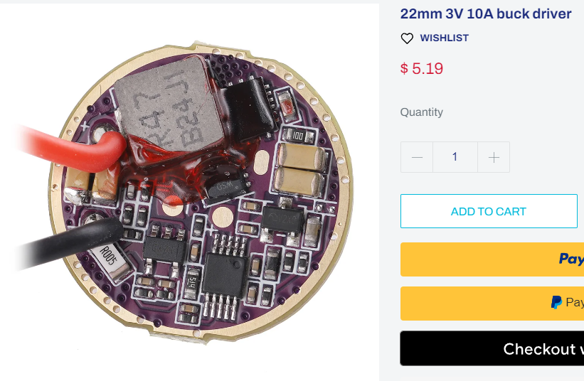

You’ve put a picture of 10A driver, which has different components (inductor and shunt took my attention).
And if we look at a 8A driver than we see components similar to your photo.

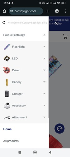

Hi, Simon. I’ve noticed that not all shop categories are shown on the mobile site. Could you please look into this?
Curiously, it sometimes will open with a different menu that has all the categories, but most of the time I don’t see this menu
Awesome, thank you for confirming. This is great news to already be owning one of their buck drivers, I just didn’t think the buck drivers were available in spring 2022 when I had ordered this.
Well, I didn’t give a confirmation. I just pointed out that you chose the wrong driver to compare :wink:

The red one is the 3v8a version and the purple one is the 3v10a version.
At present, the new version of the drive circuit uses springs.
