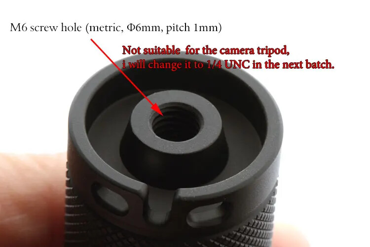

Would it be possible to request a similar S9 tailcap (with 1/4"-20 standard tripod thread) for S21E and similar models?
I would like this tailcap for modding and other purposes, for side-switch Convoy flashlights.
