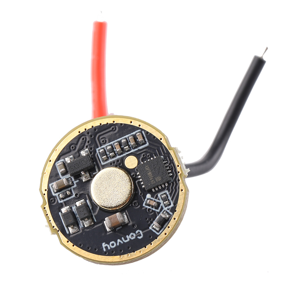

It’s possible that Simon hasn’t updated it yet as you can see the same thing in the T3 Ti/Cu specs but this review suggests that it may be a linear driver when using a 14500 battery.
That run time graph is dead flat. It’s not FET. Hope someone can take the driver out and look at the construction to see what type of driver it is for Li-Ion. Probably FET operating in linear mode?
There’s pictures of it, on his site:
2 inductors means it’s either a buck boost or 2 separate buck and boost on the same PCB.
8 Thanks
Yes that’s really good. Simon should update the product page to say boost for AA and buck for 14500 or boost/buck for 14500. This is a really nice product. Well done Simon. This thing is almost the same form factor as the Acebeam Tac AA but cheaper and has a better driver. Looking forward for a Sand or even better, a colorful one.

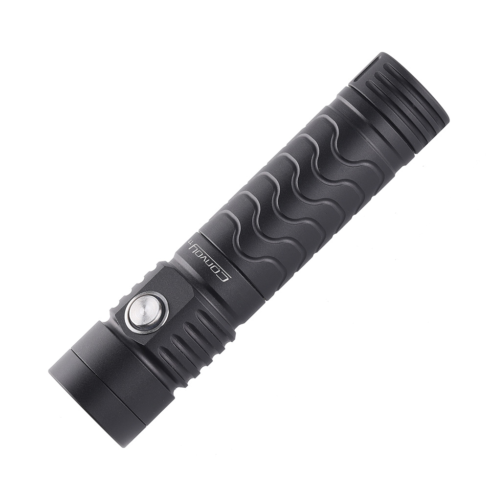

The new T7 is out (almost). I’ve been waiting for this light. I see it has the lower spec 1.5 amp driver compared to the T3’s available 5 amp driver.
6 Thanks
Nice to see 14500 flashlight with USB-C :+1:
It would be nice to get a real moonlight mode on the T7 and it’s curiously missing a clip etc. But it does look rather interesting.
The T7 is interesting given the low price and USB-C charging on AA/14500, which is rarely seen. I would like to see a more balanced default optic (probably a reflector), a pocket clip, and a proper moonlight mode.
