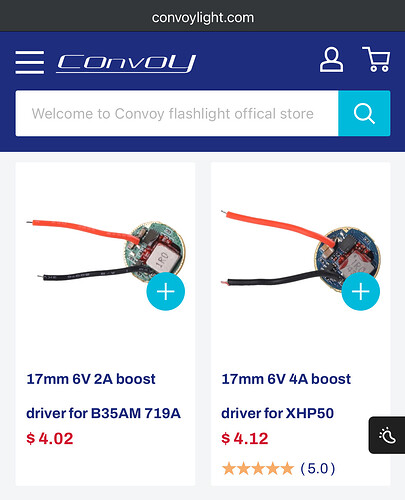

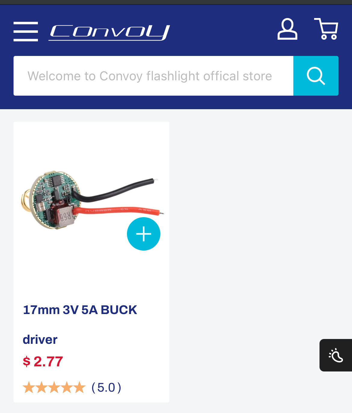

Look at the pictures on his website and compare the PCB Color and the components on the PCB:
I looked closer and one has B35AM and the 3V buck is labelled, so by power of elimination I can figure the others out! :sweat_smile:

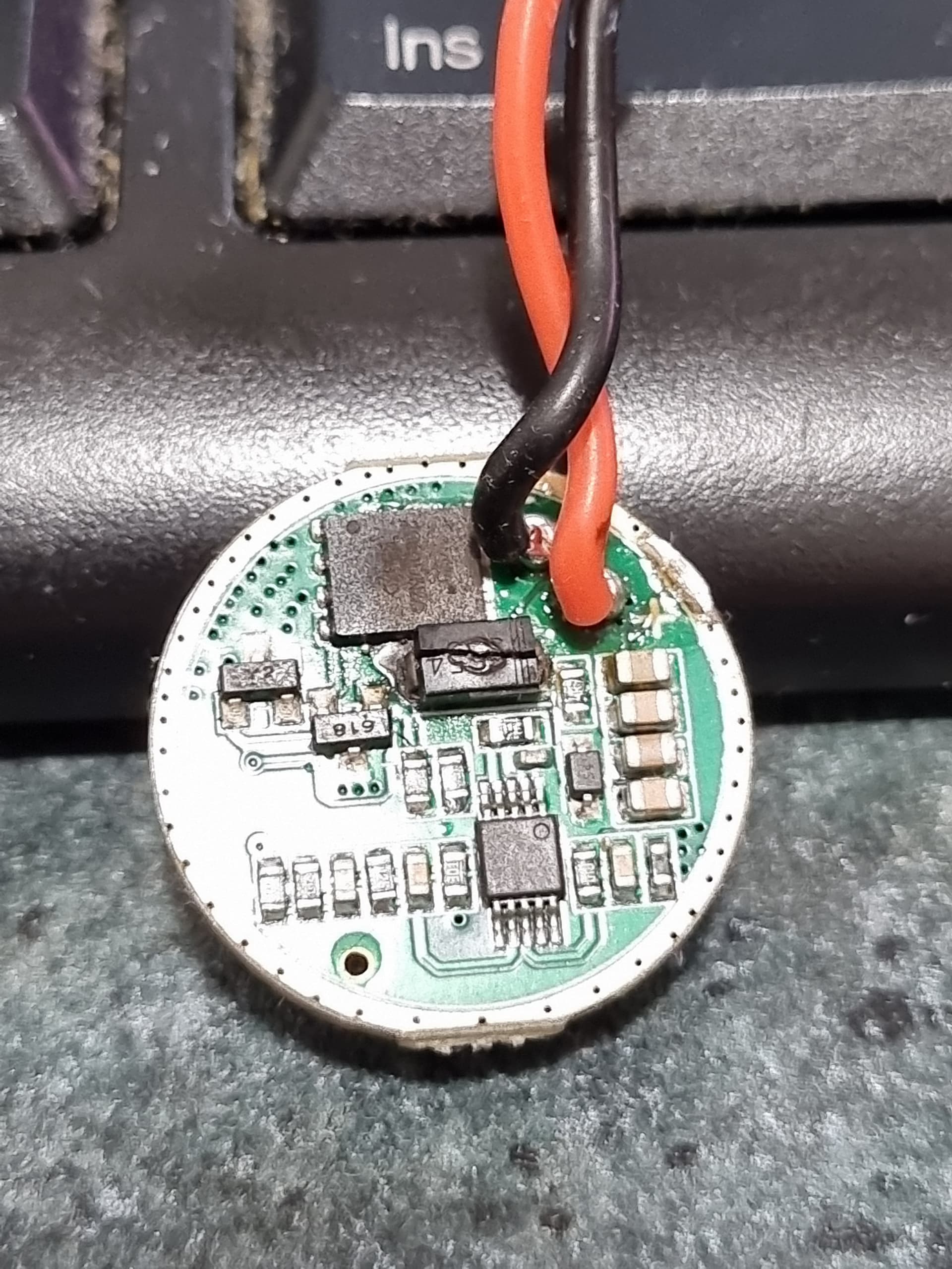

Just had my 6th L21B SBT90.2 driver fail, same component every time. Another member reported the same component failing on theirs. Kind of losing faith in Convoy’s reliability.
It is 5A 40V Schottky Diode. Have no idea what is for . Anyway, it is 2$ driver right :wink:
Yeah, but not a good look as a flashlight retailer and having multiples fail.
Others have mentioned it’s for reverse polarity protection, so no clue why it’s failing.
It does not look like RPP. Anyway, 5A input diode is not enough for 12A output
The SBT90 is drawing 22A. Would be interesting to know what it’s for.
Based on placement (I’ve looked at this driver before) it seems to be freewheeling - my guess is the inductance of the wires at the output, together with the fast high current PWM, generates sufficient voltage spikes that it needs some sort of freewheeling. Sounds weird to me, but the fact that it explodes seems to agree with the fact that it’s needed (and in fact even undersized).
I will get one of these drivers today, and can try to figure out what it does and why.
I wonder if thicker wires from driver ro MCPCB would keep this from happening.
Have you tried simply removing this diode, not adding anything in its place, and seeing if it still works? I’d be curious about that. It would probably fry the FET then, though, or - worst case - the LED.
Edit: yup looks like it’s placed to protect the LED from reverse voltage, not the FET. Better not try without unless you’re fine with risking a SBT90.2 then.
