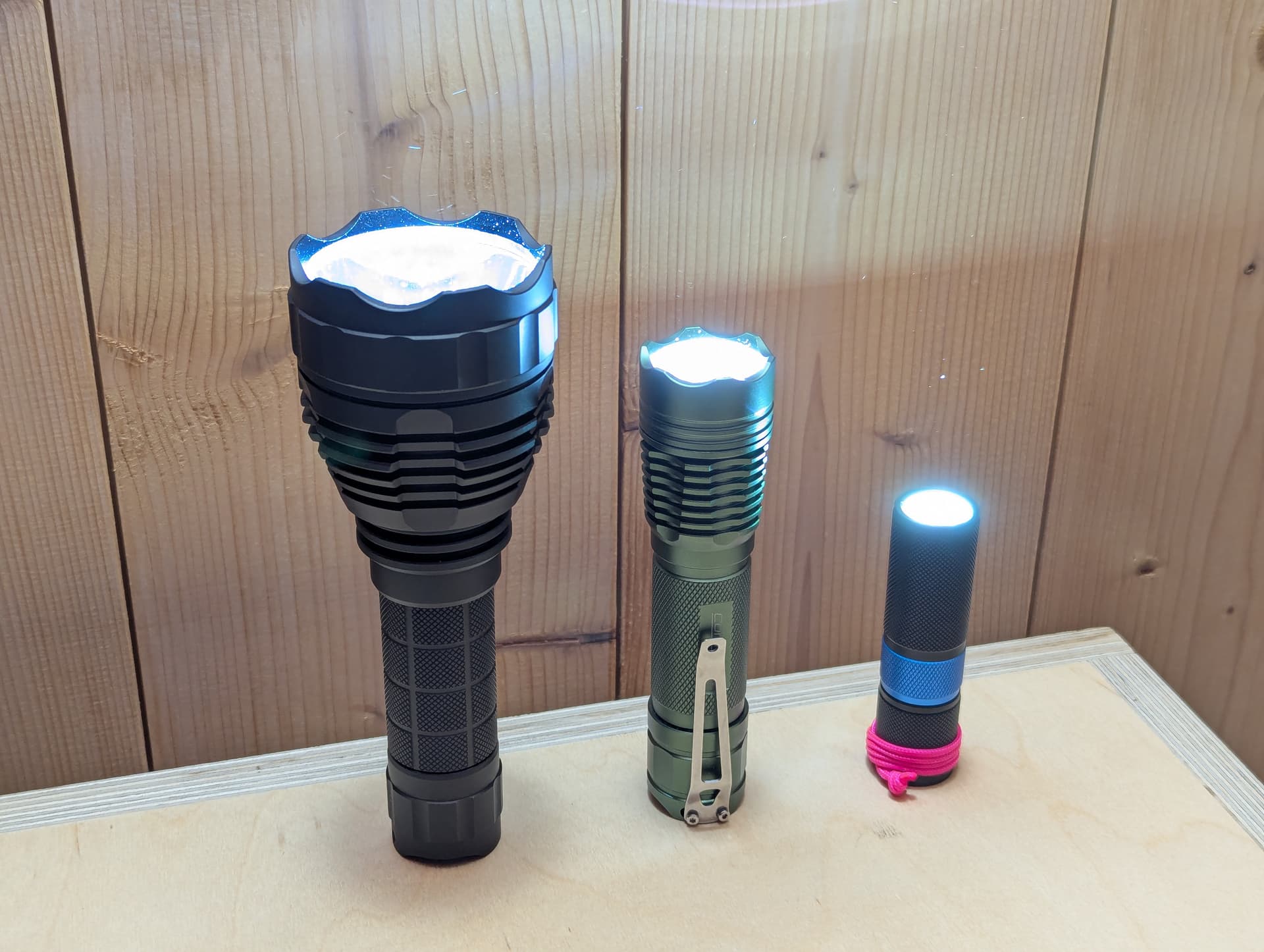

Three throwers.
L21A with SFT-90 6700K, Ampace JP40, FET driver
M21B with SFT-40 5000K, Samsung 50S, 5A Buck
S6 with SFT-25R 5000K, Vapcell M11 II, 5A Buck
