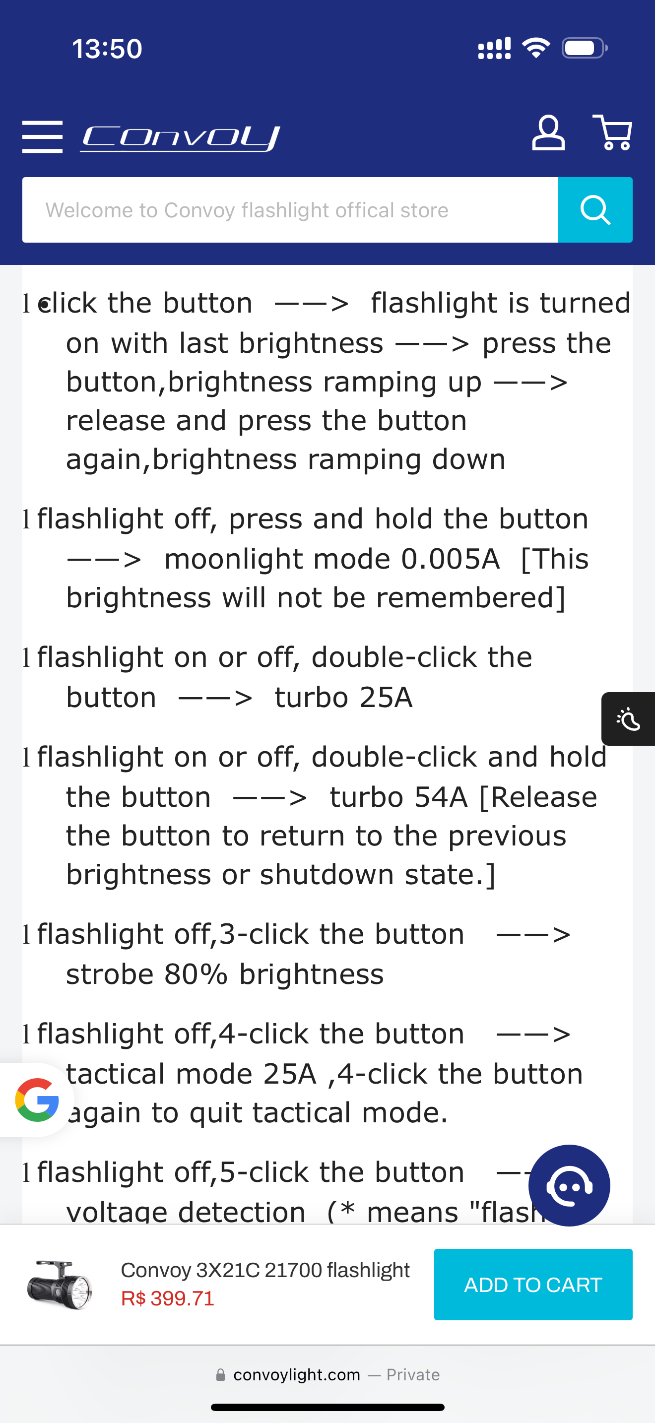

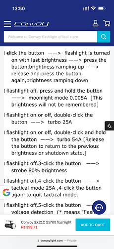

So. Simon just posted how the new driver works. Answering my question.
So as I understood, turbo is only momentary. There’s no way to leave it on. Not so sure how I feel about this. At least we can know for sure that the full buck driver is being used.
Ahh very nice! I didn’t expect the metal to have enough give to make lifting possible.
That actually sounds quite nice. I’d be curious to see how moonlight performs with this, and have no need for FET, since I fear burning out the emitters. This might get me to pick up a new light.
You almost scared me by cutting the image a bit, but apparently there’s still also a stepped mode with 0.6A - 1.5A - 7.5A - 25A. So we have 4 stepped modes plus a separate moonlight and separate turbo. Not sure if it’s still possible to jump from moonlight to low, but other than that I have to say it’s looking pretty good indeed.

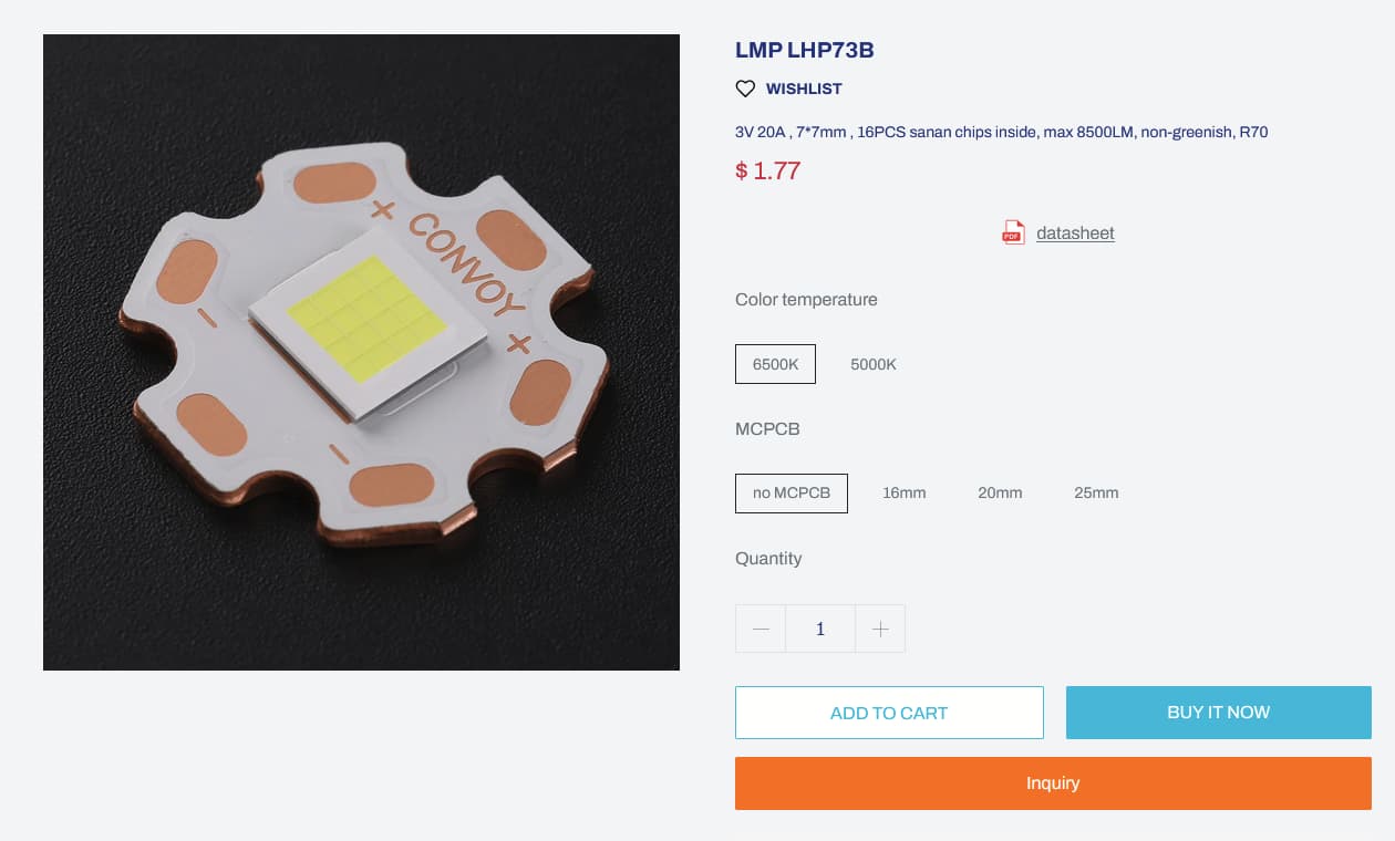

Just noticed the LHP73B can be configured into 6V emitter, would it be better with Simon 6V 8A boost driver?
@Simon_Mao , do you happen to have plans on stocking the “12V” mcpcb to pair LHP7-3B with 6V drivers?

lhp73b is a 3V LED
Sorry, I don’t have such plans at the moment.
Mc PCB does not fit.

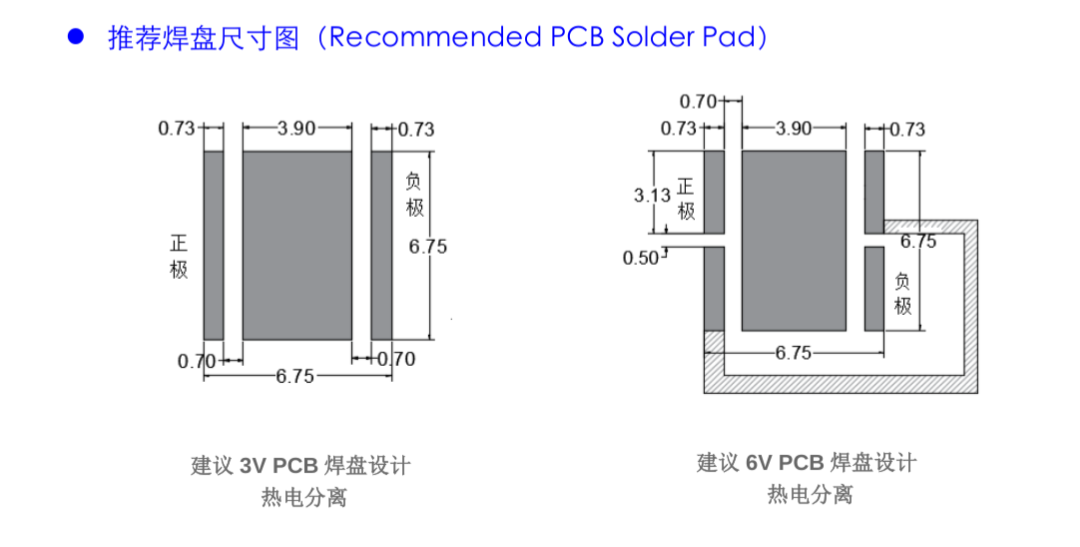

Can be both. A PCB that makes a 70.2/70.3 12V would make a LHP73B 6V.
I would be interested in LHP73B in 6V config as well. Sounds like a very efficient floody LED for max sustained brightness in a boost host.

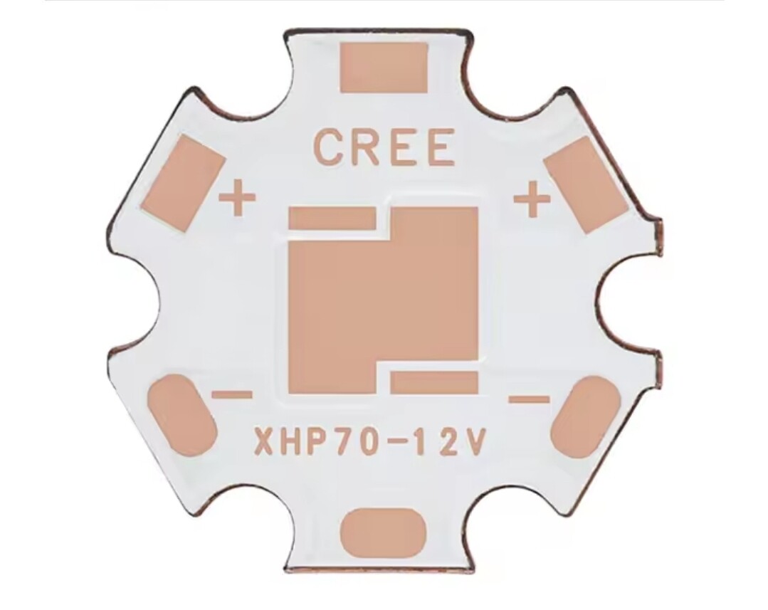

Here’s an example of mcpcb for 6V connection scheme shown by ebastler.
But I wonder what are the constraints for usage of such pcb… Isn’t thermal pad (and first cathode - second anode) connected to the main copper mass of the board and therefore to the body of flashlight given that shelf/pill isn’t anodized?
When the connectors are arranged like that the center pad is electrically active. Not good for a DTP board.

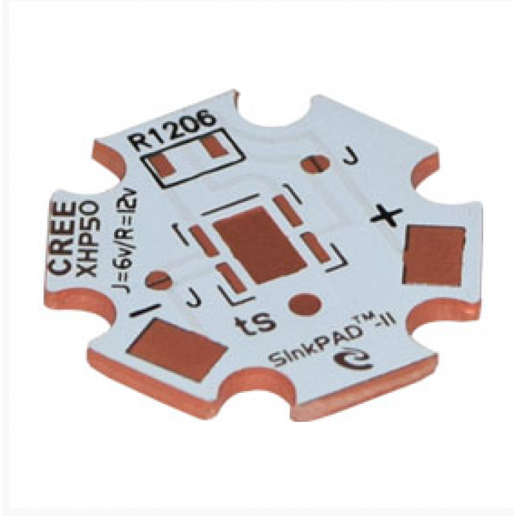

This type does not have that problem, the center pad is isolated, although these sinkpad MCPCBs are not suitable for high current:

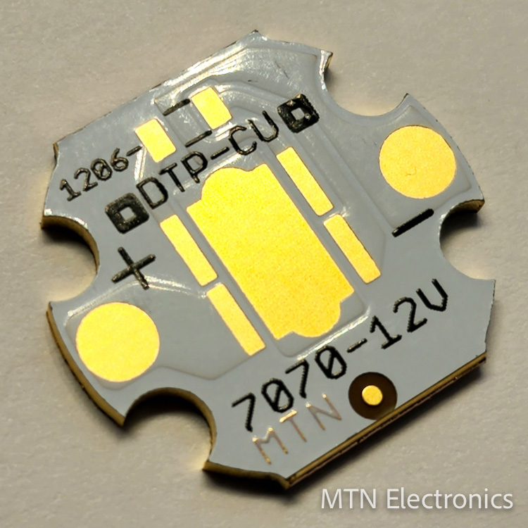

MTN has one that looks a little better. The main issue of those is them trying to make them 6V and 12V (XHP70) or 3V and 6V (LHP73B) capable. With a 12V (XHP) or 6V (LHP) only config the traces could be a whole lot thicker.
Simon could order a batch of them. Would be great to have an option designed for high current. Still worse than a purely 3/6 V one ofc, but at least better than those multi voltage boards.
This one? I don’t think it’s all that much better, the - trace gets really thin.
Maybe air wires could be a solution?
