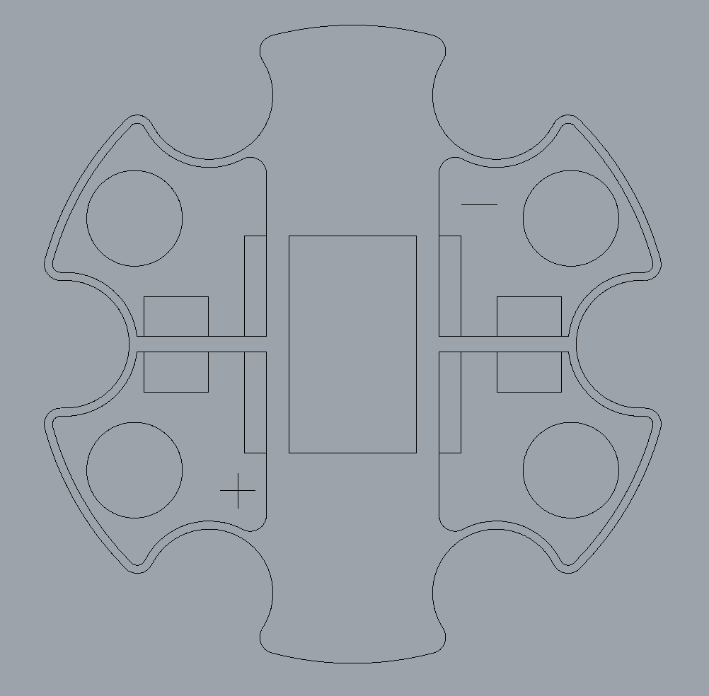

Ooh wait the negative trace is ridiculously tiny on this one :sweat_smile: He kept the trace between the pads thicker, but at the cost of the negative wire.
I’ll try to come up with something in kicad when I have time.
Might be difficult on 16mm stars.
Something like this?, yeah the traces are thin but can just add wires like you said
found it on Lumistrips site
I would not trust this tiny trace, same issue as the others. However, here you can just solder a wire between the two (top right, bottom left) pads for a low resistance path.
For 6V config, a wire could be looped around from the diagonal traces. For 3V, all four pads could be connected, or jumpers used.
20mm:
16mm:
Yes, this is probably the best choice, but I doubt Simon would want to use something with an air wire that needs hand soldering in production… So at best it’d be an option for us as hobbyists.
And ‘air wiring’ does not look clean.
