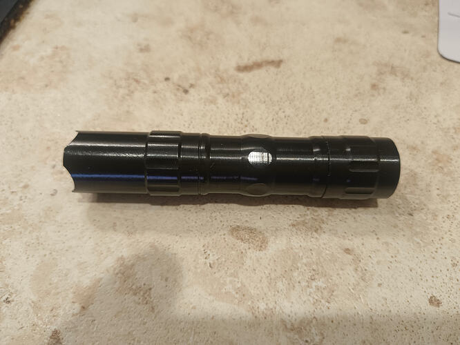

As promised!
This is the tube of the host:

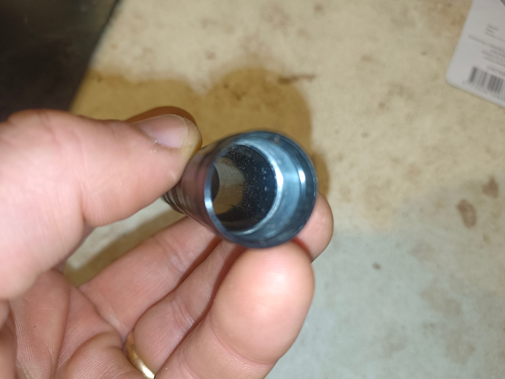

Head side:

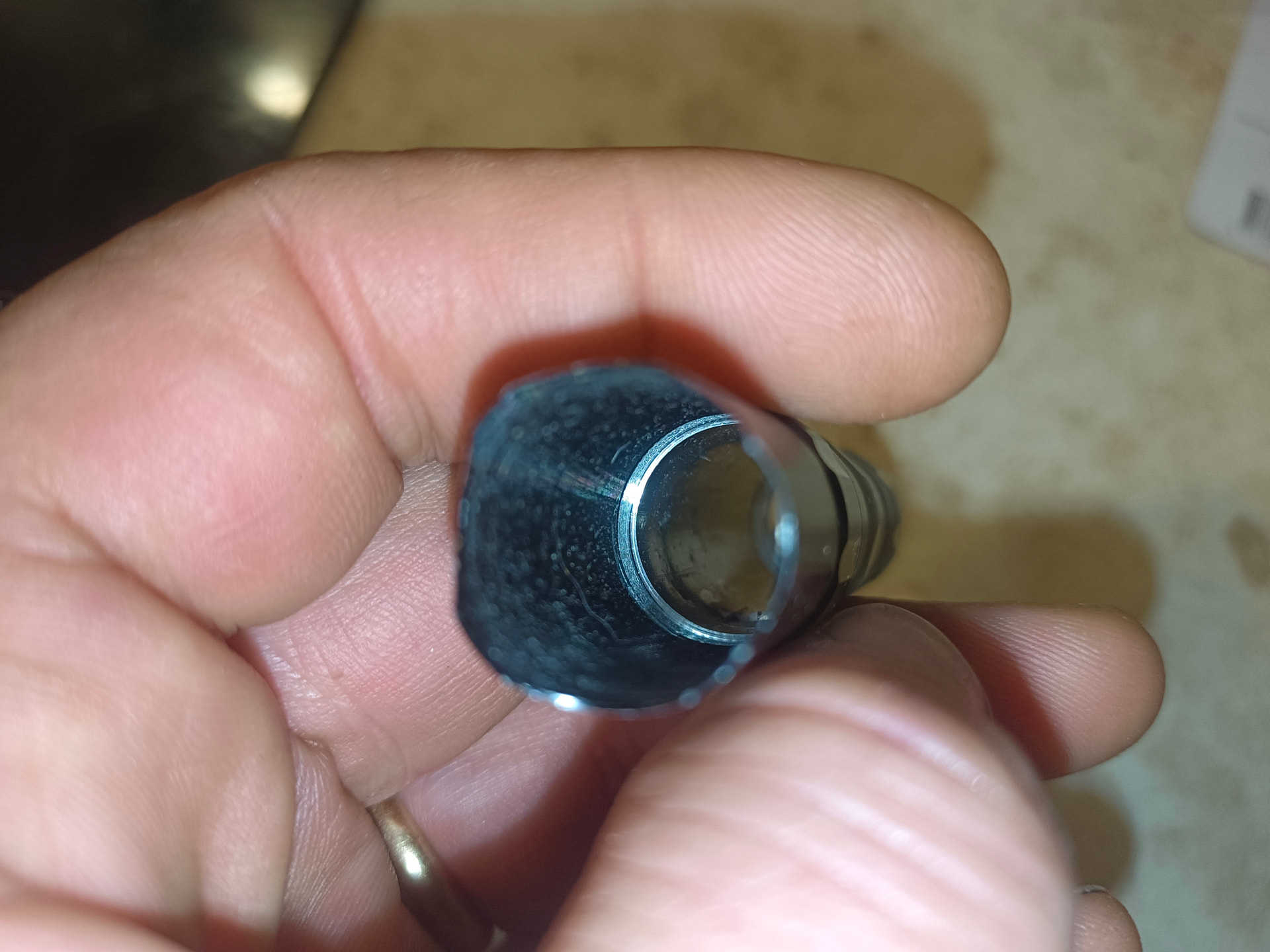

Tail side:

Thanks for the pics. I think it’s going to be a longshot for anyone to give you specific help without them having the pieces in-hand. Generally, you will need to make electrical contact where it should be, avoid it where it shouldn’t be, and ensure everything is secure.
Like I said, it can be very challening to fit components into hosts that aren’t made for them (I’m struggling with that on a few of my build ideas right now). Good luck!

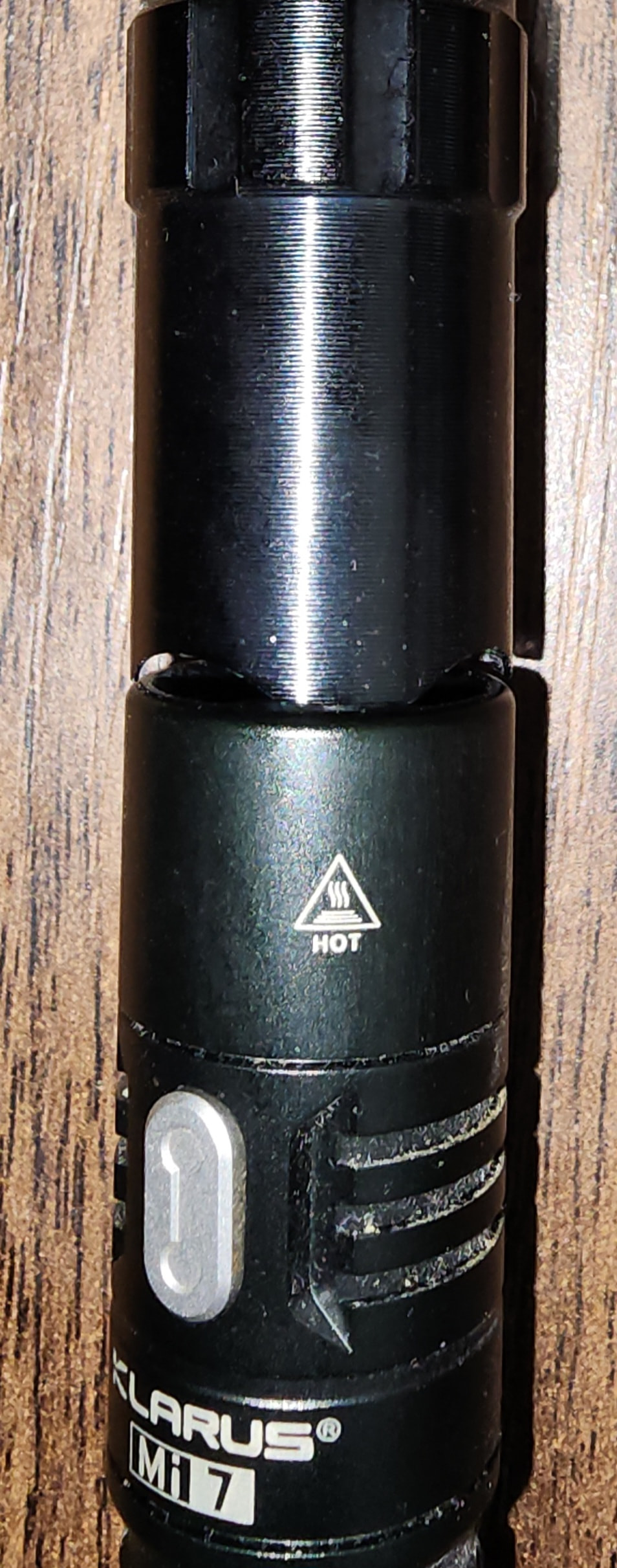

Here it is compared to a KR1AA and. Klarus Mi7
Please excuse the grime, it has been sitting in the corner of an old forgotten bookshelf.
Thanks for this, puts things into perspective!
