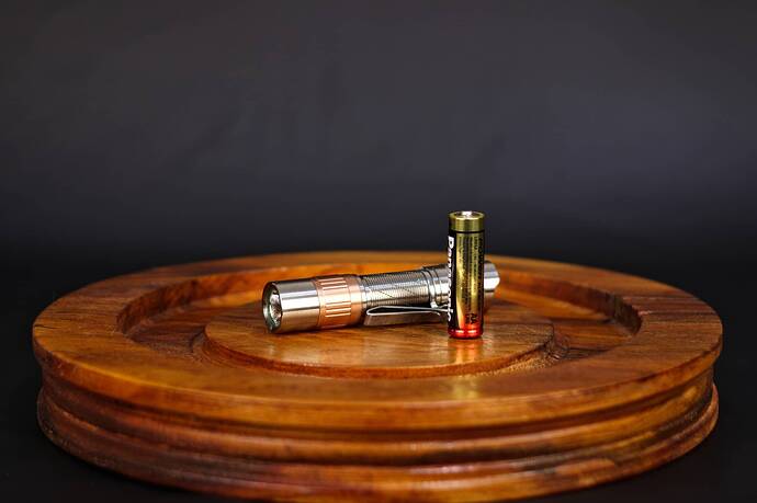

This is the Convoy T3 Titanium-Copper flashlight. It’s powered by a single 14500 or AA battery, has the high CRI 519A LED in 3500K, Buck/Boost driver, dual fuel feature and more!
• My opinion:

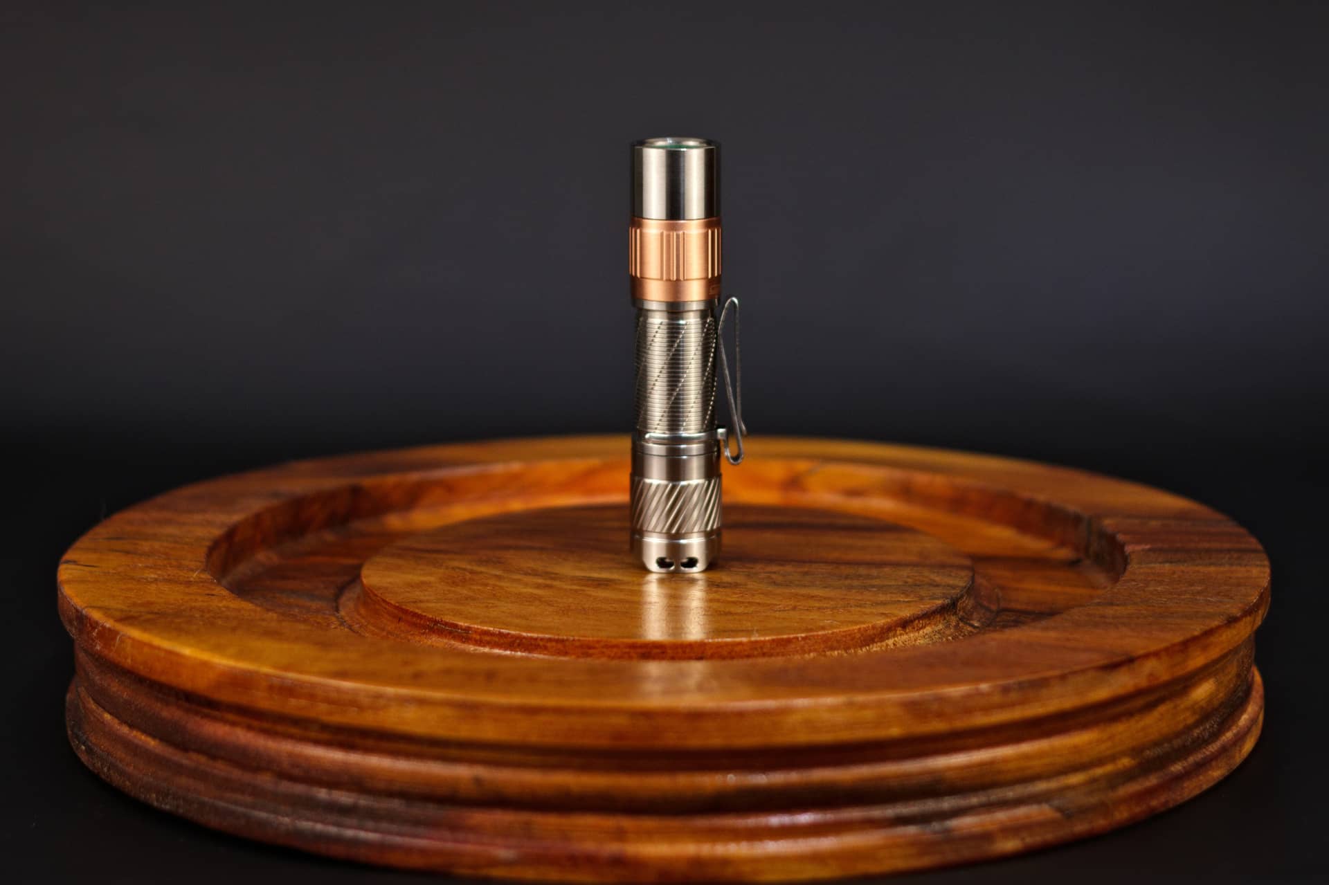

The T3 TiCu is an amazing flashlight, it does not need fancy UI to be pretty good. It’s a simple flashlight that gets a lot of features right. The Titanium-Copper combo makes the main body feel very heavy and premium, it could have a mirror polish to look even better, but the standard finish is already pretty good.
The drivers and components are high quality as all Convoy flashlights! The 519A has pretty high CRI 90 and 80 R9, and beautiful neutral tint, It’s awesome! The flashlight accepts almost all types of 14500 and AAs I tested, so don’t worry about having fuel for this little guy. I really don’t have much to dislike on this light, the moonlight problem is the main one, a better moonlight would make this flashlight way more versatile.

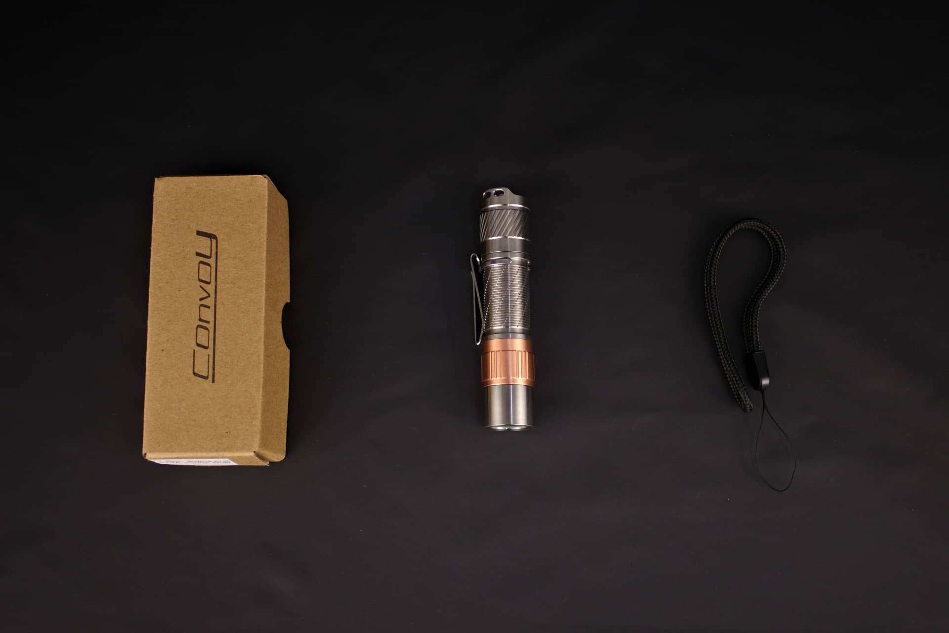

• Box contents
- T3 TiCu
- Lanyard

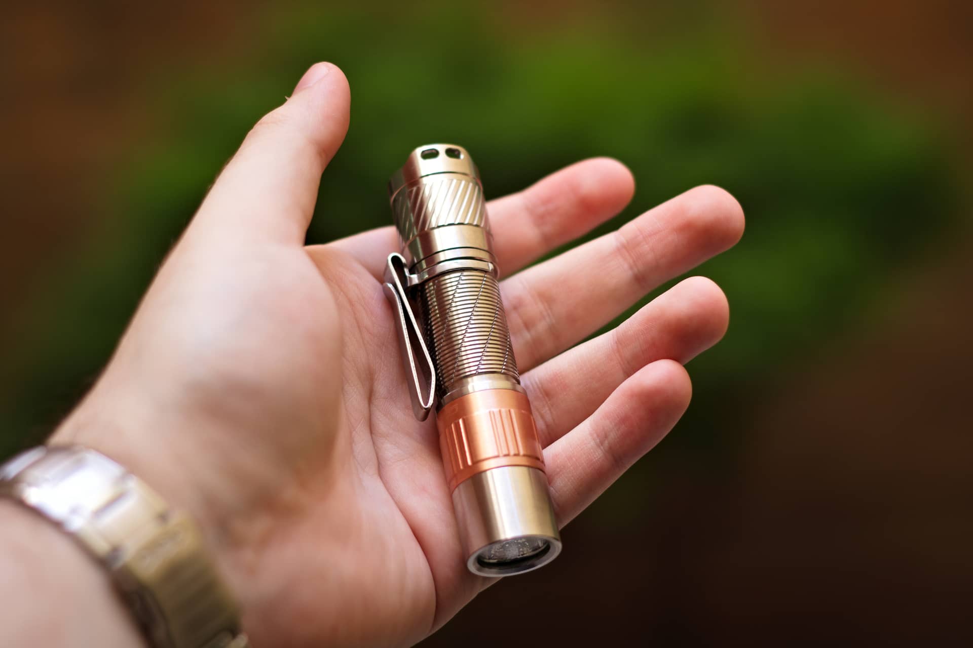

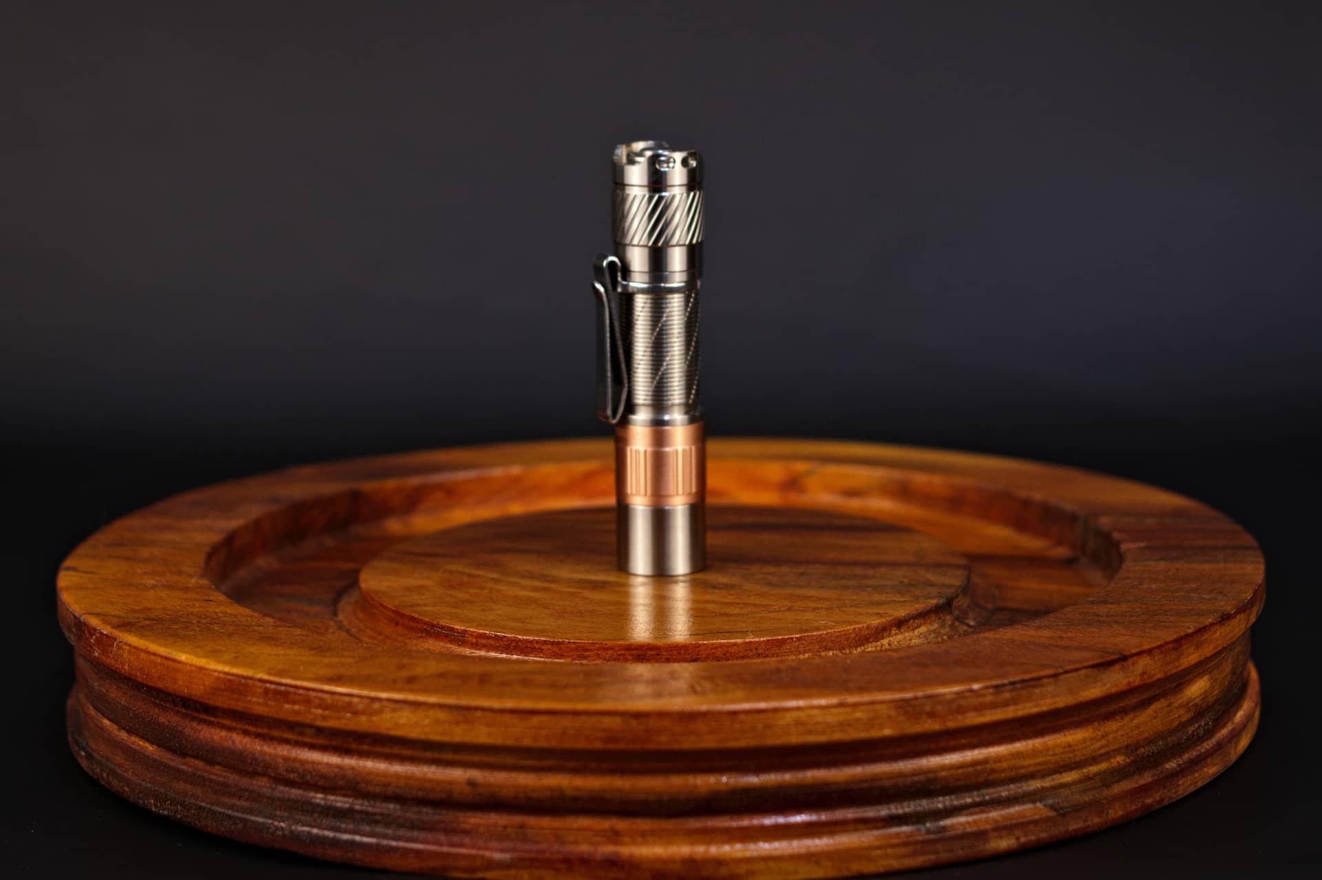

Colors/Material Options: The T3 is available in aluminum with a ton of anodizing colors like Cyan, Blue, Green, Pink, MAO… It’s also available in Titanium (polished and stonewash), Copper, Brass and Titanium-Copper (Seen on this review)

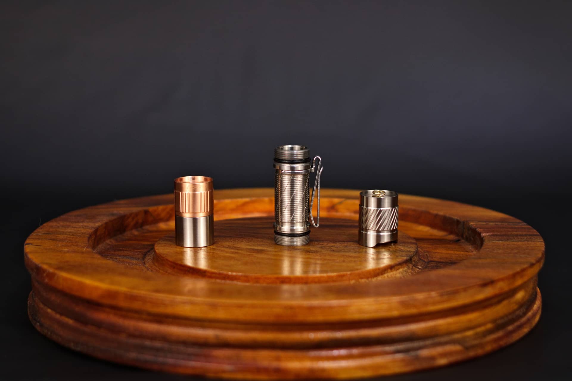

Main body/Grip: The main body is full of knurling, so even though the Titanium is polished and smooth the grip is still pretty good. The flashlight is pretty compact. The main body feels very smooth, while the threads are a little gritty - as usual with titanium.

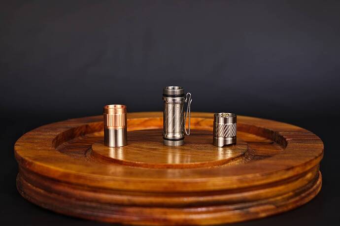

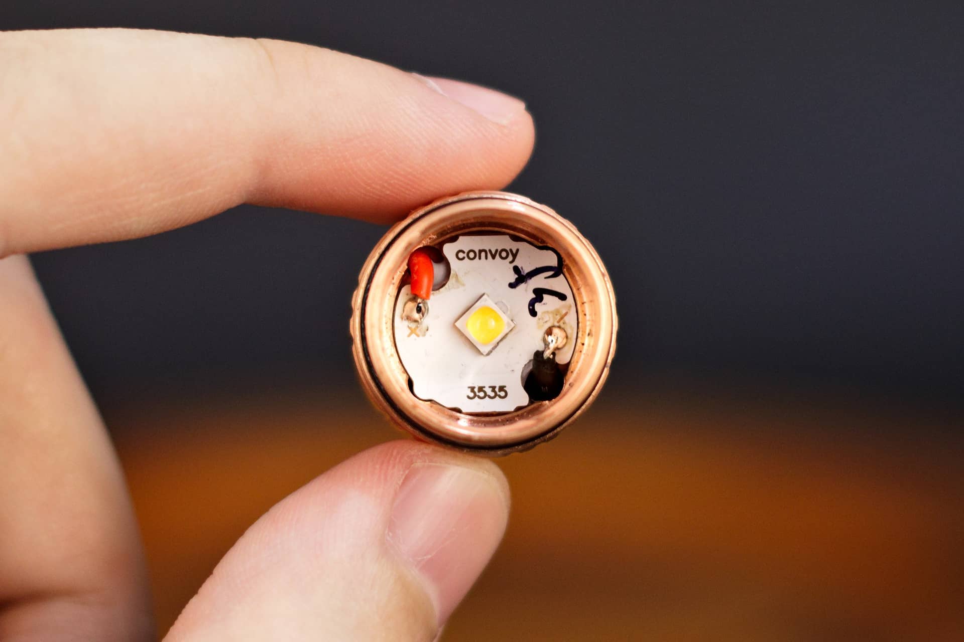

Material: The main body is almost entirely made of Titanium, the bezel, battery tube, tail cap and button are Ti; the driver/LED tube is made of pure Copper for better heat transfer - and looks.

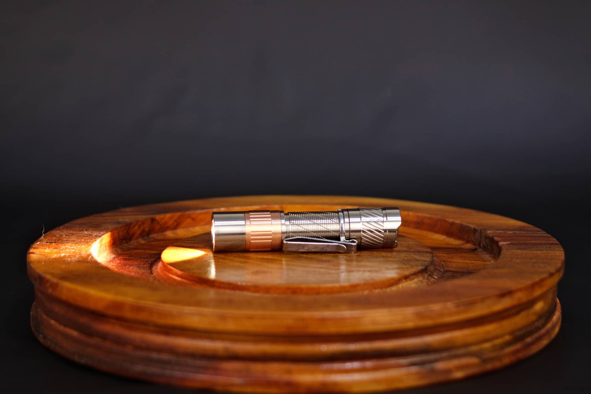

Tail stand and rolling: Without the clip the flashlight does roll and can fall from edges, the clip prevents it from rolling though. The flashlight can tail/head stand with stability. The metal button does not impact on tail standing.

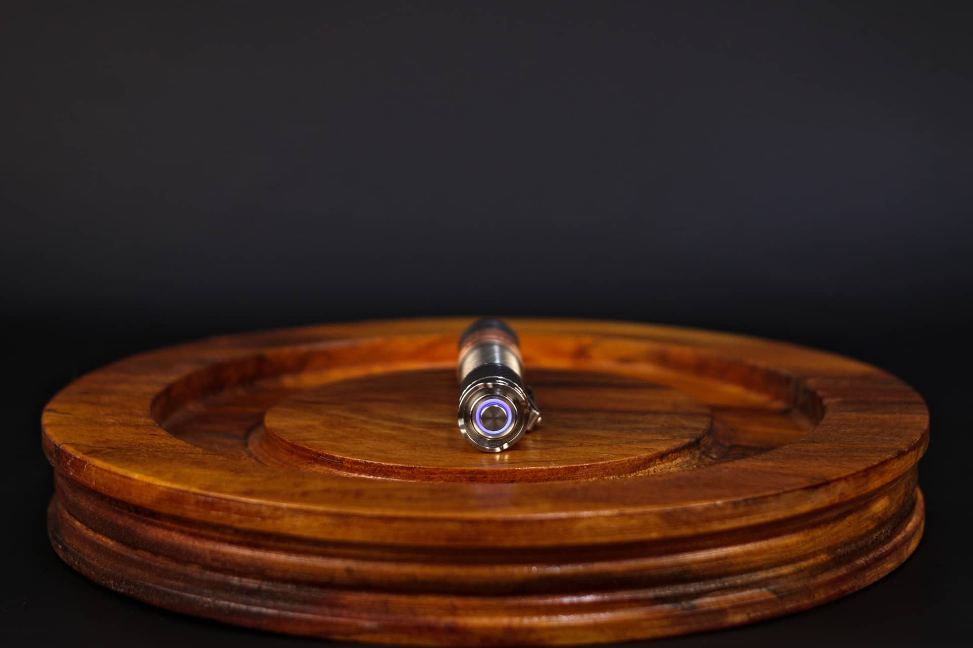

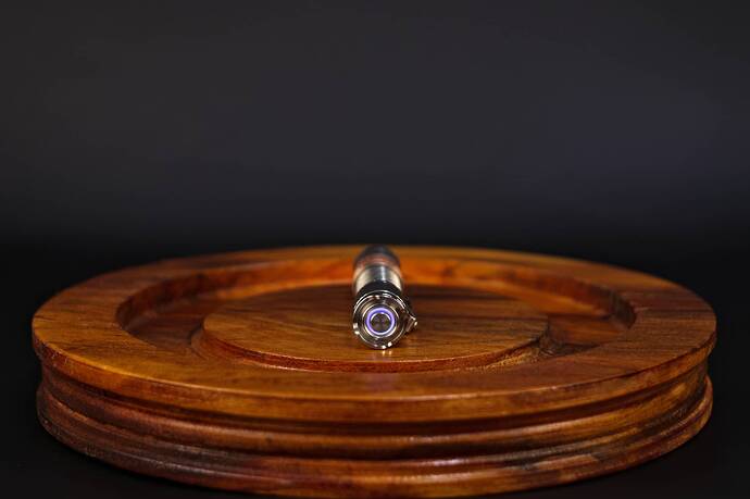

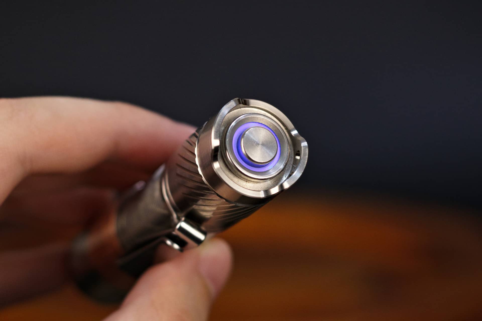

AUX lights: The T3 doesn’t have any AUX light by default, it has a Glow In The Dark O-ring on the lens, so it does work a little like an AUX, but no LEDs. Switches with LEDs are available on the Convoy website, they serve as locator LEDs and stay ON while the flashlight is OFF to help find it in the dark, when the flashlight is turned ON the switches LEDs turn OFF. The T3 comes with a Glow in the dark O-ring on the glass lens, a very cool and simple thing to help you find the flashlight in the dark.
*The Switch with LED is sold separately on Convoy Website

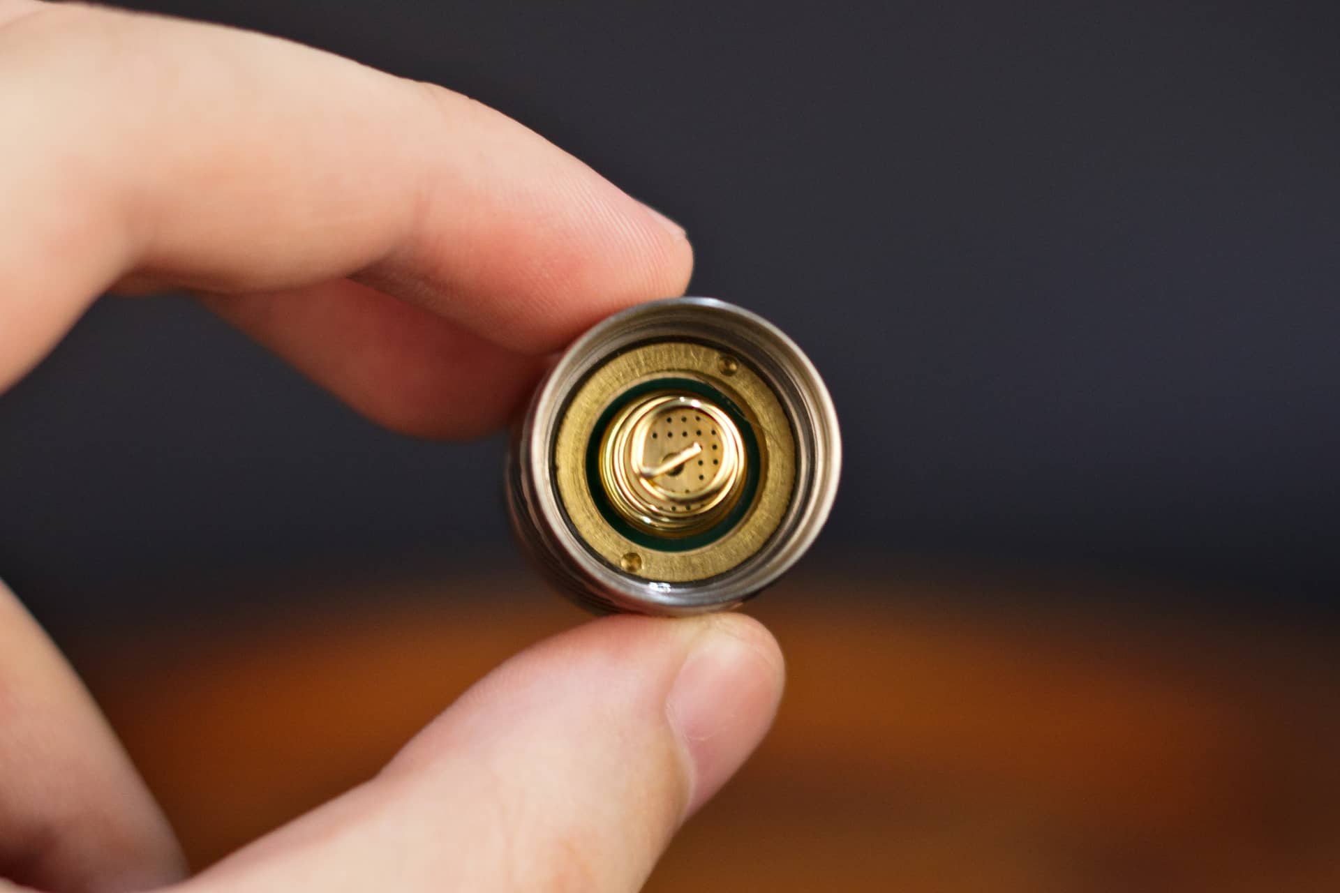

Battery contact: Contact is made with the battery by two Gold plated Phosphor-Bronze springs, one at the driver, the other on the tail cap button.

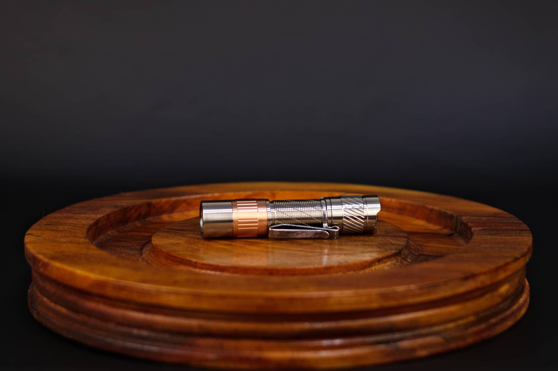

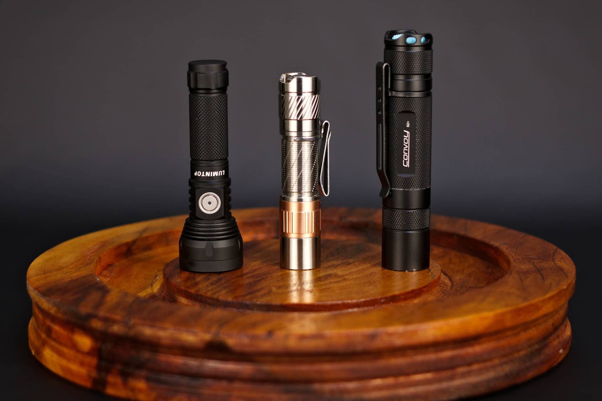

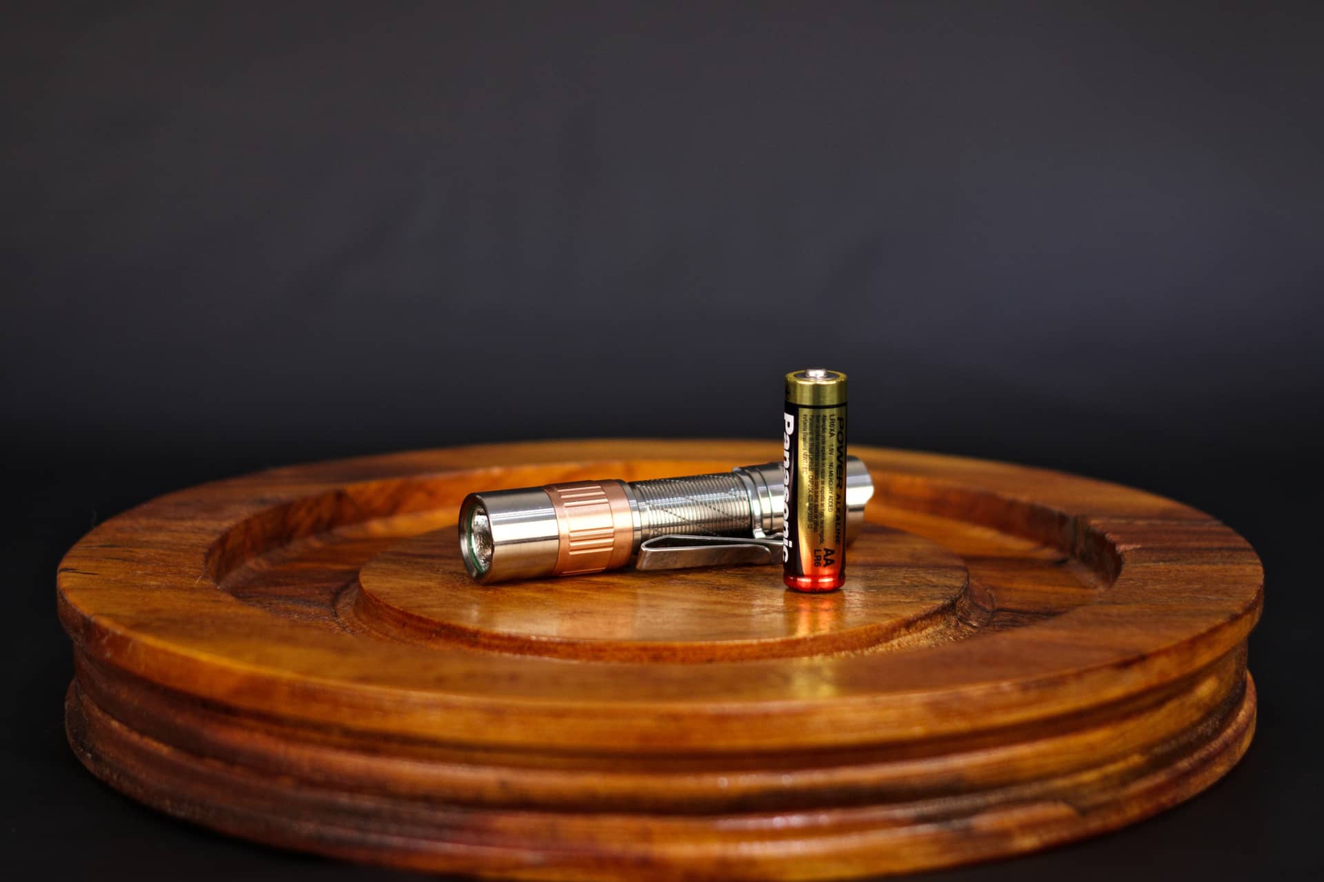

Size comparison: On the left is the Lumintop GT Nano Plus (14500), on the middle the Convoy T3 TiCu, on the right the Convoy S2+.

Battery: The T3 uses a single 14500 or AA battery to power the driver and LED. The T3 accepts both button top and flat top cells, as well as protected with USB-C batteries, so you have a lot of fuel possibilities to power this little guy.

Emitter: This T3 has the Nichia 519A emitter in 3500K. This LED is fantastic and very well known on the flashlight community. Tint is pretty neutral warm white, no green or rosy tint by default. The beam color is very clean and High CRI, while still being pretty powerful.

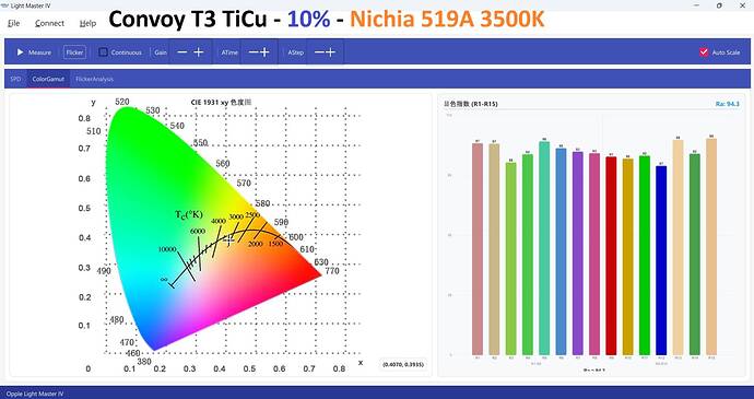

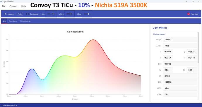

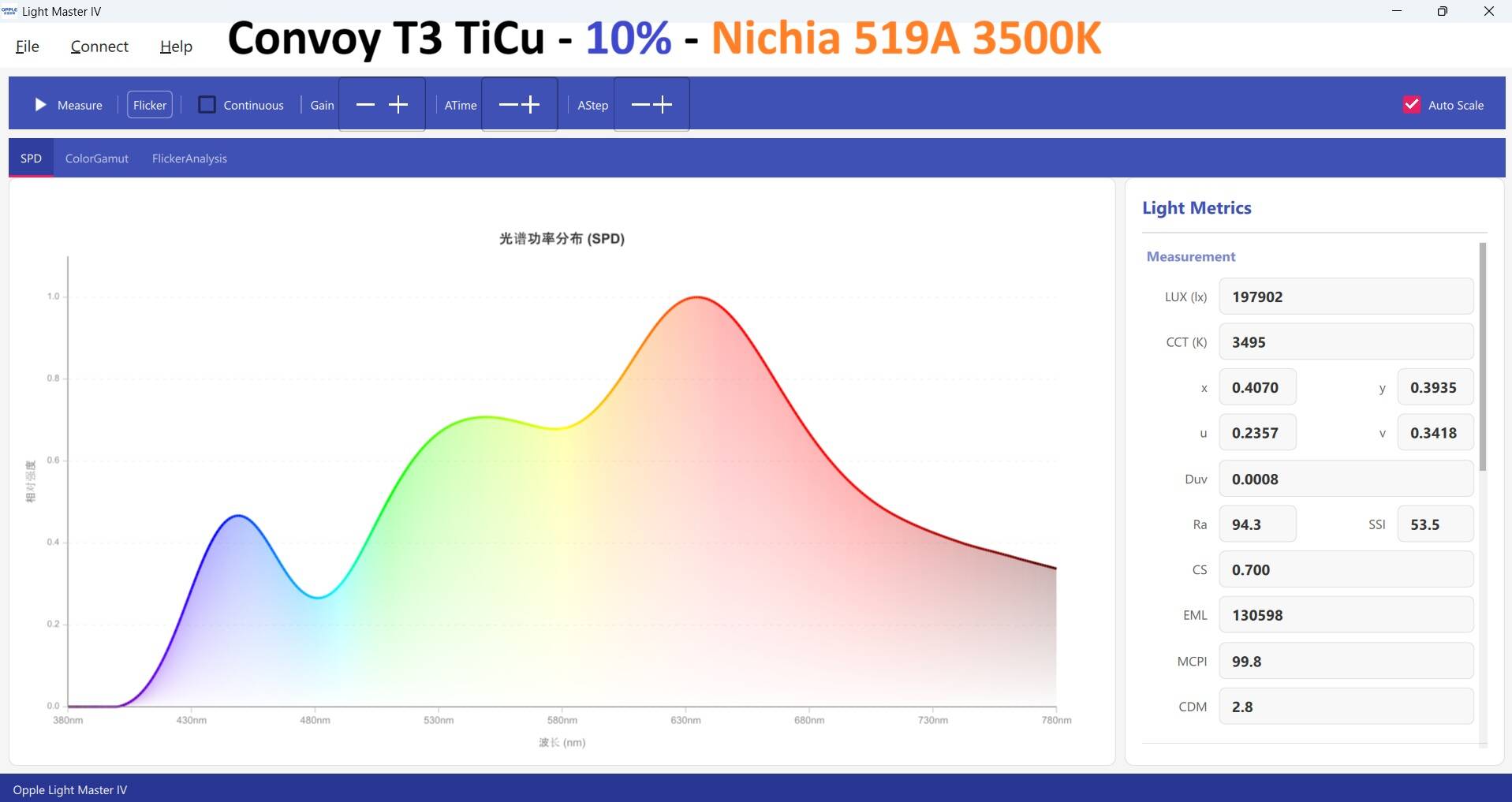

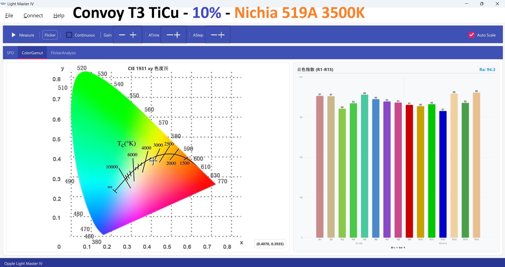

CRI/CCT/Duv: The 519A LED has amazing CRI, one of the best emitters for color fidelity with advertised 90 CRI and 80 R9, but I actually got even better readings on the Opple LM4, 94 CRI and 91 R9 and 0.0008 Duv! Pretty good readings. The 519A combines a good efficiency with tint and amazing CRI with a pretty neutral tint.
*CRI/CCT/Duv: Opple Lightmaster 4 was used to get these readings, it’s not a professional spectrometer, so use this readings as a reference only. This test was performed in a dark environment without any light sources besides the tested LED.

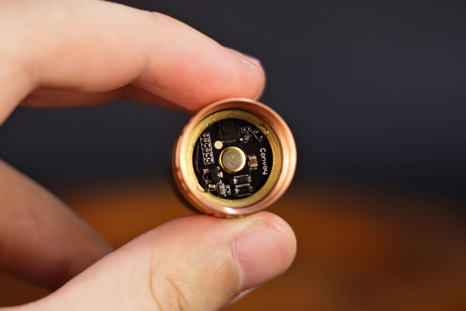

Driver: This T3 has a 5A Buck driver for Lithium-ion batteries, and a Boost driver for the AAs, Convoy claims around 95% efficiency for the Buck drivers. Convoy drivers are usually pretty efficient and use high quality components, so I trust this driver, especially after testing a lot of Convoy flashlights, but I think it should have a dimmer 1% - or even 0.1% - mode to make this light even more useful.

Question: can the blue locator switch work with a 1.5V battery?
Same here.
I almost never watch video reviews. :slightly_smiling_face:
Thank you!
The blue switch, sadly, does not work with 1.5V batteries
