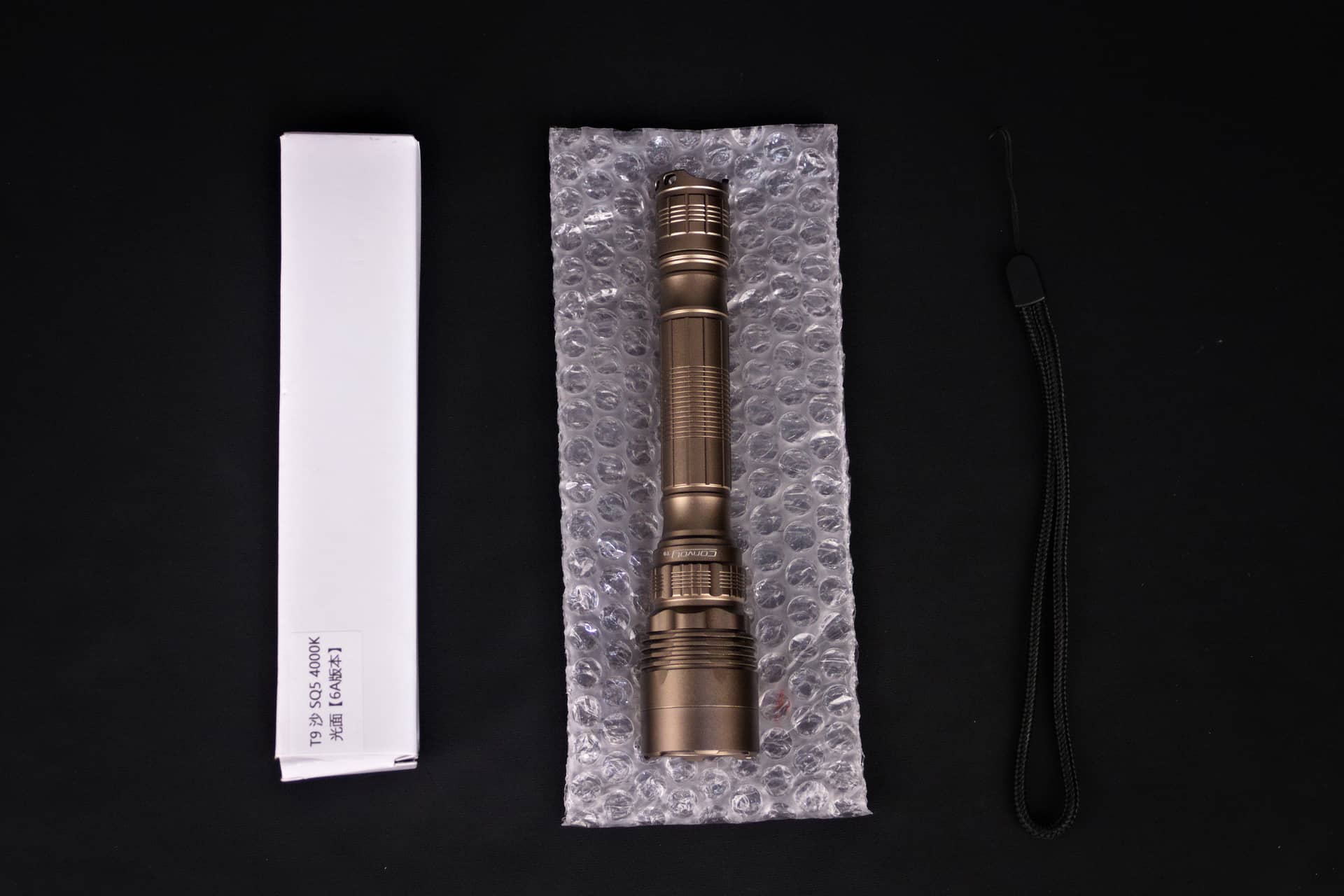

- T9
- Lanyard

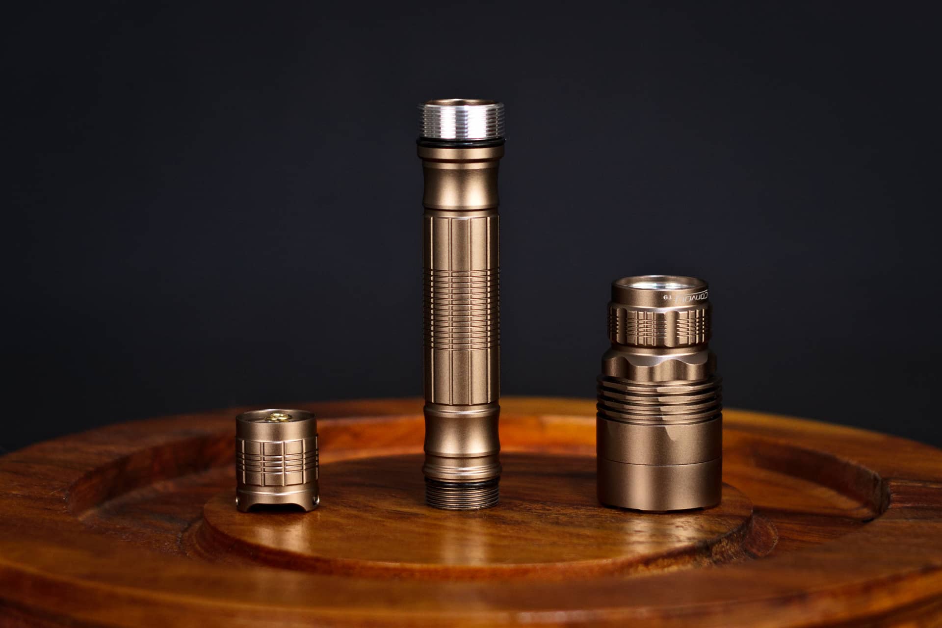

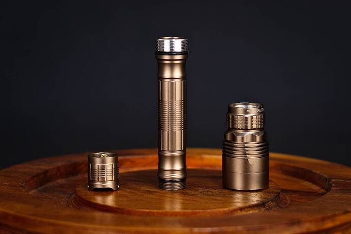

• Body and build quality
Packaging: This flashlight comes in a pretty simple cardboard box, the flashlight and Lanyard are wrapped inside with bubble wrap.
Anodizing Colors/Material Options: The T9 is currently only available in Aluminum alloy with 4 anodozing colors: Black, Tan (featured on this review), Dark Green and Orange.

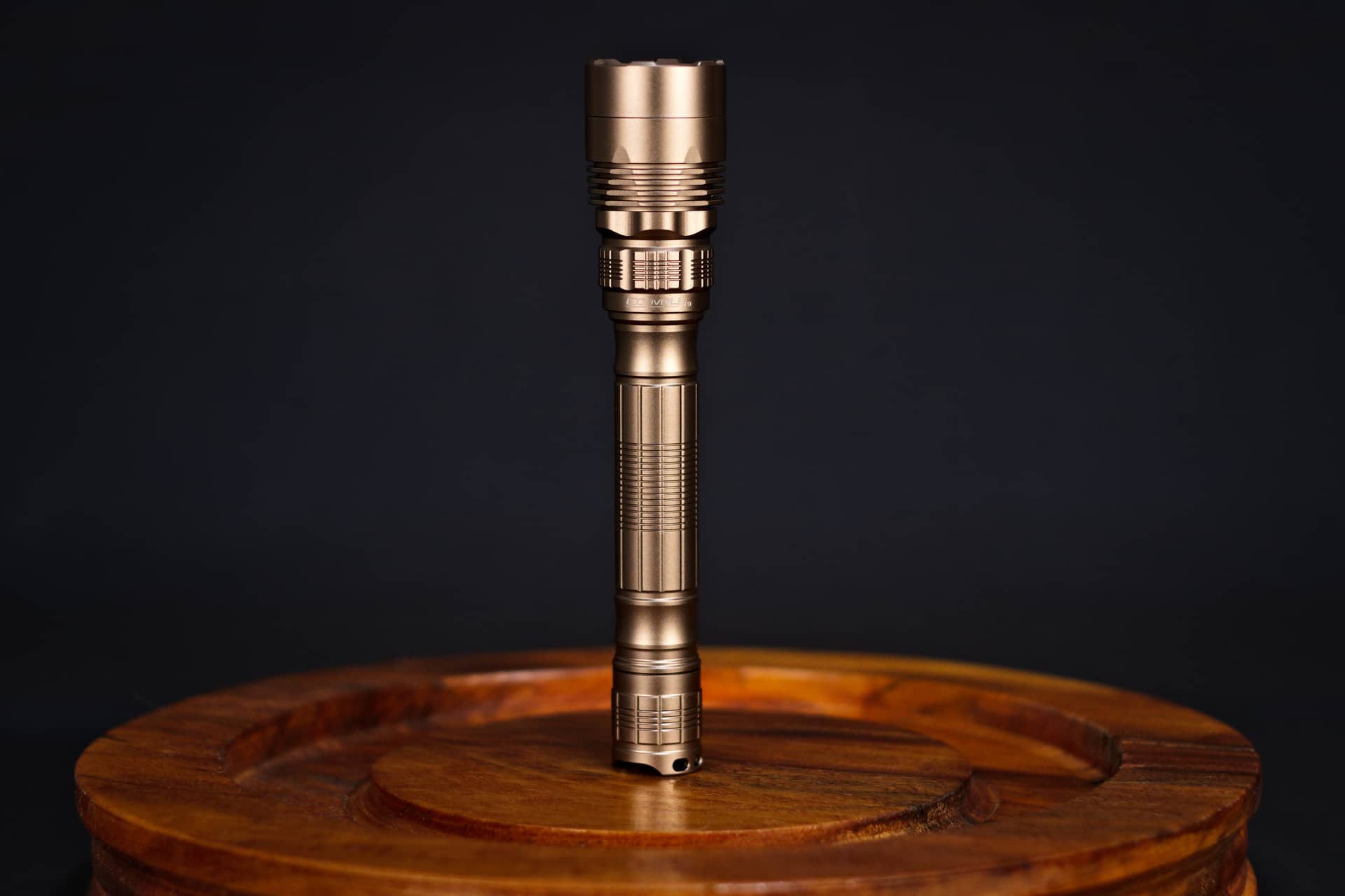

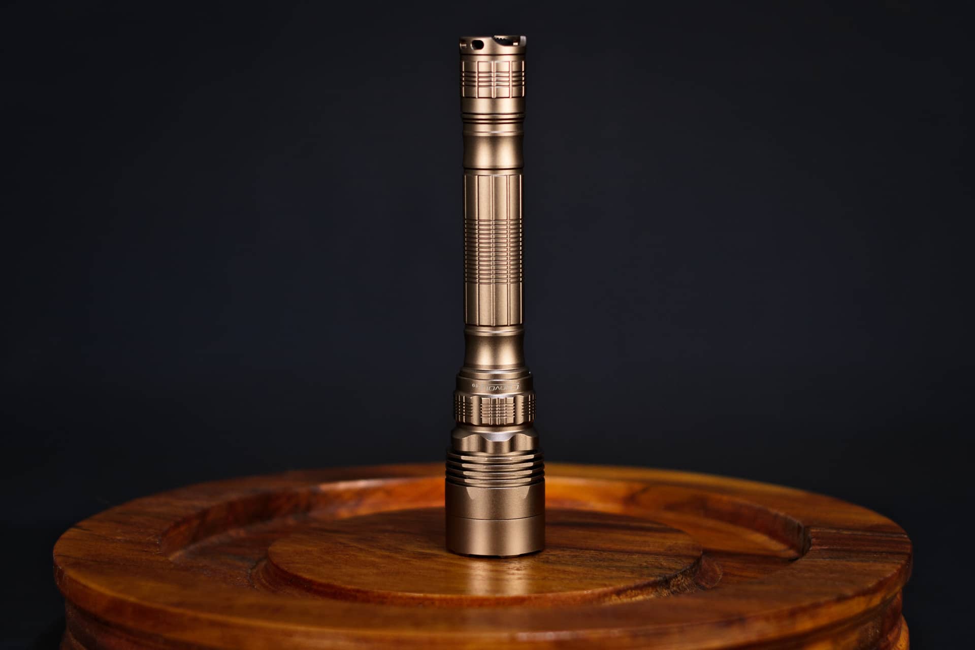

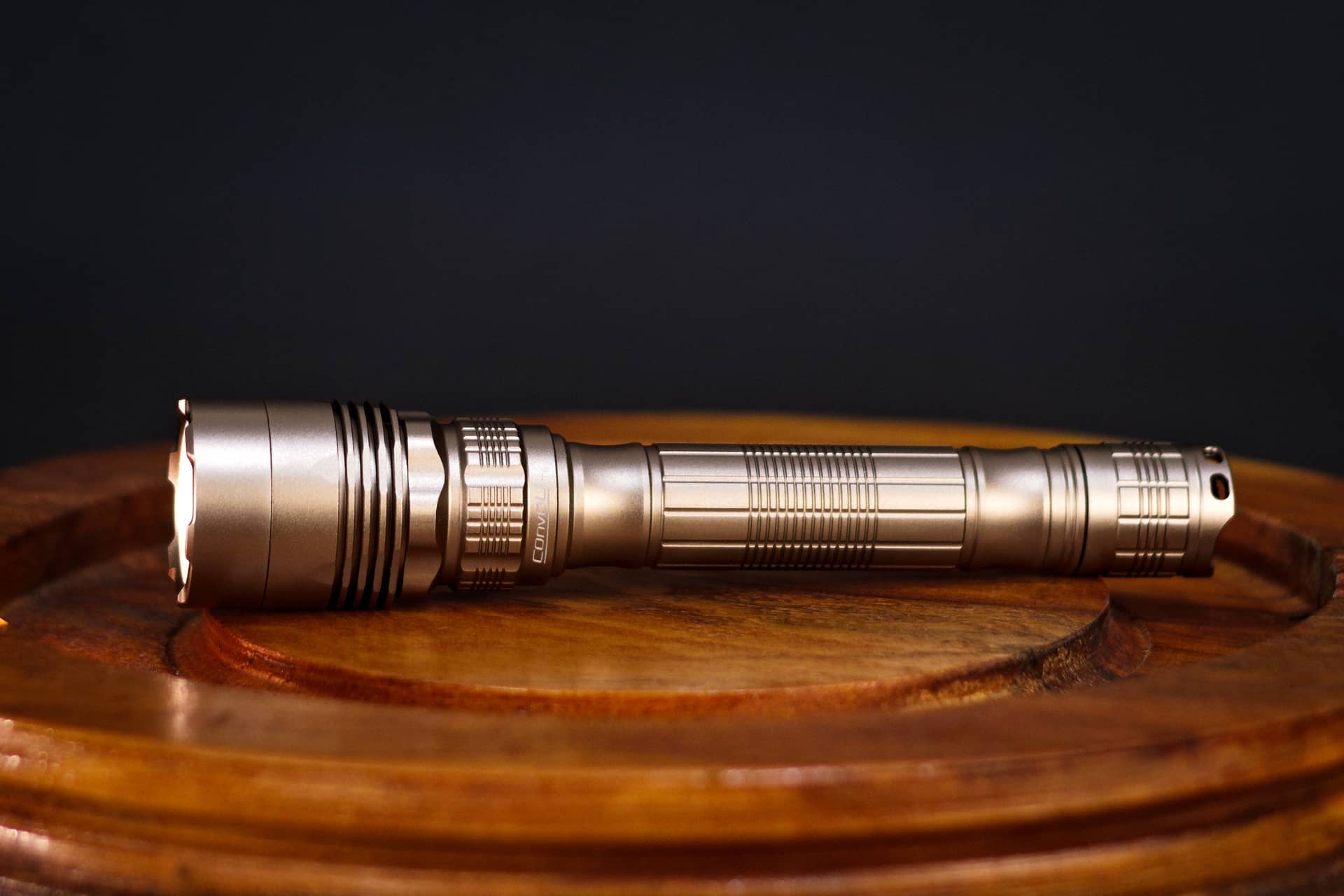

Main body/Grip/Size: The tail, battery tube and head all have knurling to improve grip, the grip is good, even when wet. The head also has grooves for heat dissipation. It’s slightly bigger than the Convoy T4, with a bigger reflector - the T8 reflector - and head, increasing throw.
Material: The entire main body is made of an aluminum alloy - most probably 6061-T6.

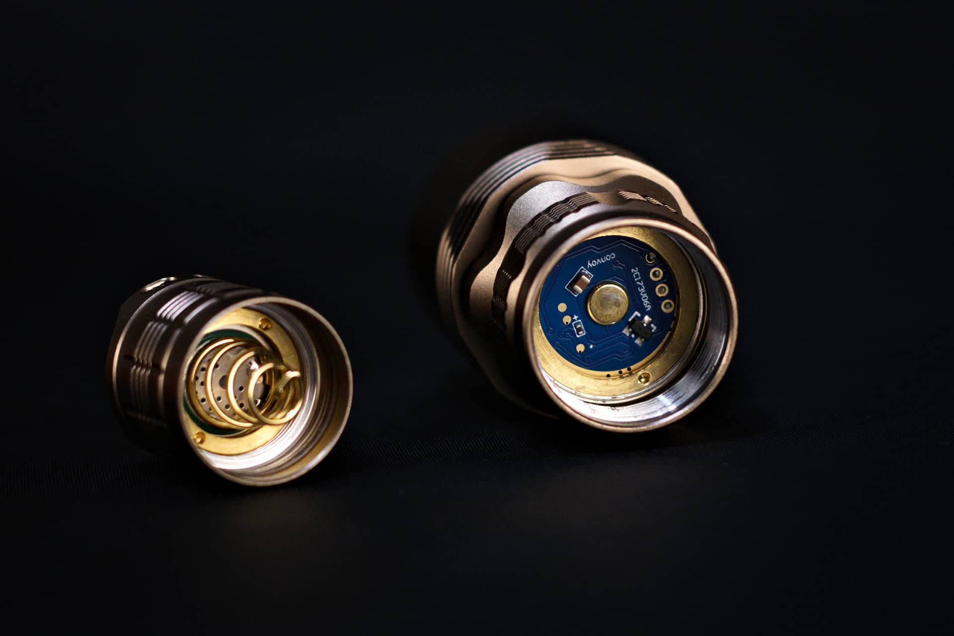

Threads: All threads are trapezoidal, only the tail cap and bezel threads are anodized. The driver part of the battery tube threads aren’t anodized, and they’re pretty long.
Clip: The flashlight doesn’t come with a clip. A stainless steel screw-in clip is available to be bought on Convoy website.
Tail stand and rolling: The flashlight rolls a lot, it has some edges that slightly slow down the rolling, but still rolls a lot. It can head/tail stand, though tail stand is not much stable.
Magnet: No magnet by default on this flashlight.
AUX lights: No AUX lights are present on this flashlight.

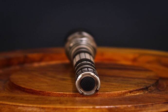

Buttons: This flashlight has a reverse click mechanical tail switch covered by a black silicone boot, this means that giving a half click while the flashlight is OFF will do nothing, but when it’s ON it will cycle between brightness levels, SOS, battery check and other depending on the selected mode.
Battery contact: Contact is made with the battery by a gold-plated button contact on the driver and a phosphor-bronze gold-plated spring on the tail cap. I usually prefer springs on both ends to reduce the impact on the battery when the flashlight is dropped, but this button contact seems large enough to not dent the battery easily.

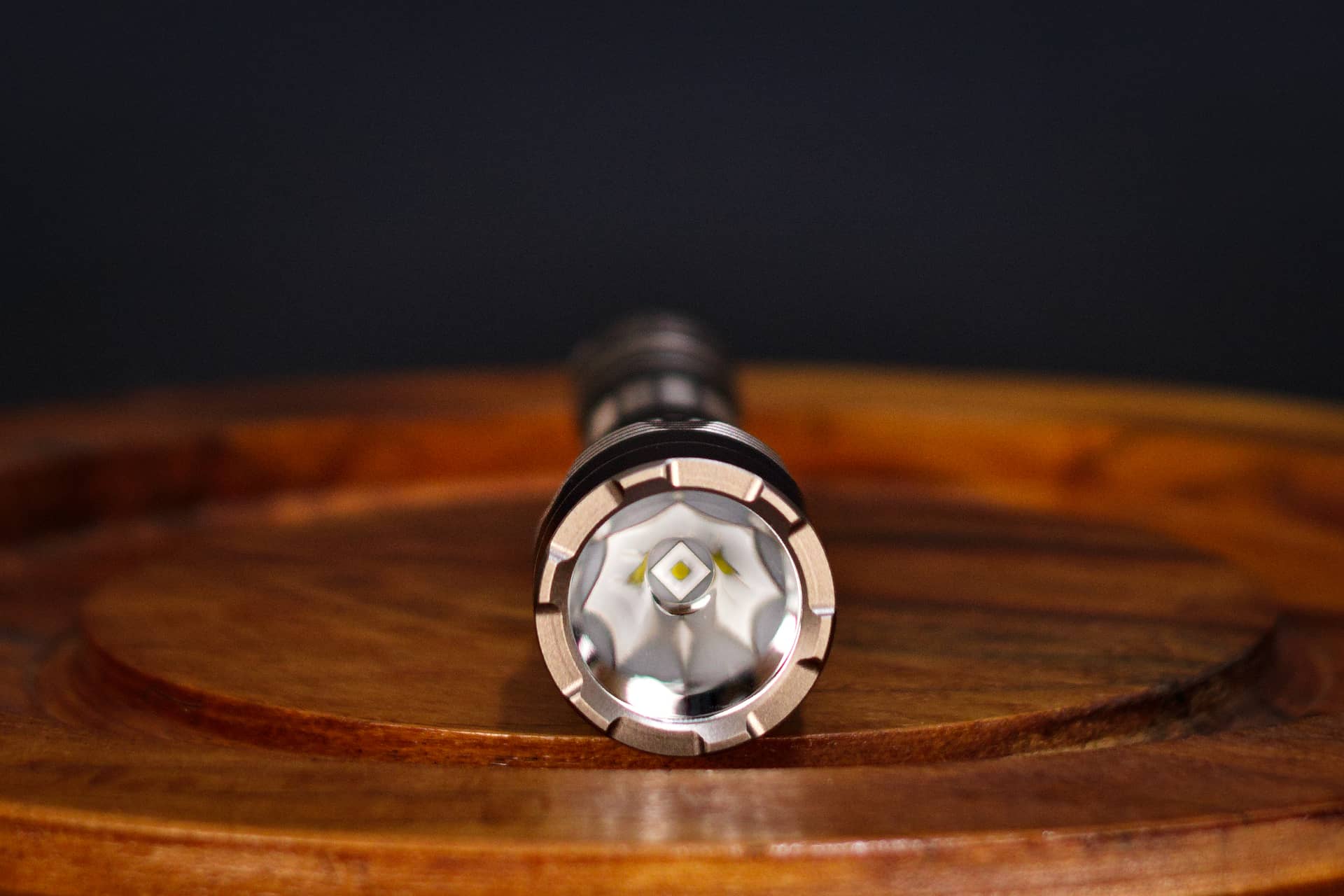

Bezel: It has a aluminum crenelated bezel with 6 trapezoidal shapes on it, it would be nice to see a stainless steel bezel on this flashlight instead of an aluminum one.
Water Resistance: Convoy flashlights usually don’t have the IP rating, but all Convoy flashlights I already tested were decently protected to water ingress; The T9 follows the same pattern, it’s probably better sealed than some IP68 flashlights I own. I belive the T6 to be at least IP67 with all threads greased and fully tightened - if not IP68, as all water ingress points have o-rings.

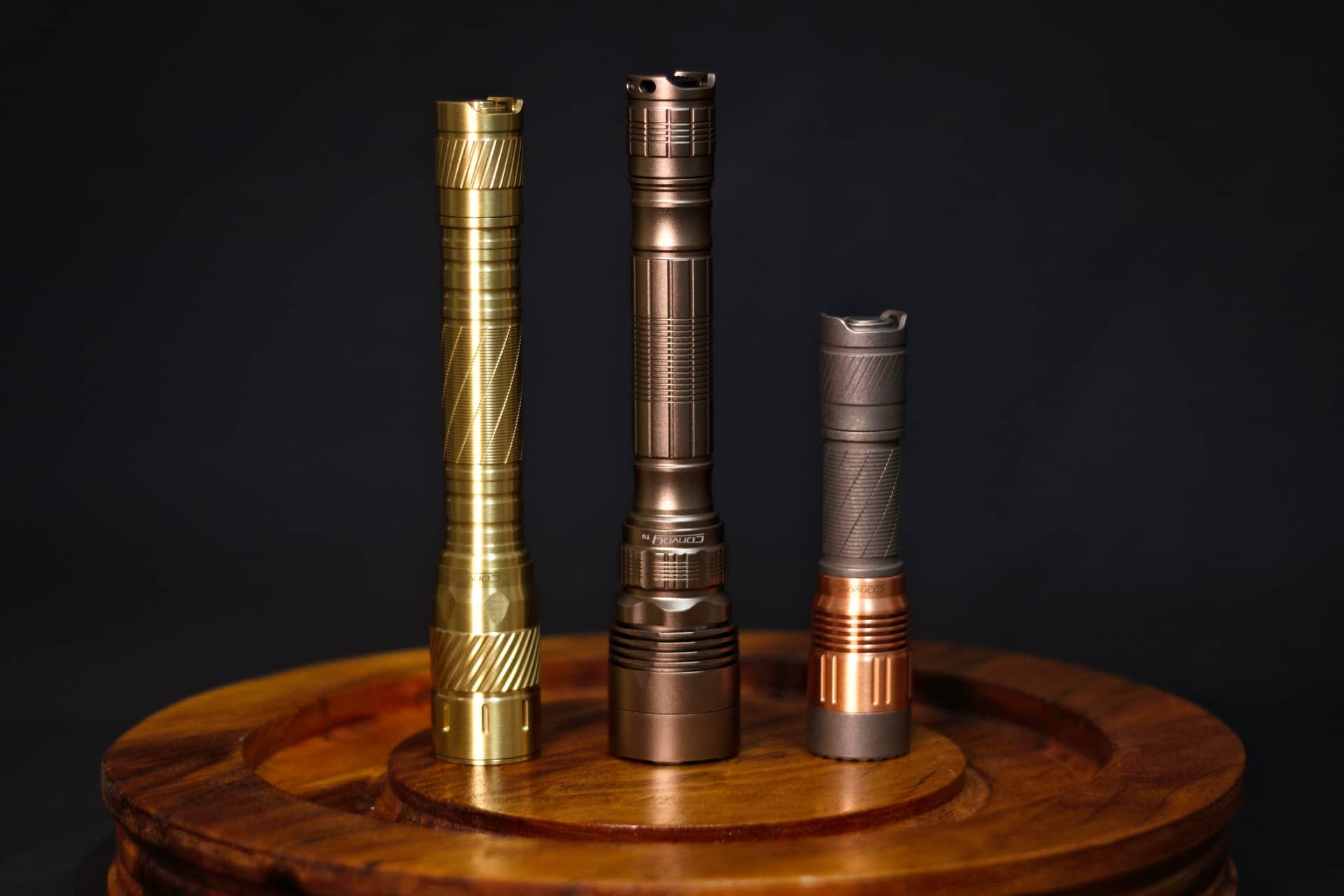

Size comparison:
From left to right:
Convoy T4 Brass (2x14500) - Convoy T9 (2x14500) - Convoy T6 TiCu (14500)

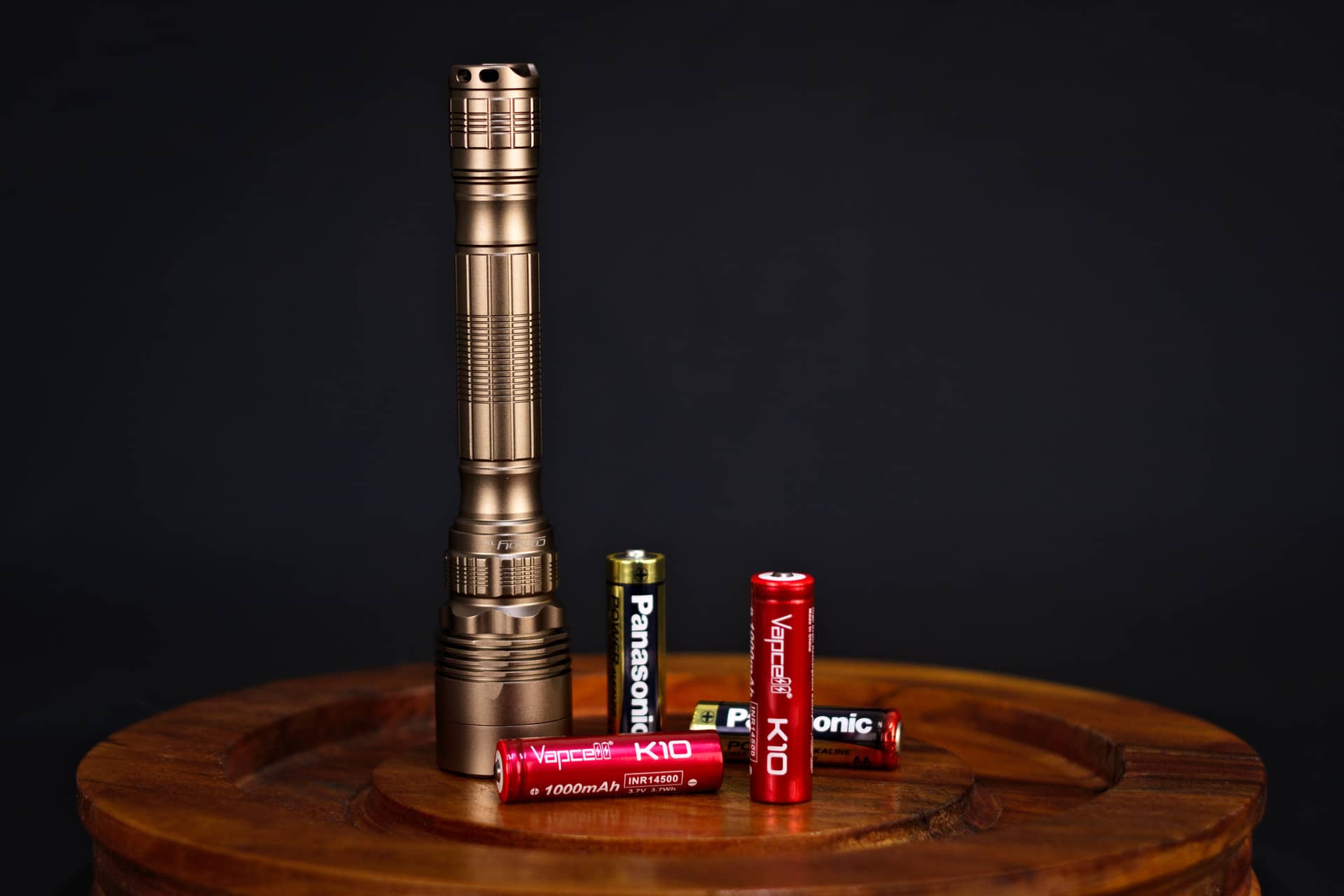

- With battery (2x Vapcell K10): 131.5g
- Without battery: 91.8g
- Battery (Vapcell K10): 1x = 20.0g, 2x = 40.0g
Size: 162.6mm x 32.0mm x 21.0mm - (height x head diamter x tail diameter)
• Battery, runtime, and charging
Battery: The T9 is powered by 2x14500 Li-ion cells or 2xAA (Alkalines, NiMH…) batteries, as it has the dual fuel feature. This makes this flashlight very versatile, and more powerful using AAs than most single AA designs. I recommend at least 4A CDR for best performance.

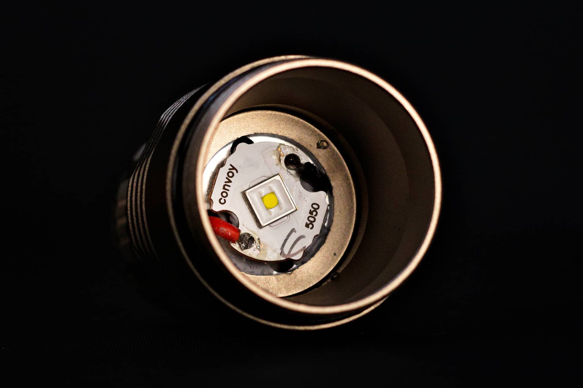

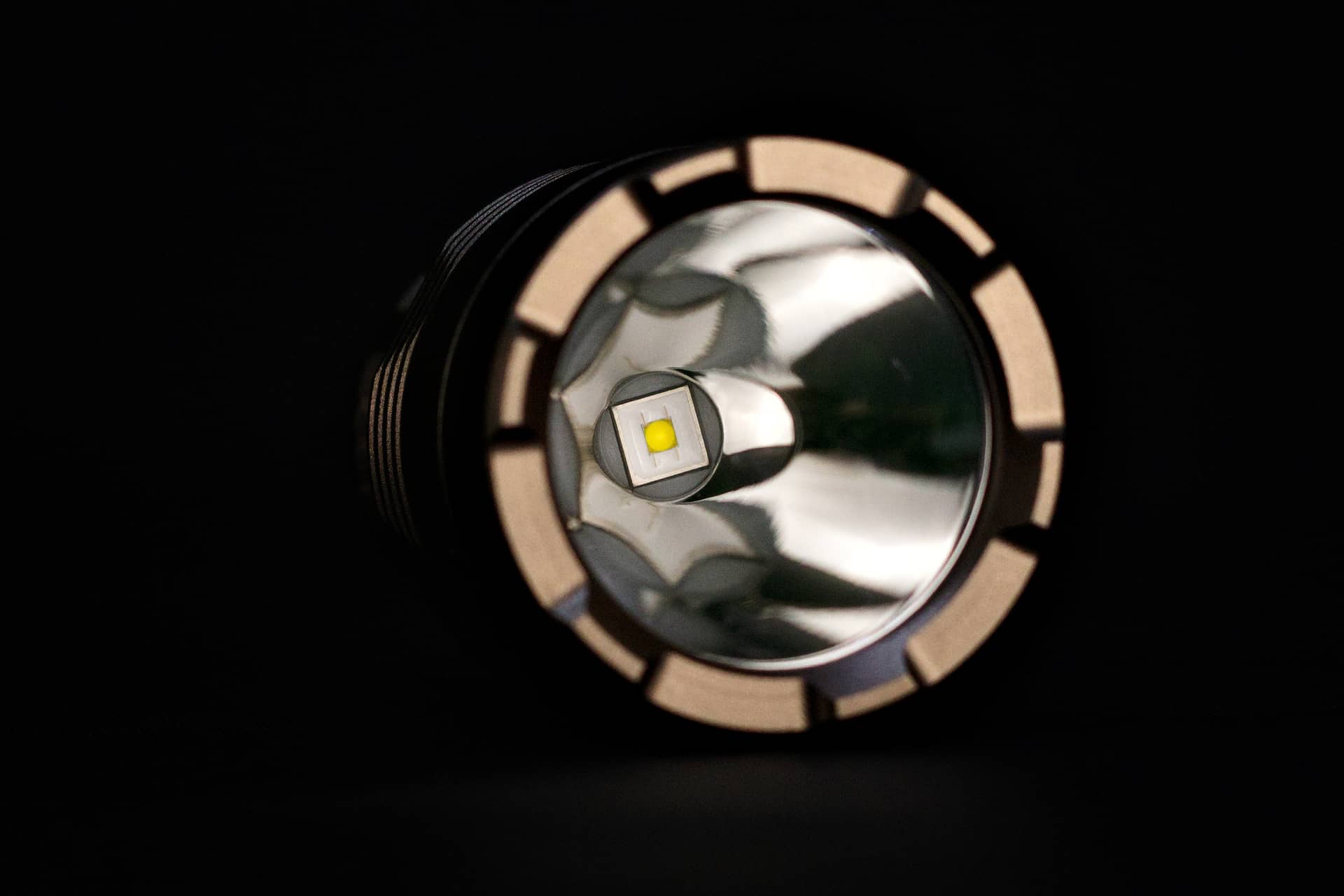

Emitter: This T9 has the LMP W5050SQ5 LED in 4000K, the emitter is pretty throwy, very similar to the SFT40 in shape and beam. The 4000K variant has a pretty rosy tint, being very pleasant and not greenish. The LED is very efficient and offers a pretty good tint, only lacks in CRI.
Lens: It features AR-coated glass lens that protect the reflector and LED.
Reflector/TIR: A smooth reflector with 26.5mm of diameter and 23mm of height.
Beam profile: The beam has a pretty clean spill with not much noticeable artifacts, and a focused strong hotspot that throws far, with a slightly smooth transition.

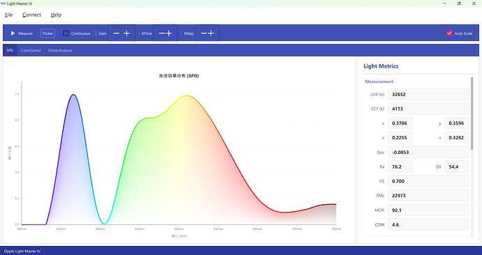

PWM: I didn’t get any PWM on any tested mode of the T9 (1%, 10%, 30% and 100%), seems to be totally free of PWM, also, this supports to it having a Buck driver. **The 1% mode with AAs has slightly visible flickering, I am not sure if it’s a problem with my unit or a general problem with the driver.

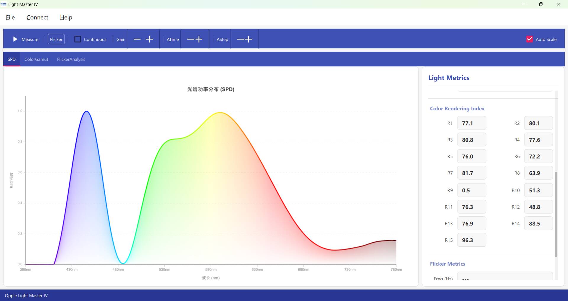

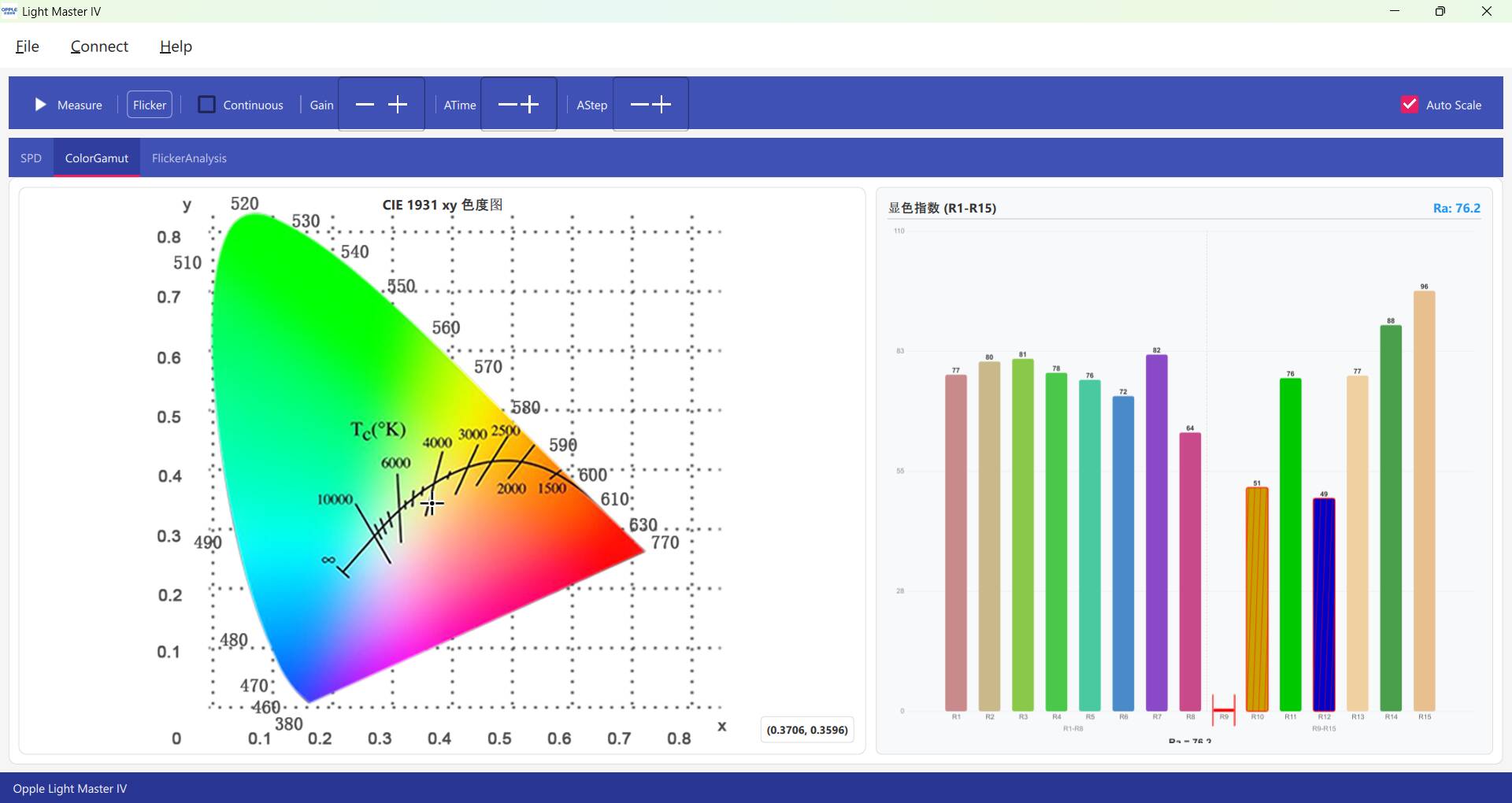

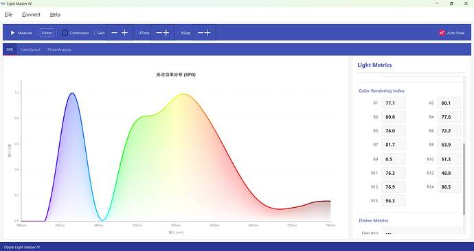

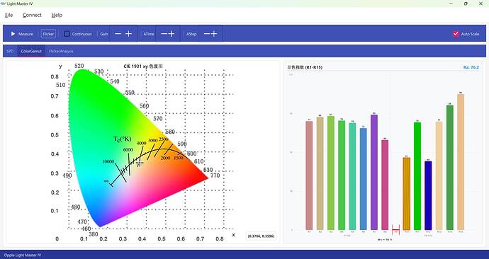

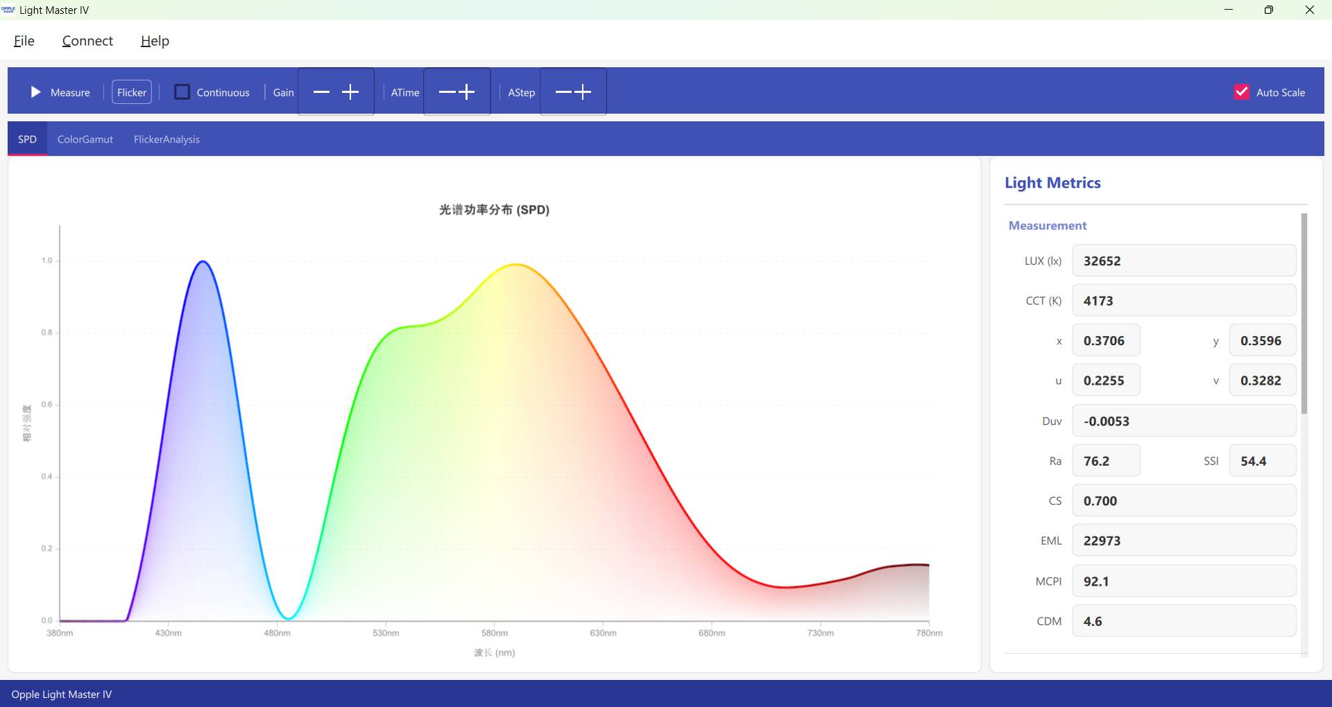

CRI-CCT-DUV: The CRI is pretty standard, I measured around 75 CRI, with very low R9, around negative to 7 R9; CCT was pretty close, getting around 3860K on the lowest mode and increasing to a maximum of 4400K on the highest; Duv is rosy, below BBL, scoring -0.0027 on Level 1, -0.0053 on Level 2 and increasing it slightly on higher modes. (The readings pictures are from Level 2)
