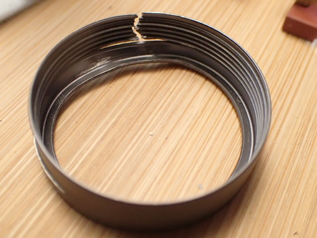

Steel is stronger than aluminum, so if you drop your flashlight, and it lands on the steel bezel, there should be less damage than if the bezel were made of aluminum.

Because it makes this less likely to happen in situations where it matters:

d. i do need EDC ring to be strong, i drop them a lot, i have Al rings that have many dents
