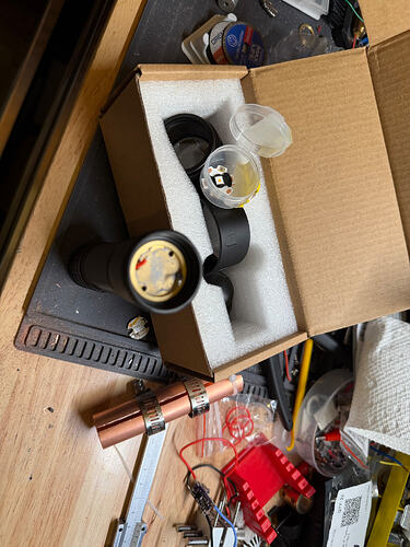

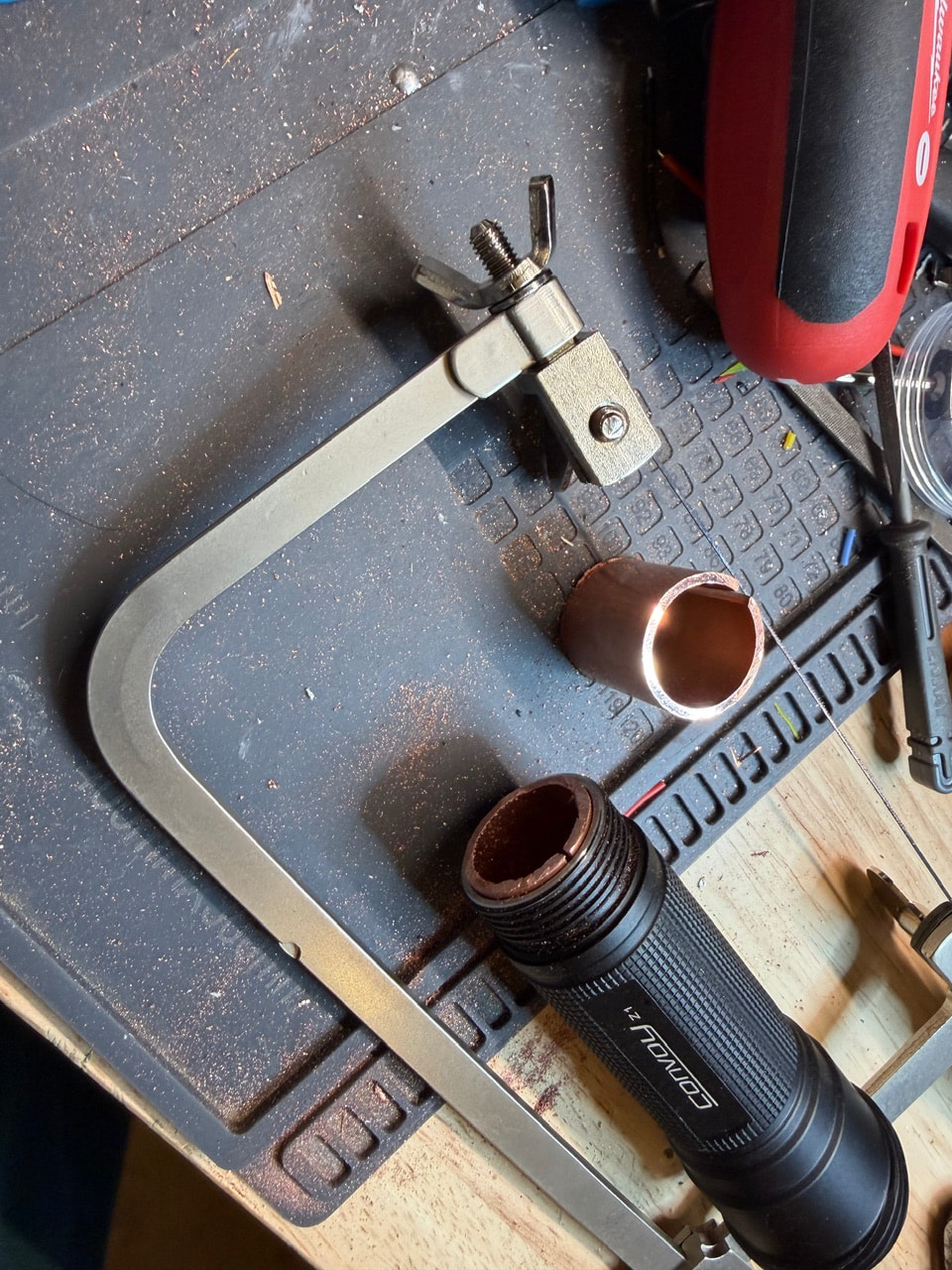

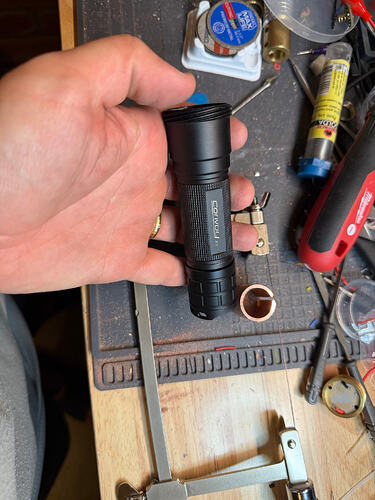

First I got the spare Z1, disassembled and stored the W5050sq3 3000k

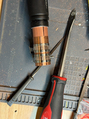

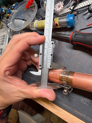

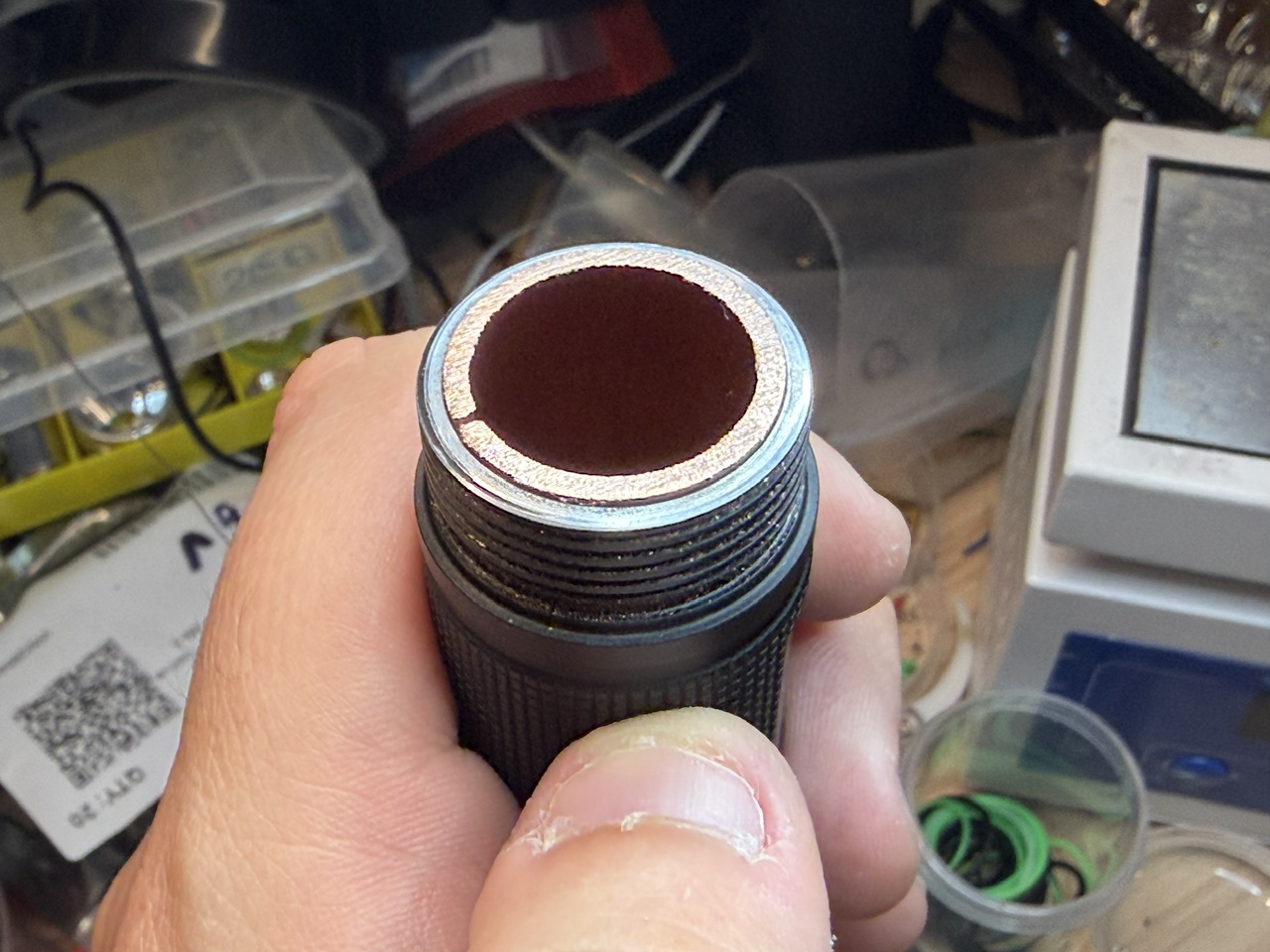

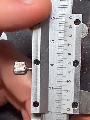

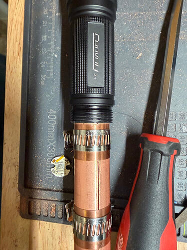

Pre-squeezed the copper tube with a 2mm slot until it fitted on the flashlight:

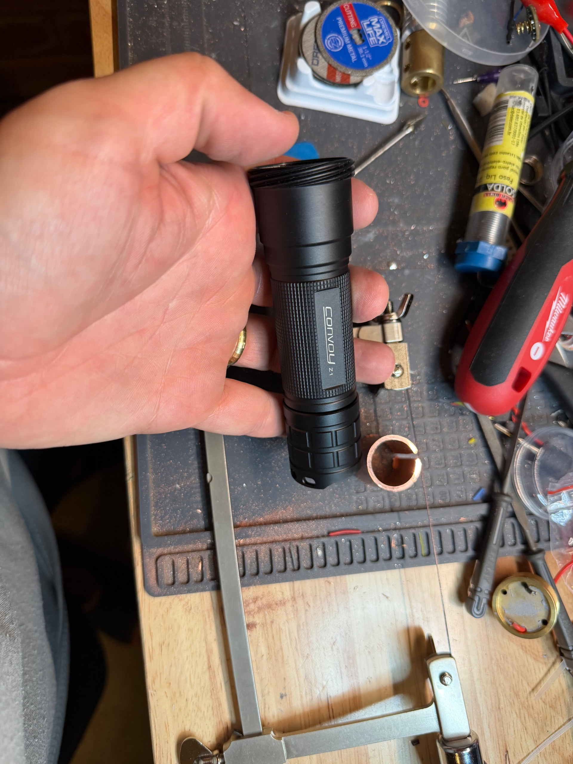

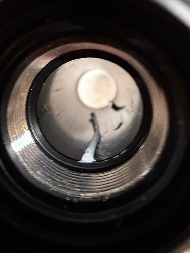

Applied some AS MX6 thermal paste and spreaded a little

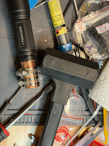

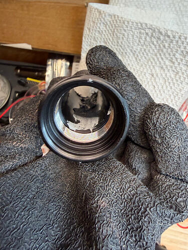

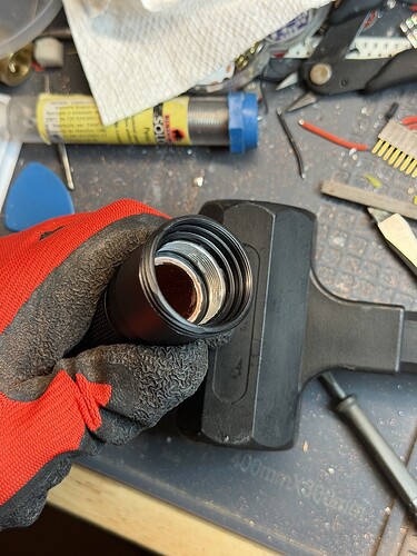

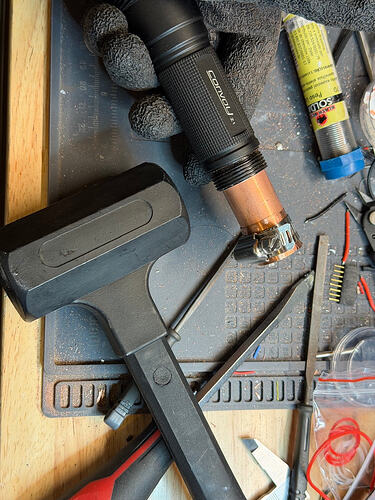

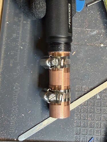

Started inserting the inner tube and moving the clamps little by little, at some point the mallet was needed

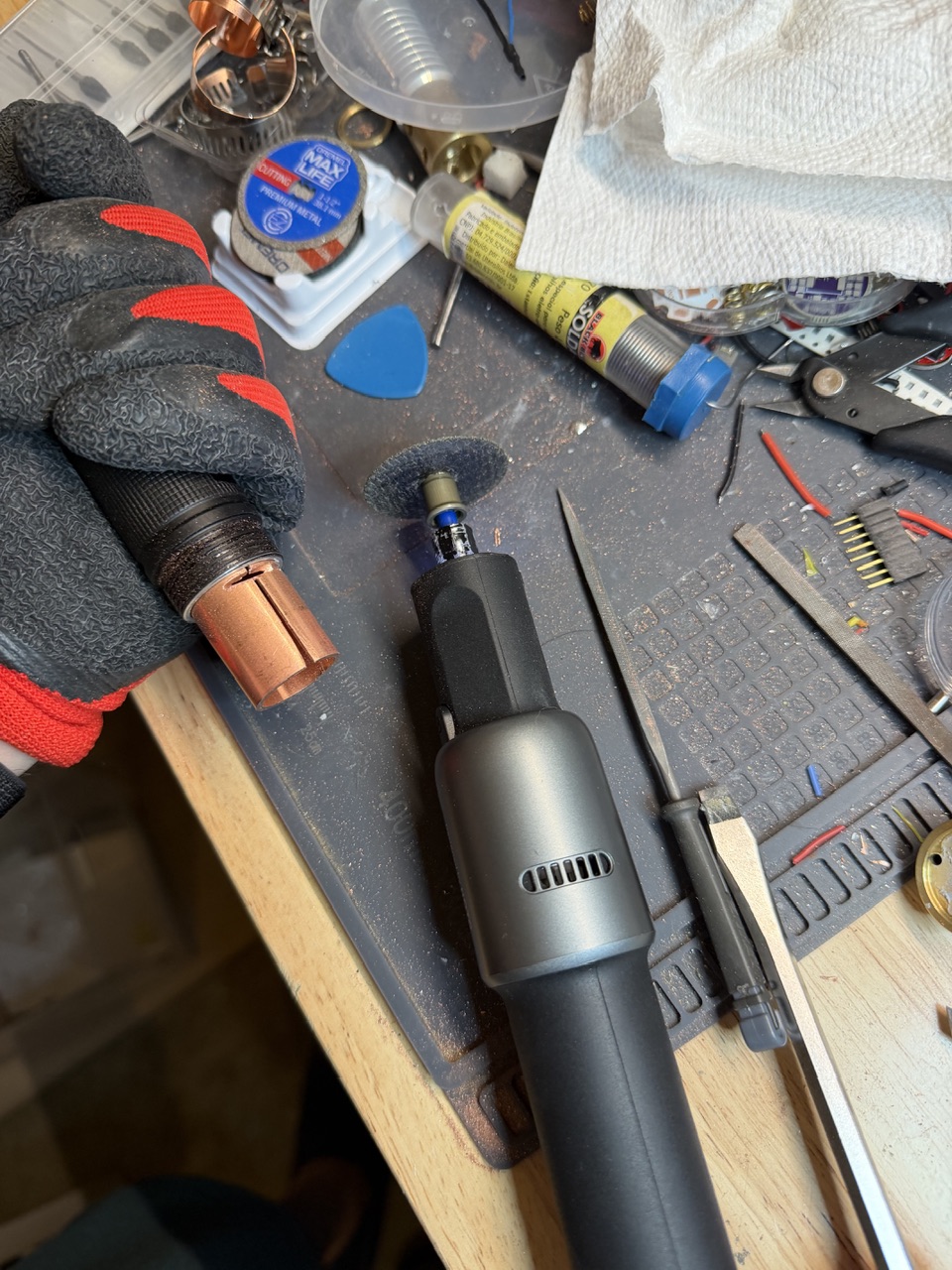

Some excess tube to cut and file down

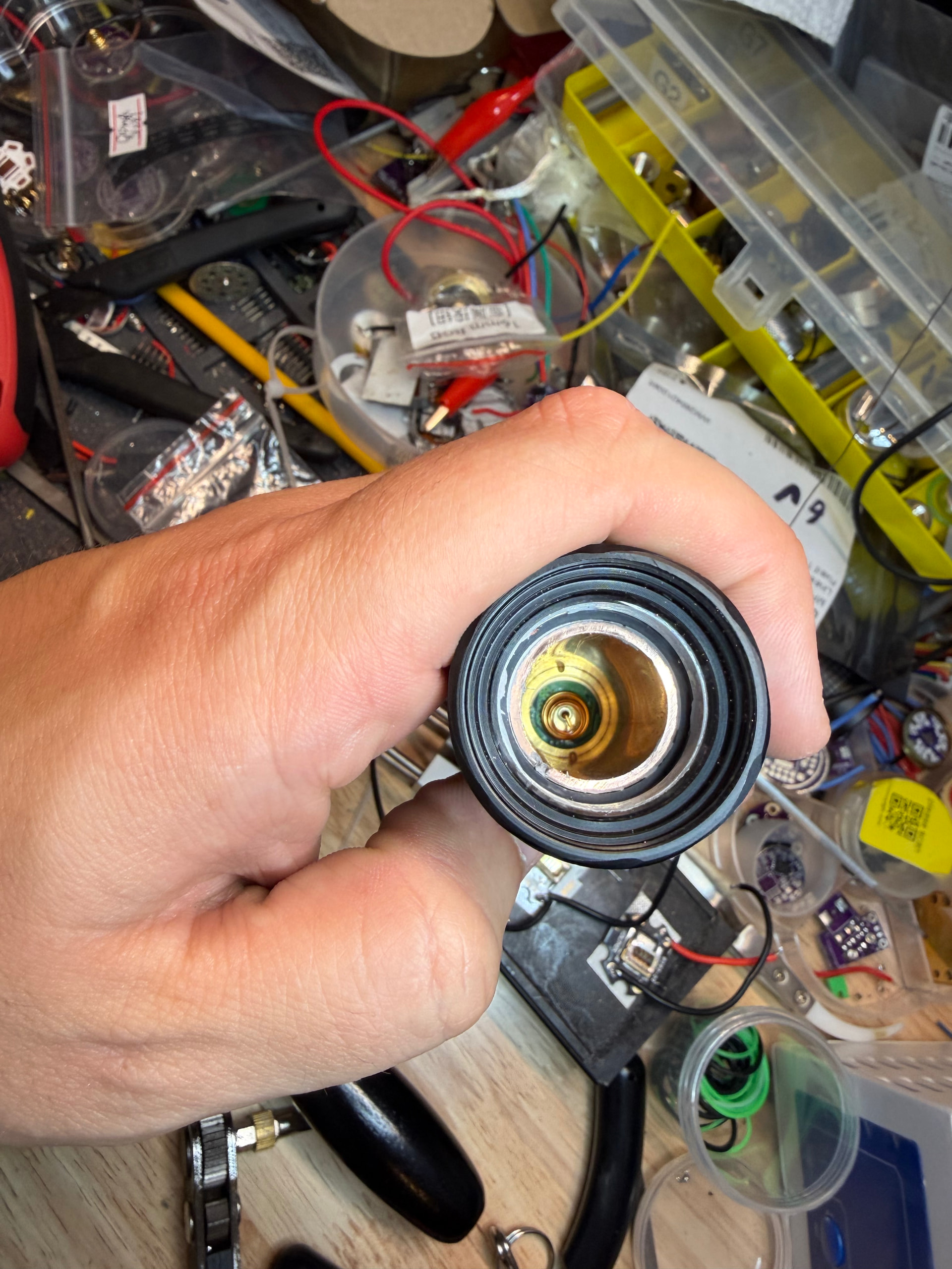

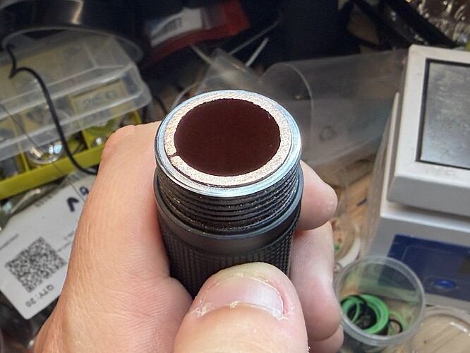

And the tailcap fits!
Feeling nicely heavy now!
I still want to finish it better before transferring the LEP pill, need to remember to weight both tubes with and without the inner copper tube.
