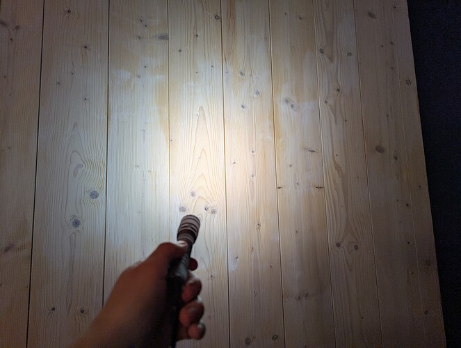

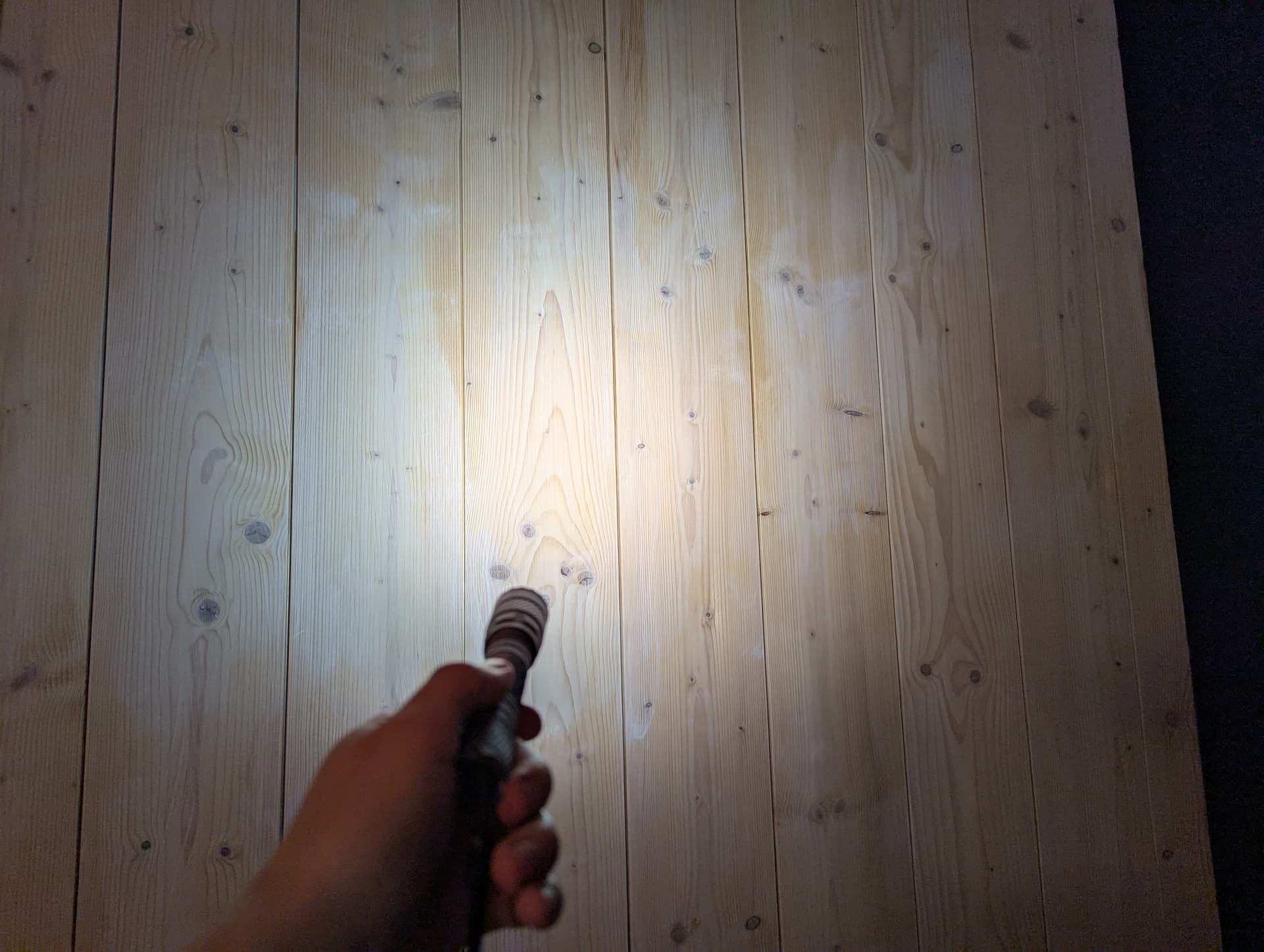

For me, yes. Recently got a C8 reflector with 7mm opening. Even after ensuring perfect centering and fine-tuning focus, the hotspot is lopsided, having a very well-defined boundary on one side and a blurry boundary on the other side. An old reflector (ca. 2019) did not have this problem.

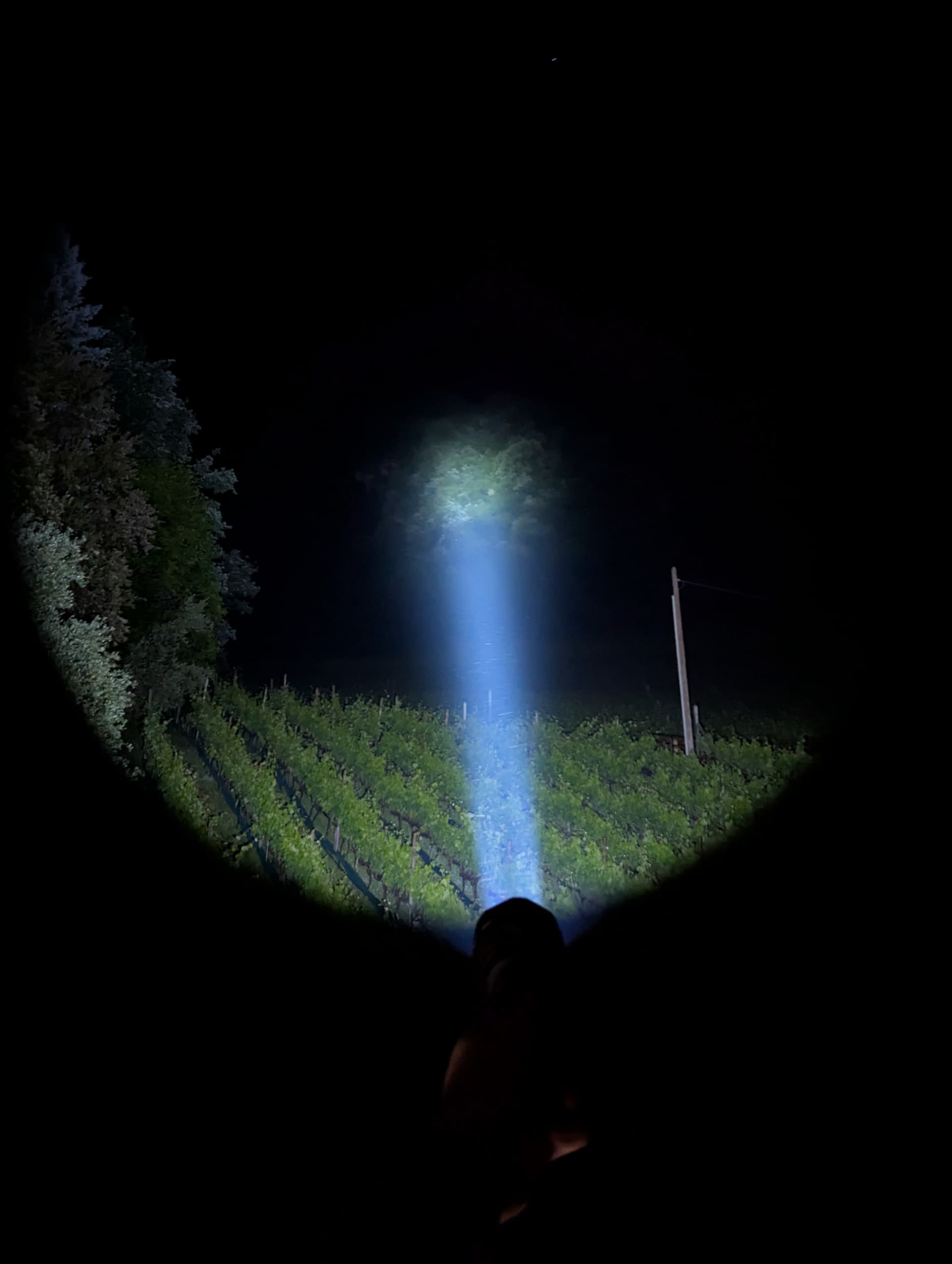

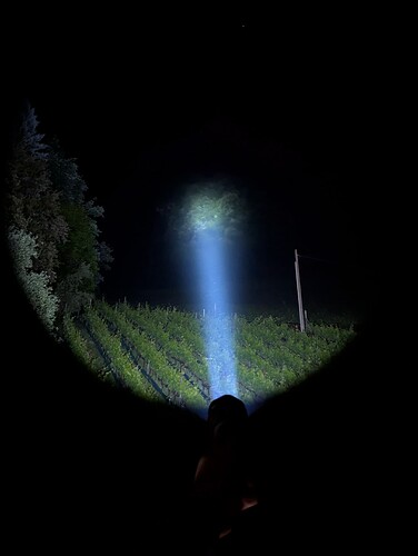

I put the new 20A buck into my L21A / SFT-90. It’s crazy. Call me weird, but it feels a lot brighter than the 12A FET I had before, even if a FET should push more current with a JP40… Maybe the post instead of the spring helped. Maybe the buck has less resistance than the FET on the other driver (should not). Dunno. I’m very happy. Hard to capture on pictures, but it throws like crazy.

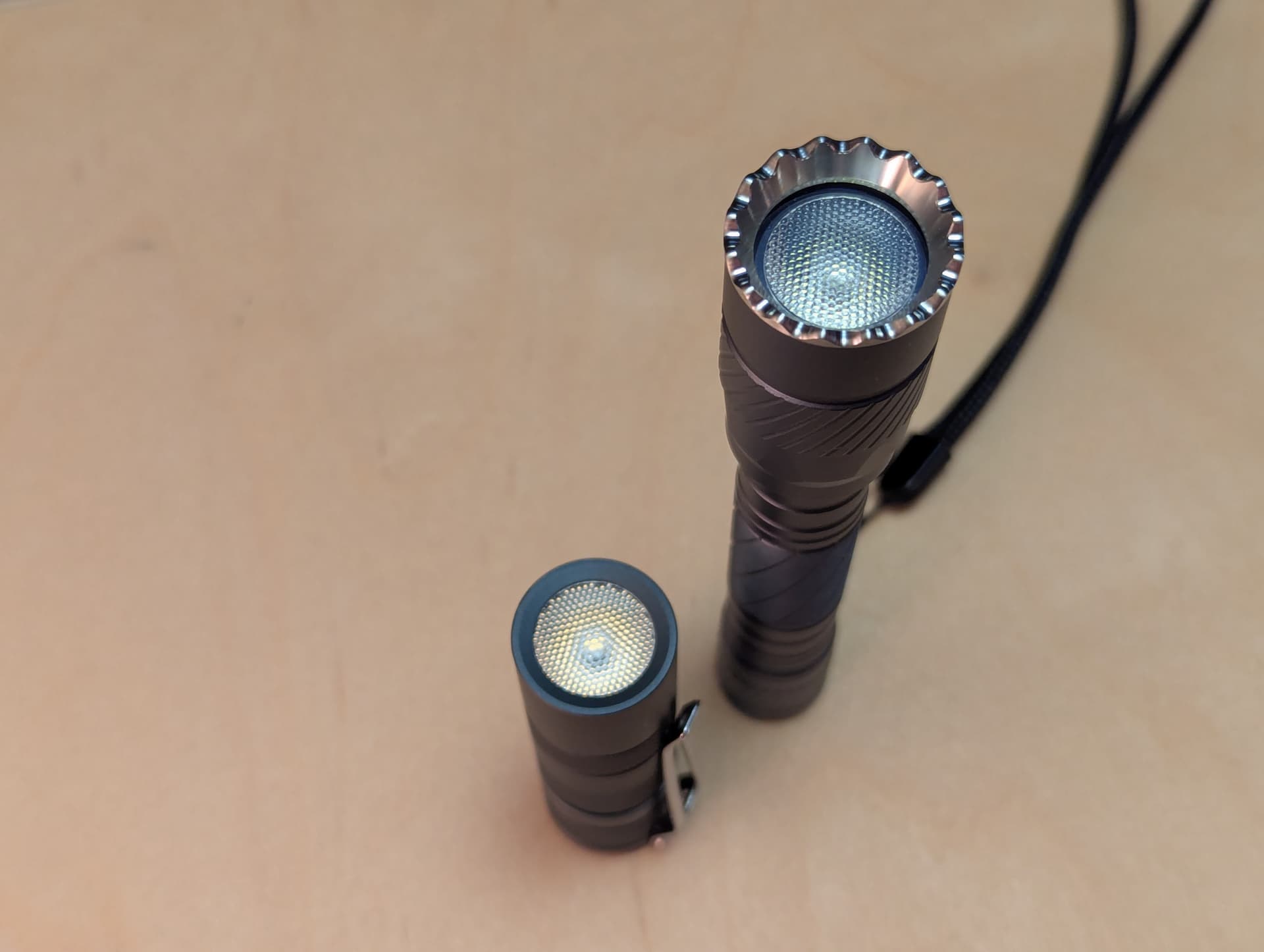

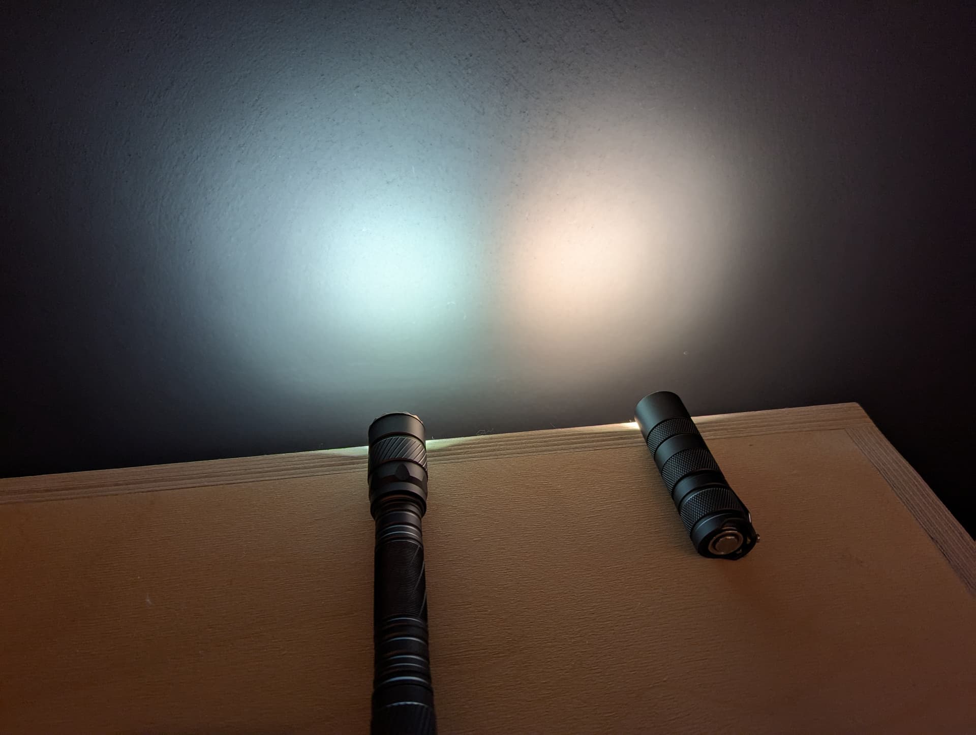

Another fun mod, LHP531 with a 20° pebbled TIR in T4. Very nice floody all-round beam. Pleasantly neutral tint. This light, with 2 eneloops, will probably end up in the car. Sadly Simon does not seem to have a TIR that fits in a T4 without the front glass. Not the biggest fan of pebbled TIR behind glass lens.

How bluish is the SFT-90? I’ve heard some people say that it looks more neutral than 6500k

koef3 measured it even cooler at a bit above 7000K. I can measure mine if I find the time, but I only have an Opple LM4 so… Yeah.
Those two springs Simon was using on the FET driver weren’t able to push it hard enough. I used a beCu spring rated for 20A and measured up to 800 lumens more than those springs. Tried to get Simon to source suitable springs, he agreed to produce them, unfortunately we ended up with 2x 8A springs instead.
Oh, mine had a single spring only that looked like his usual type. Same in the tailcap, which I bypassed.
I received bulk 7mm reflectors and the ones I’ve checked have been okay. I have experienced irregularities of reflectors within the same batch though, most being okay.
The reflector batch differences of gasket thickness seems to have been ongoing for years without anyone noticing. I used to buy a lot of C8+ hosts that came with gaskets for X emitters, I kept them and a while ago I measured the thickness of them all, they were 3535 size and ranged from 0.8mm to 1.2mm. I’ve only been measuring the range for the last 4 years and these gaskets were from before that.
I think back then we all were using more domed emitters, nowadays there’s heaps of domeless emitters with a tiny hotspot making it very noticeable when the focus isn’t spot on.
