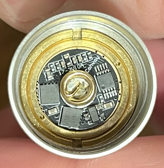

Do I need the thinner retaining ring to use the 17mm 10A buck driver in the S2+ ?
i’m pretty sure mine came with the thinner, retaining ring. I’ll check when I get home tonight.

Yes, I’m pretty sure a standard retaining ring would crush the PFET:
