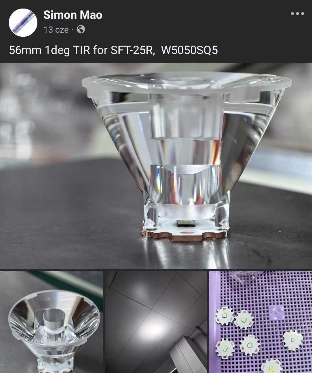

Which host(s) is the new TIR for the SFT25R compatible with?
Rough guess but maybe the L21A/B? The reflector for that light is 58mm though
Maybe that’s a typo and it was supposed to be 50mm like in the M21J/K?
Height to width proportion definitely differs from M21K’s lens. New TIR won’t fit that flashlight.
True, it does look taller. Though from a quick on screen measurement, even taking into account it’s angled slightly, it’s about d/h ~0.7 . So it’s ~56x39mm while the L21 reflector is 58x50mm (and the M21J/K TIR is 50x25,5mm which would scale up to ~56x29mm, no fit as well). Seems like a new light is coming :smiley:

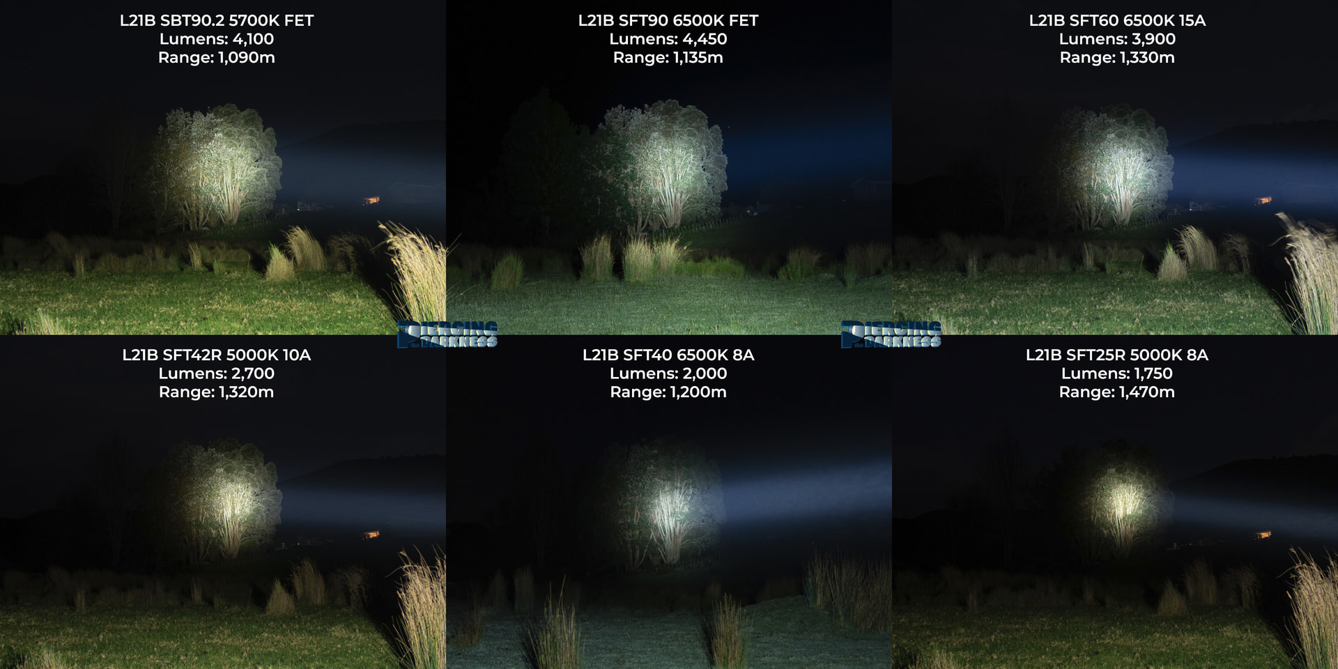

L21B beam profile comparison at 130m, measurements at 30 seconds. The SFT40 isn’t exact, but it is very close to what I can remember.
SFT25R, SFT42R, SFT60 are using the 11mm hole reflector. The SFT40 is using the old 9mm hole reflector.
Using the current 9mm won’t achieve these ranges.
The SFT42R is using the 17mm driver with adapter. The 22mm driver reduces to 80% within 30 seconds.
14 Thanks
When I see this very good comparative test, I think that for me best is SFT42 with good range, solid amount of sidelight and medium power consumption. It is bad that 22mm driver stepdown veey fast.
Does this rapid reduction also affect the SFT60’s 15A driver?
I just bought two of them. I’m not too happy about it, but I plan to use them at 8–10A by replacing the shunt resistor.
No, only the 22mm 10A buck driver.
The 15A & 20A buck do have the bug where group 10 is missing the 10% level.
I agree, everything else is too high, at least for a single cell flashlight. For 2+ cells the SFT60 would be fine though. Hopefully, we don’t have to wait too long for the 5000K variant.
