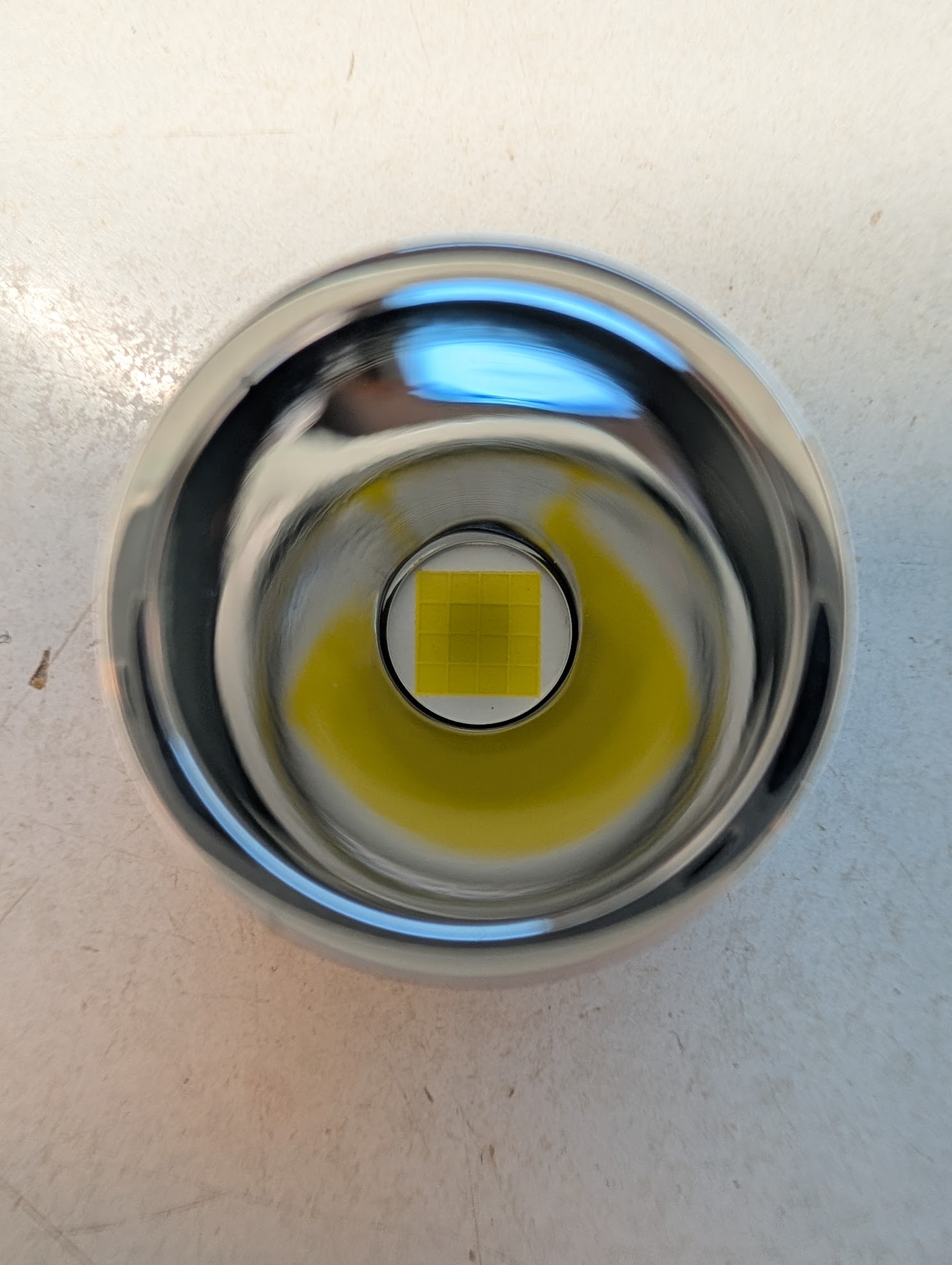

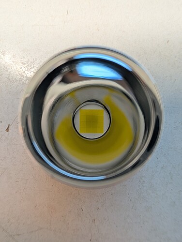

You are right, the LES fits into the original reflector hole:
But, of course, it sits on top of the LED, which isn’t a big problem for a light with a pill, but if I remember correctly, the S2+ has an inbuilt shelf and the normal S2 has a pill? Or was it the other way around?
Also, because of that, there could be centering problems.
But, nobody is stopping you from trying! I wouldn’t put in a 20A driver since it’s pointless with a 18350 cell. You wouldn’t see any difference between high and turbo and hardly any difference between med and high
S2 and S2+ have a pill, S3 has a shelf.
