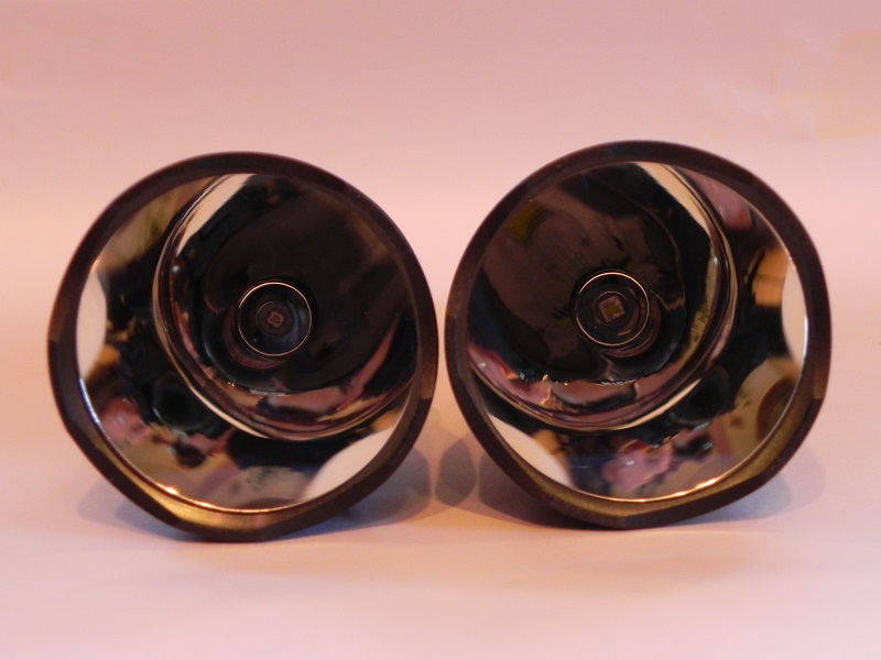

Hy,
i bought the Maxtoch Boards and reflowed my first LEDs to them - successfully :bigsmile:
Both fit perfect into the SN6X-2X (XM-L2@5,8A and XP-G2@4A) and surely are good for some other moddings as these boards are much bigger than Noctigons and the contact plates are far more away from the center. So no problem with big base reflectors. I will try these later in the Trustfire T90-2, too.
I used CR44 solder paste (melting ~180°C) to reflow the LED to the MCPCBs.
