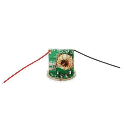

Got a broken STL-V6 here waiting for a new driver too from HK which is taking a while. Remains to be seen if it works as I couldn’t find the original one anywhere, ended up getting this - 8.4V SST-50 5-Mode Memory Circuit Board for LED Flashlights Torch
