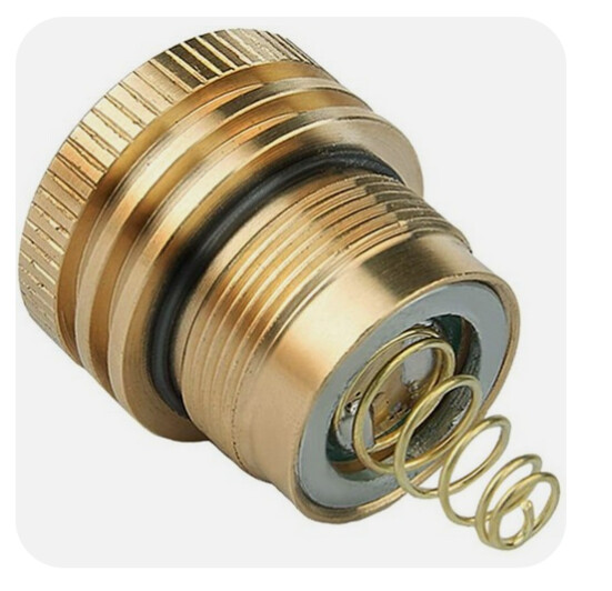

So, I did find this creation:
But the LED looks a little small compared to what I need.

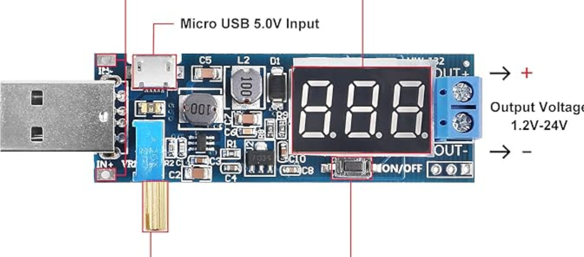

You could easily put something together with minimal soldering.
Something like this usb buck/boost converter.
https://www.amazon.com/XIITIA-Converter-3-5V-12V-Adjustable-Regulator/dp/B0CKH3H3HZ
Set it to 3v. Get 2 wires and the only soldering you’d need to do is solder them to an led on a star mcpcb board that is properly heatsunk. Or is that heatsinked?

Or you could easily wire it to the usb adapter in my previous post.

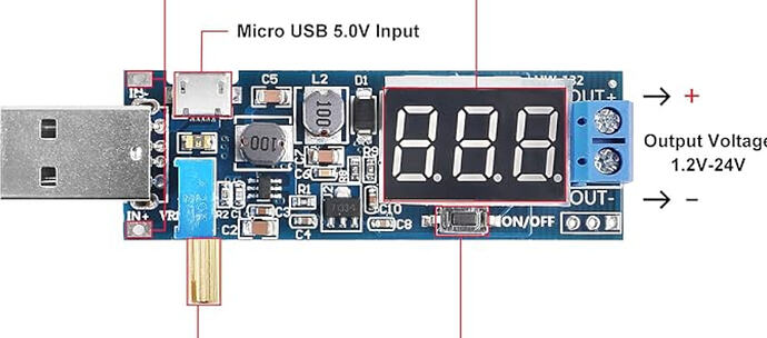

Could I use this:
to power this:

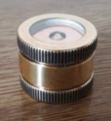

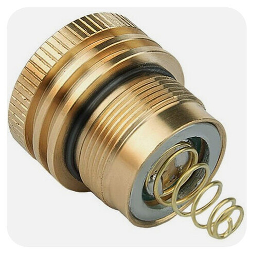

UniqueFire UF-1508 LED Pill White/
That should work fine. You just need to set the voltage properly on the usb buck adapter.
I would start it at 3v and work up from there. In theory, you should be able to go to 4.2v

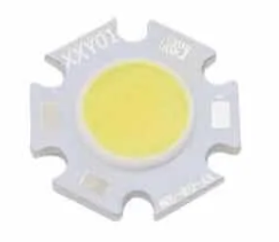

So…what I have right now is the COB LED Light Chip Bead 3W 280lm 6000-6500K 20mm.
$8 for 5 of these.
I did buy the USB Buck Boost Voltage Converter, 15W LCD Step Up Down Power Supply Module.
$18 for 2 of them.
In comparison to the COB in my Phixton flashlight:
  1. The 20mm COB LED is about 1/3 the size of the LED in the PHIXTON.
  2. The Phixton flashlight is just a tinge bluer than the 20mm COB I bought.
  3. At 4.8V and .62A, the 20mm COB is about the same brightness as the PHIXTON on the LOW BEAM setting.
  4. I do not have anything to measure the temperature of the LEDs.
But I did put cashier register heat sensitive paper over the 20mm COB and it did
change the color of the paper. In fact it stuck to the paper and when I lifted the paper the COB LED detached from the heat sink/board. That seemed weird. Actually, the heat sink/plate on the back of the LED was too hot to touch.

4.8v is too high. I wouldn’t take it above 4.2v. Try it at 3.8v, but up the current slowly to find your sweet spot.
Be sure you are properly heatsinking these things. As @gravelmonkey mentioned, an aluminum strip or something will help dissipate excess heat.
If it was the MCPCB (star board) that the emitter is on, that lifted out of the pill, it will need to be properly adheared back into place. It shouldn’t just lift off easily.
You can find Thermal Adhesive on Amazon. You can use that to sparingly adhere the MCPCB back into the pill, as well as adhere the COB lights to an aluminum strip.
Use the stuff sparingly. Apply it and push the 2 pieces together hard to squeeze out any excess.
The closer you can get to metal-to-metal contact the better.
ETA: If the buck adapters do not have adjustable current, you can add more cobs to make everything brighter. That’s probably your best solution. I would avoid overdriving the voltage though.

Do have adjustable current on the buck adapter. Seems like a nice little unit.
