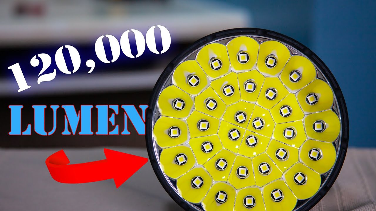

Critical Update: My Imalent SR32 120,000 lumen has LED dies in it that have BURNED OUT!
This is an issue they have had before. I waited to get my light while Imalent addressed the problem (why my video came out 2 months later than other reviewers). During the initial two weeks of testing I had no problems at all. I CHECKED THE DIES and reported in the comments section to viewers that I was having no issue.
After this I ran a series out output tests where the light runs approximately 10-15 straight minutes (total of about another 45 minutes use on turbo across 3 tests), during which time the thermal protection did kick in and should have prevented this. I then sent the light to Ethan and he ran a few more similar tests and that is when he discovered the dies had failed. This failure occurred during what I consider to be “Normal” use. No “torture tests” the light made.
I intend to go through the process of getting the light warrantied. I will post updates to the situation as it unfolds.
Interesting, this is another kind of defect. Previously the phosphor was burned, now one half of the emitter is dead, like it desoldered itself.
It may not be a manufacturing defect, they may have exceeded the capabilities of the materials.
I recall that the peak power measurement was very nearly 950 watts which calculates out to 29.7W/ LED, gross (driver overhead will reduce the net, obv). With that many LEDs spread over such a large area being markedly overdriven at turbo it’s entirely possible that there’s sufficient variation in heat dissipation LED to LED that some cooked without tripping thermal throttling.
It’s Imalent as usual. Some are fine, some aren’t, but t9 be fair I had this happen to a Fenix LR80R. On a Turbo test thermal limit kicked in, but too late (at 120 C). The reflector started melting and a couple LEDs (sst70) started to fail. They warrantied it no problem! Brand new flashlight.
I can only speculate, but I’ve seen this particular thing happen many times. It’s been my experience that the reflow soldering can have a lot to do with it. Mass production requires the use of solder stencils and machines that do tend produce very consistent results. However there are two slight imperfections you can expect from it. Number one is that the LEDs will be sitting up just slightly (probly less that a thousandth of an inch), on the puddle of solder. Or if the solder paste was reduced slightly it can sit all the way down, but there can be very thin or slightly inconsistent spots under the LED.
Believe it or not I’ve actually found that the most reliable thermal path comes from reflowing the emitters by hand. Puddling up the solder and then pressing down on the dome of the LED, then sweeping away the excess solder. Hard to do on a large scale though.
I agree with what Zoulas said about exceeding the emitters capability. It could be that Crees QC is just not tight enough to support this kind of power. A variation from emitter to emitter could easily cause this. We all accept that driving the LEDs this hard is fine, but Cree is only targeting about 18 watts max for the chip, not 29+. I would bet that this light exceeds the recommended thermal junction temp as well, but I have no data to back that up.
It could be both. Hard to say though. Those are robust leds and you can run them pretty hard and they survive. cooling and thermal path are very important at that limit. When you have that much heat concentrated over a small-ish area, it can overwhelm a so-so thermal path. If you’ve got multiple LEDs failing in the same way, to me that’s less quality control and more of a design limit failure. That’s what happens when you push the envelope.
Based on Cree’s “XLAMP portable LEDs” feature sheet document, Cree evidently thinks it is reasonable to overdrive the 6V XHP50.3 Hi to 5A, with good heatsinking.
