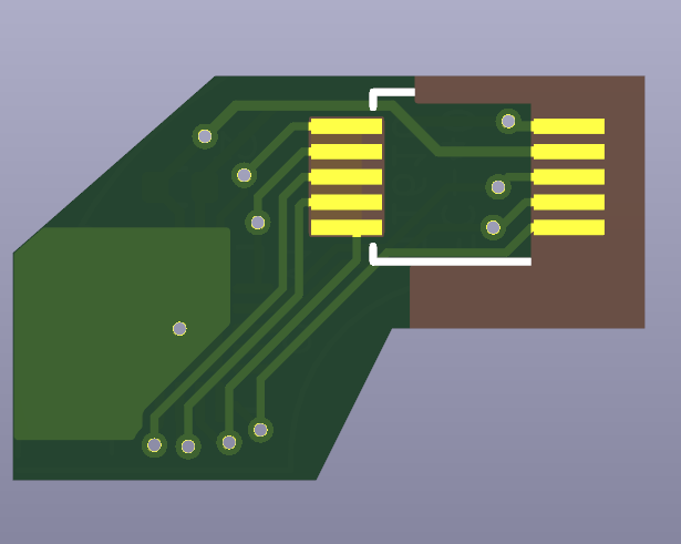

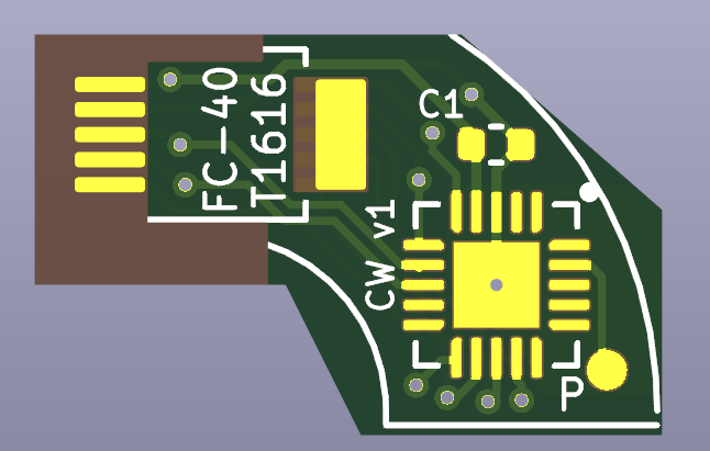

I made a flex PCB for T1616 for the gtfc40 driver a good while ago, ordered the pcbs, then the driver, but the one i received was QFN so i coudn’t try it.
couldn’t put it above the original footprint so it’s deported, i planed to add some glue/potting to thermally join it to the board.
anyway, something like this should be possible for this driver too.

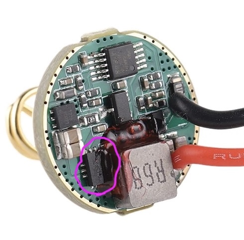

Ah, shit, I forgot the MCU is also the temp sensor. That makes it more difficult. I did not expect the Sonix MCU to be this small, the package looked larger on pictures :smiley: I was hoping one could fit the new chip inside the old footprint.
Maybe it’s possible to make it work with the footprint on top of each others, even if there is no space around it for the connections, by not using the thermal pad and put the vias there. Maybe adding some soldermask to be sure no vias make electrical contacts to either thermal pads. It’s not like the thermal pad has much use anyway.
BTW that’s what Zebralight does, route tracks and vias under the MCU’s thermal pad.
Alternatively one could go the wonky mode, and deadbug the chip with thin enameled wire :smiley:
Do you remember which package type the Sonix chip uses?
Its the 3x3mm one.
Edit : MSOP-10 https://www.sonix.com.tw/article-en-3562-21378
Or QFN-20
