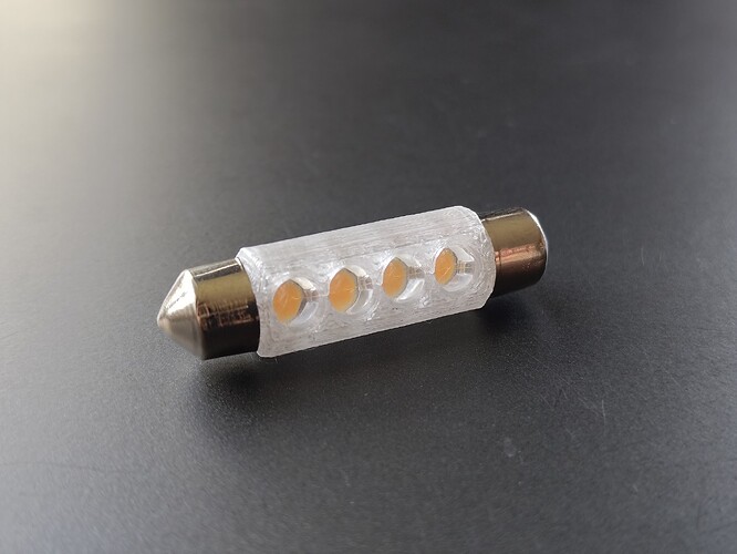

This was the first project, replacing a 10W incandescent BA15S bulb. I went with four 2300k >95CRI 5mm LEDs in series, drawing 20mA each when input power is at 13,5V with a 120Ω resistor.
The “optic” is 3D printed transluscent PETG.
It’s basically just a holder for the LEDs, with a 0,2mm bottom layer as the lens to give them a bit more flood.

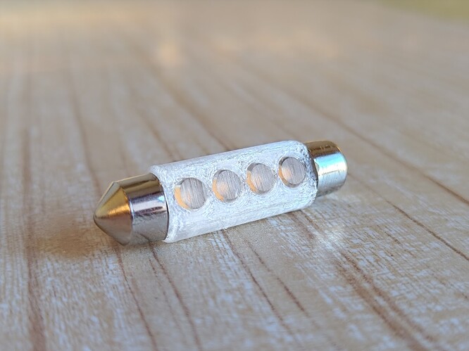

These are 5W incandescent 41mm Festoon bulbs, and I also went with four 2300k >95CRI 5mm LEDs in series here.
I am really happy with how these turned out.
The end-caps are salvaged from other LED bulbs bought online that had a horrible color to them. They are press-fit onto the end of the body, with the negative LED pin and a resistor on the positive side jammed in-between the cap and the body. No soldering to the end-cap needed. Printed in the same transluscent PETG.

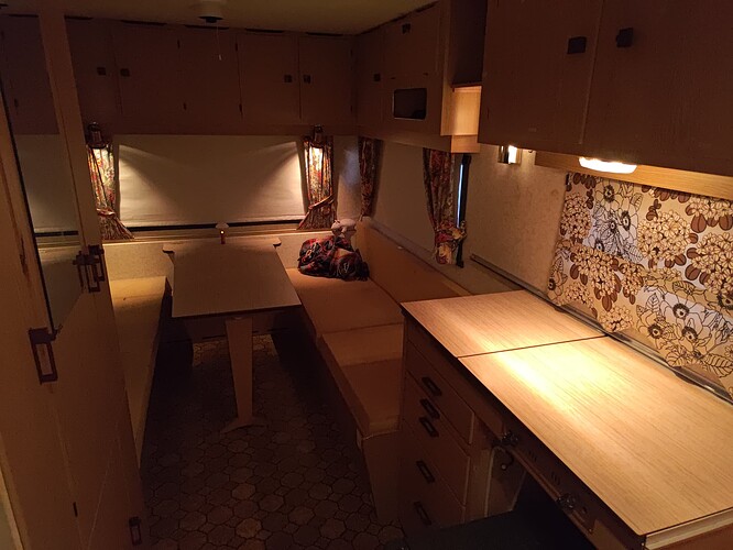

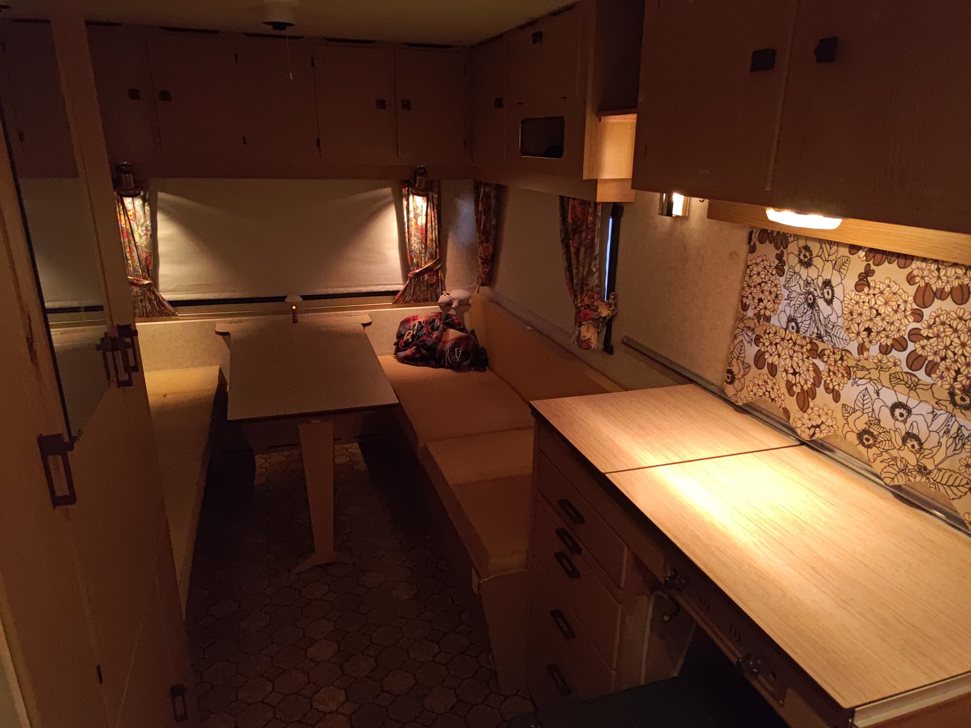

Comparison with the cover on. Incandescent at the top, LED at the bottom.
From the side…

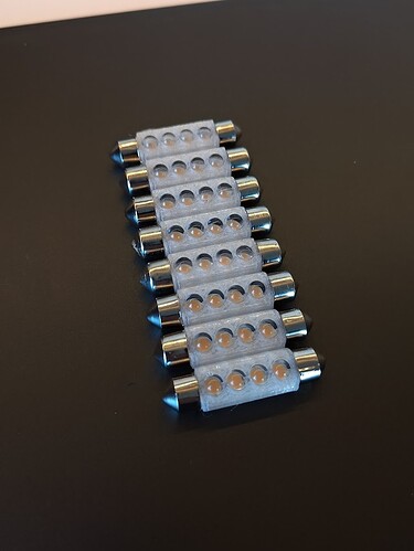

Made ten of them, eight in one go. Pretty fun! Probably going to do this for the bulbs in my old cars too.
Here’s the result!
Now, for energy comparison: I had ten 5W and two 10W bulbs in the camper. In total they had a current draw of about 4.63A in 12,5V. That’s about 58W. There were probably some voltage drop in the cabling and fixtures.
With the new LEDs it all has a power draw of… 0.2A in 13V. That’s a hilarious 2,6W.
22,3 times less power, but still lighting the camper up like it did before… almost, overall brightness is slightly lower, but that’s just a plus.

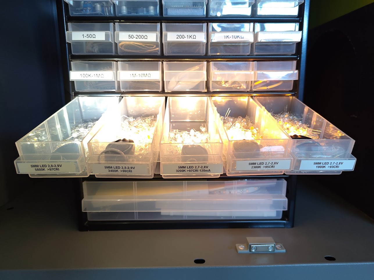

I’m sure I’ve bought over thousand bulbs in total, and those I just made absolutely crushed all of them in CCT, CRI and tint. I wish I had thought of this sooner, as I’ve had my 3D printer for about 6 years now, and the 2300K LEDs for 5 years. I also have other LEDs:
