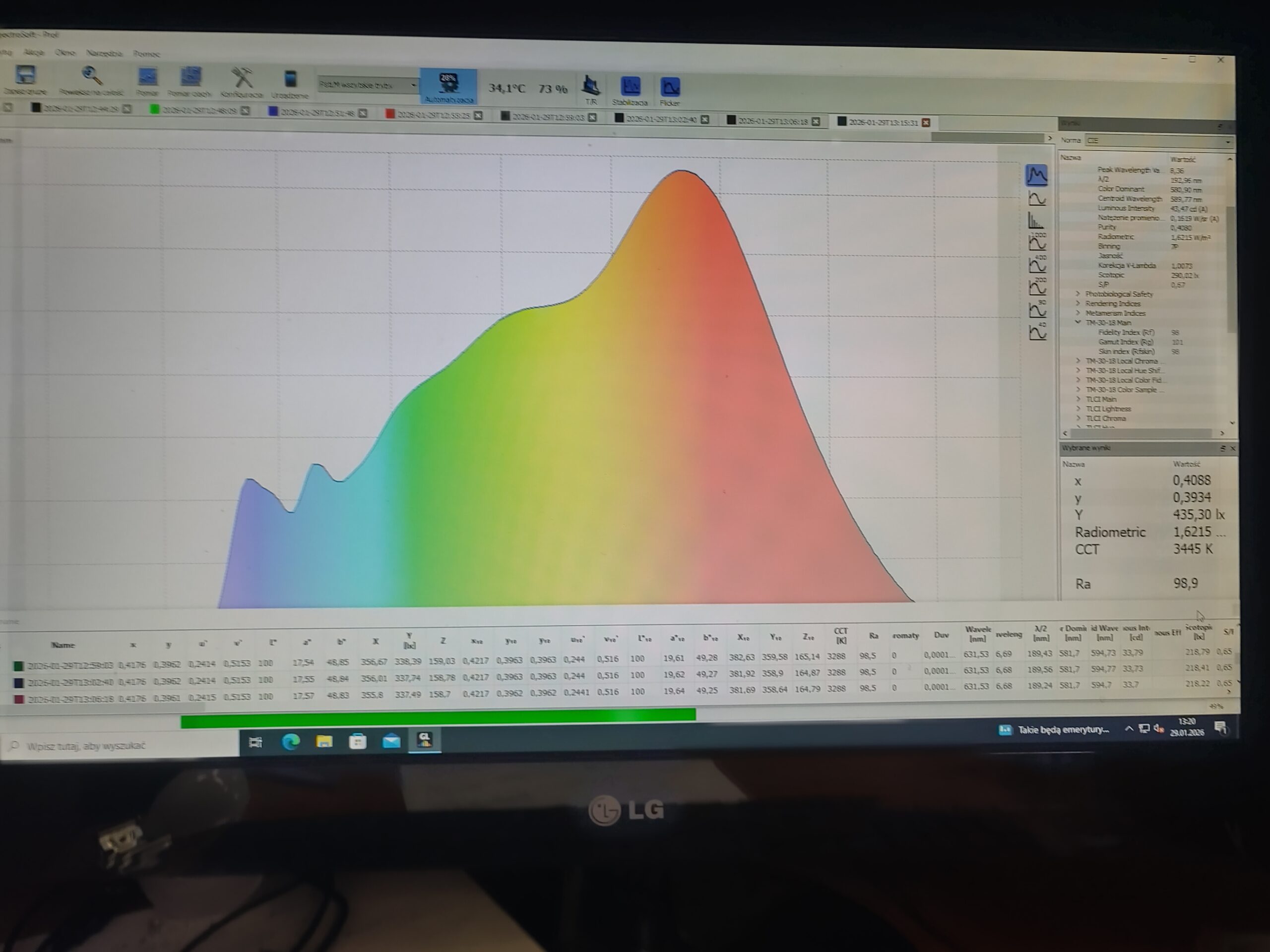

There are no white LEDs without any spikes of base emitter. In real measurements there are always differences (comparing to datasheet). Below last real measure results for 3500K product:
The Thrive spectrum shown here does not exhibit the huge 450nm spike that is present in your spectrum measurement from earlier. This difference is more than can be explained by sample variance. Any chance you were sent wrong emitters?
I was also surprised by that. I don’t know exact condition of this measurement. It was made by my customer and I suppose there could be some additional light from other LEd source indicated in that blue spike. THRIVE emitters I use bought from official Bridgelux distribution.

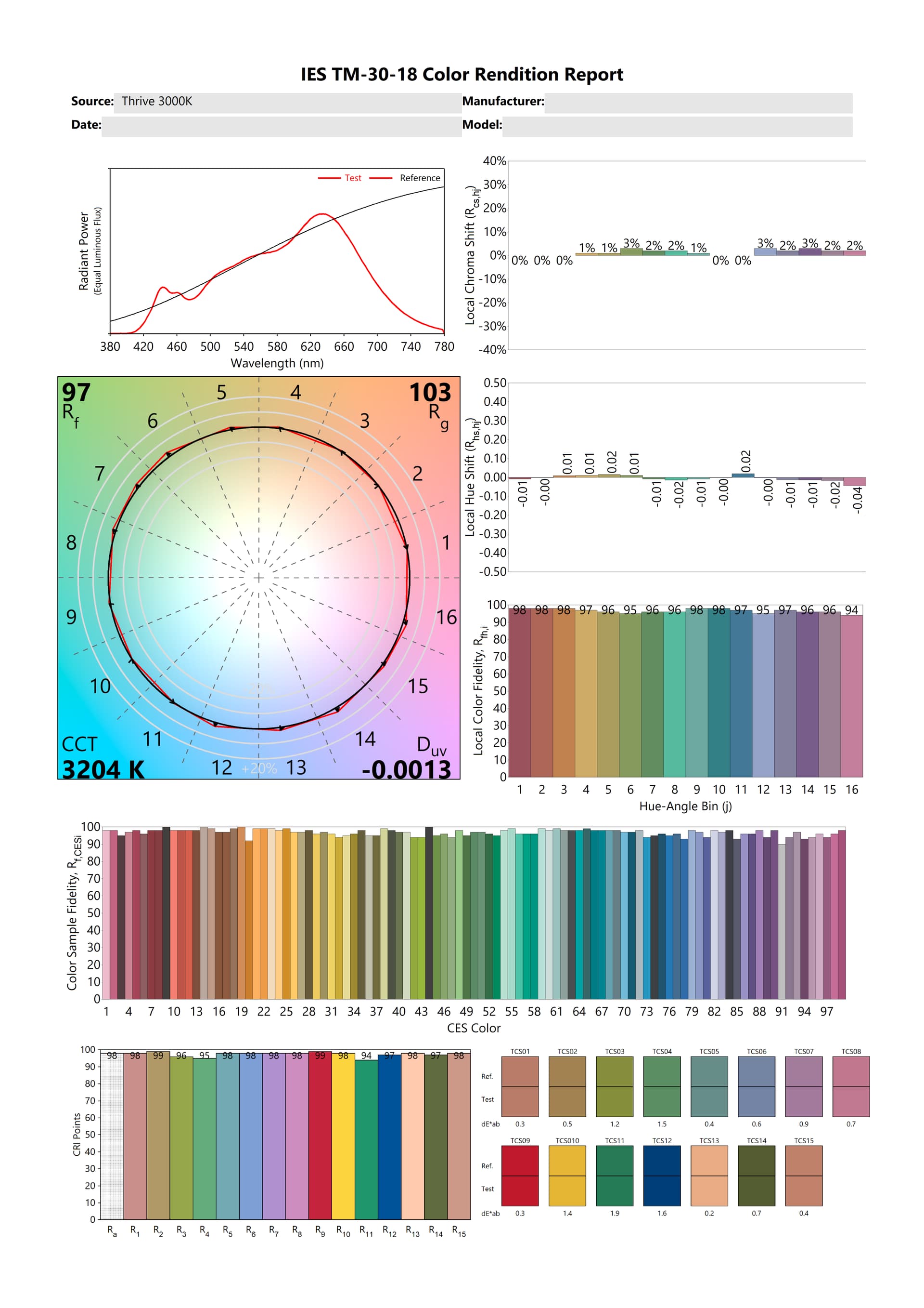

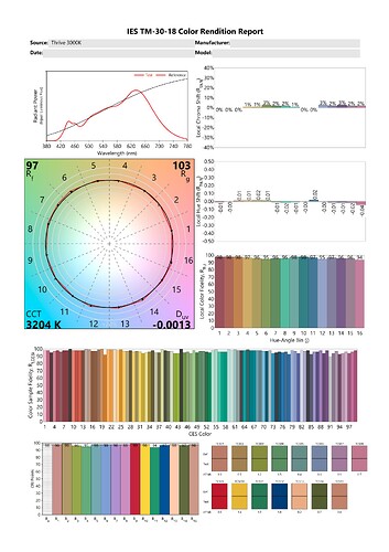

Here’s TM-30 for a 3000K Thrive 1W 2835 emitter I measured a while back. It still has a bit of a blue spike, but seems more in line with the datasheet.
This makes a lot more sense in comparison to the official thrive spectrum. Both the blue spike and cyan dip are not pronounced.
