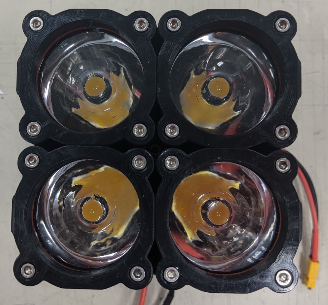

Build 2: The super bright flashlight
- LED 4 x XHP70.2, dedomed
- 8A driver. Custom PCB design
- ~215W going to the LEDs
- Waterproof fan
- Lens: 4 x Ledil Crystal RS
- Battery: 18 cells of 3400mA 18650. 22.2v, 10.2A
- Controller: ESP32
- Wifi or pushbuttons
- Modes: 0.1, 1 5, 50 and 100% (of 8A going to each LED)
This flashlight can be controlled with pushbuttons or via WIFI. The idea is to mount it temporarily on the roof and link it to a cellphone or to the car’s high beam switch.
Test at full power. The trees are ~350 meters away.
