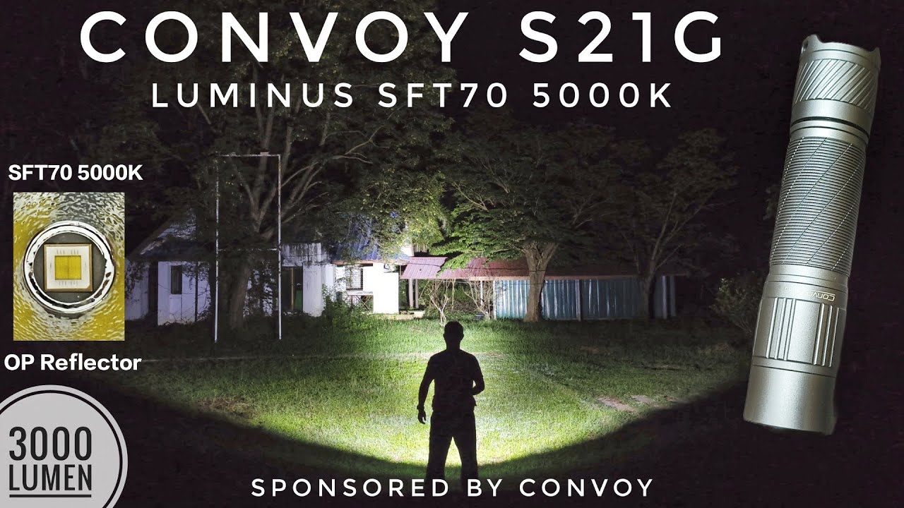

I should note that the SFT70 does not throw nearly as far as the SFT40, so the SFT70 might not be the perfect solution.
A flashlight with an SFT40 and one or more floody emitters would be a better solution, but of course it would most likely be bigger to support the different emitters.
I found this Weerapat’s video comparing SFT70 and SFT40, both 5000K and both in the same host: Convoy S21G.
