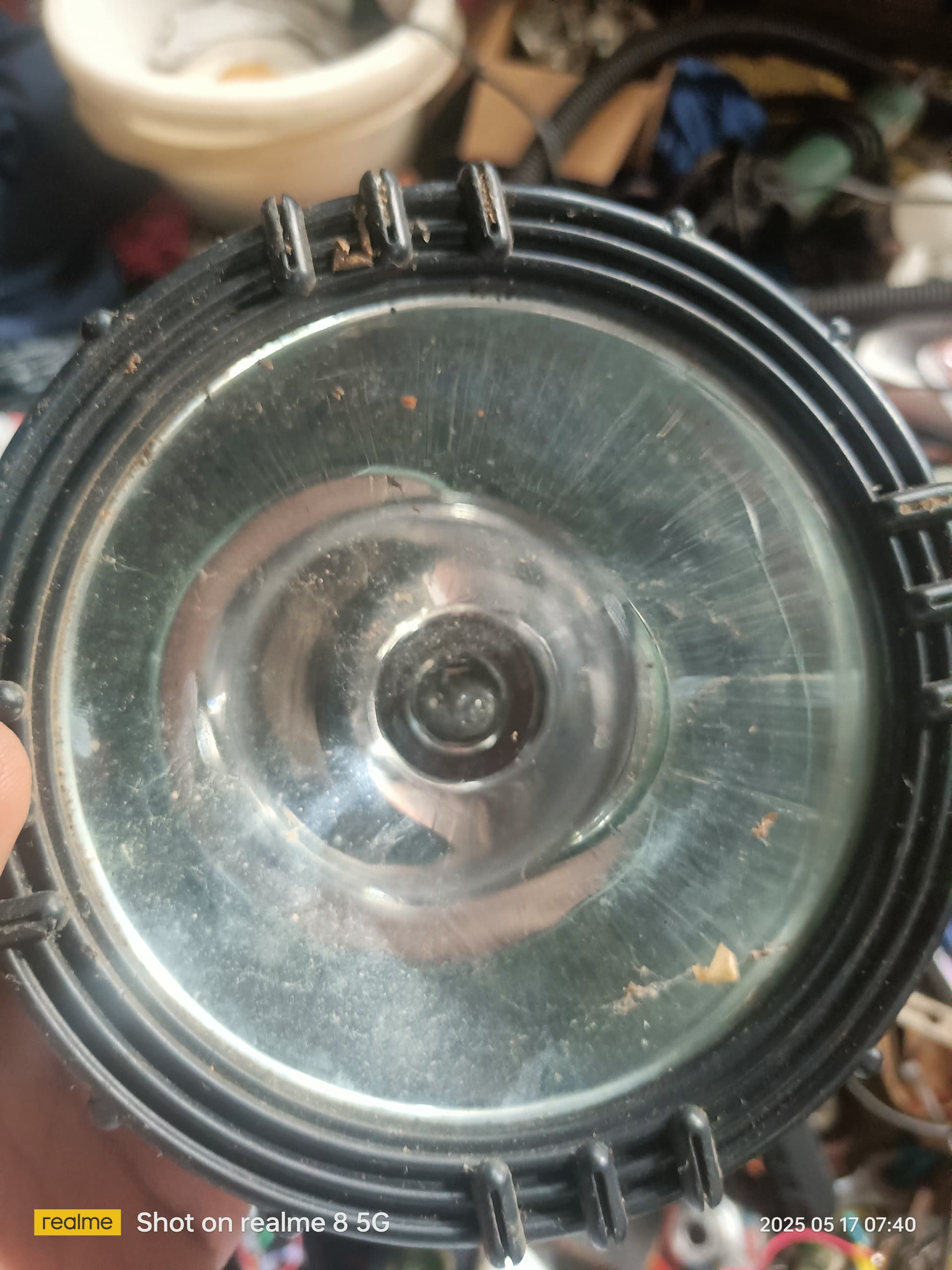

I can’t send a picture of my lens of my flashlight,it is so big, my late father left it, he used it from search and rescue. i think i need much brighter Led so that it can throw far beyond than its normal bright on the halogen, bulb,. The dimensions of the lens are 5-8 inches round not sure
Its double or i think its triple bigger than the size of that convoy flash light on the link you gave.

Do you need a very far throwing light or is it more important to see a lot in front of you? With a Reflector that big I imagine it has a rather thin beam?
I mean, there are lights like the Nitecore TM39 that would probably fit somewhat well I guess, but they are really expensive.
