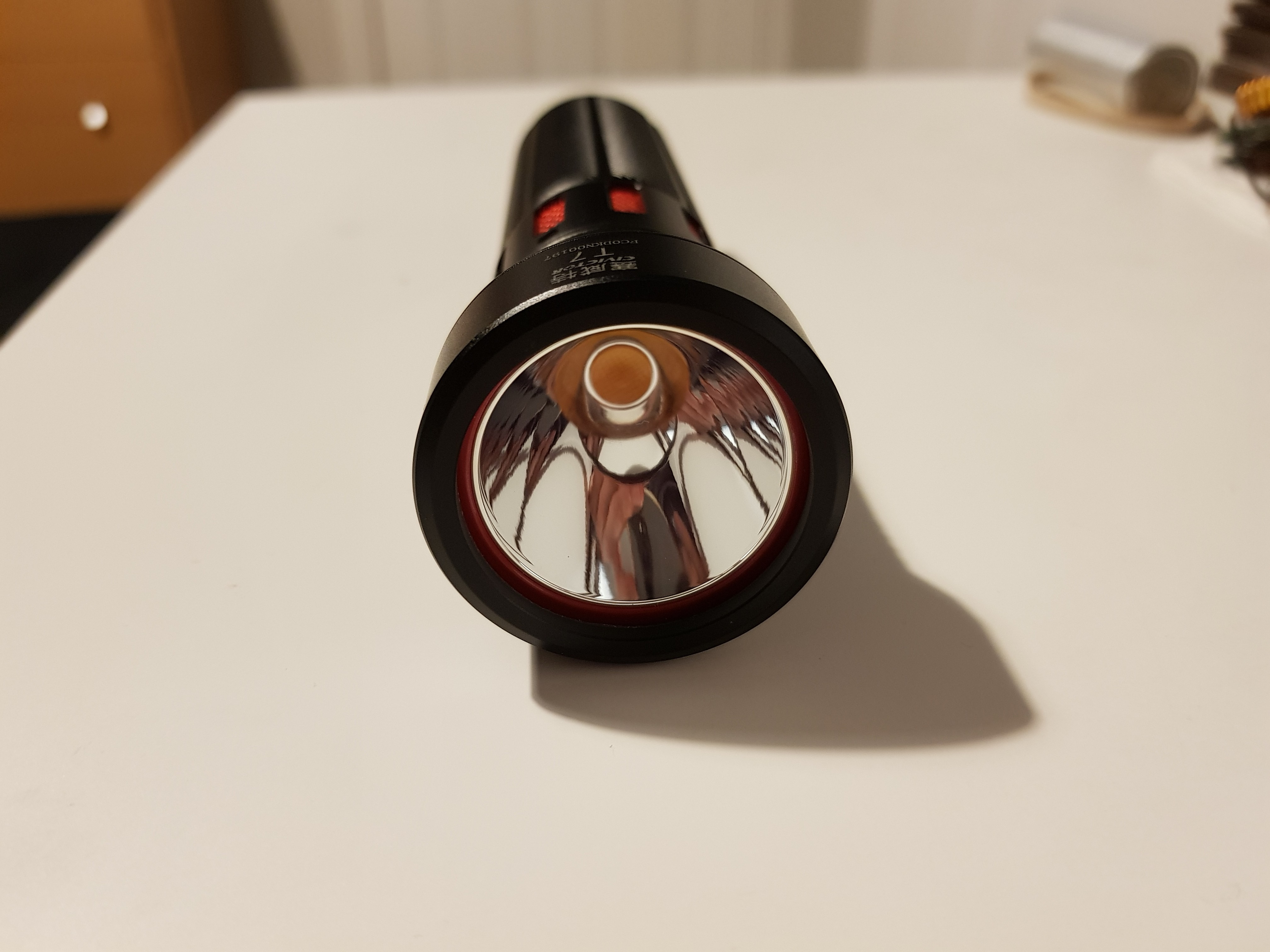

Ok, so here's pretty much how it looks - externally only for now, as the interior it's a bit.. ugly so far:
Also no beamshots as my phone is doing anything but taking a proper representation of the beam on the wall.. also doing loads of banding.. just looks terrible and nothing like what I'm seeing in front of me.
I'm very happy with the beam, big hotspot, bright flood, low artifacting, no crazy tint shift and a smooth fade corona - there are slight artifacts in the hotspot tho, hence why I've called it an "old style" looking beam.
