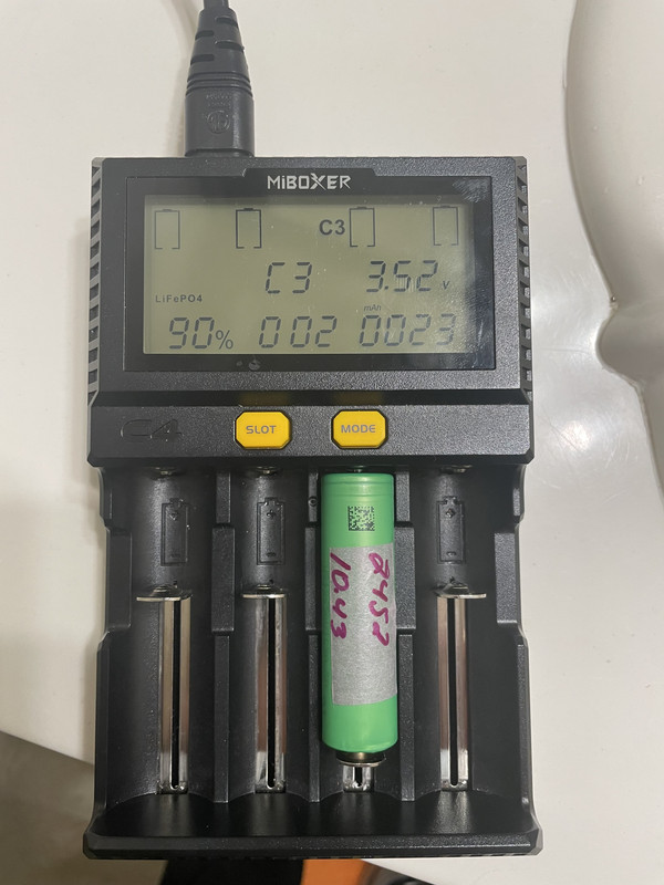

MiBoxer —you have to initially choose LifePo4 but if the power goes out it remembers the last setting
Which MiBoxer exactly? I have similar chargers from Dlyfull and it remembers nothing if the cells get ejected or if it gets plugged out.
Yeah, if you know which specific model works like that, it might be the answer for me. Thanks
I know how many revisions of the C4 already exist, that´s why I´m asking

MiBoxer C4 – double click mode button–toggle through chemistries — if the power goes off the mode is saved when the power is resumed – if you take the cell out of the slot – you have to reset back to LifePo4 ( Li-ion is default or of coarse Nimah is the voltage is that low)

I think there are minimum 4 Versions of the C4, dunno if all have the same behaviour
