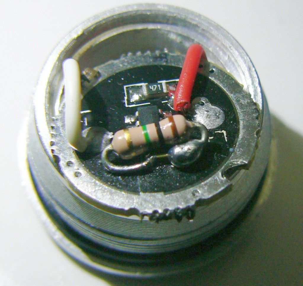

Here's the picture of the memory removal mod - the big resistor was added on top of the capacitor.

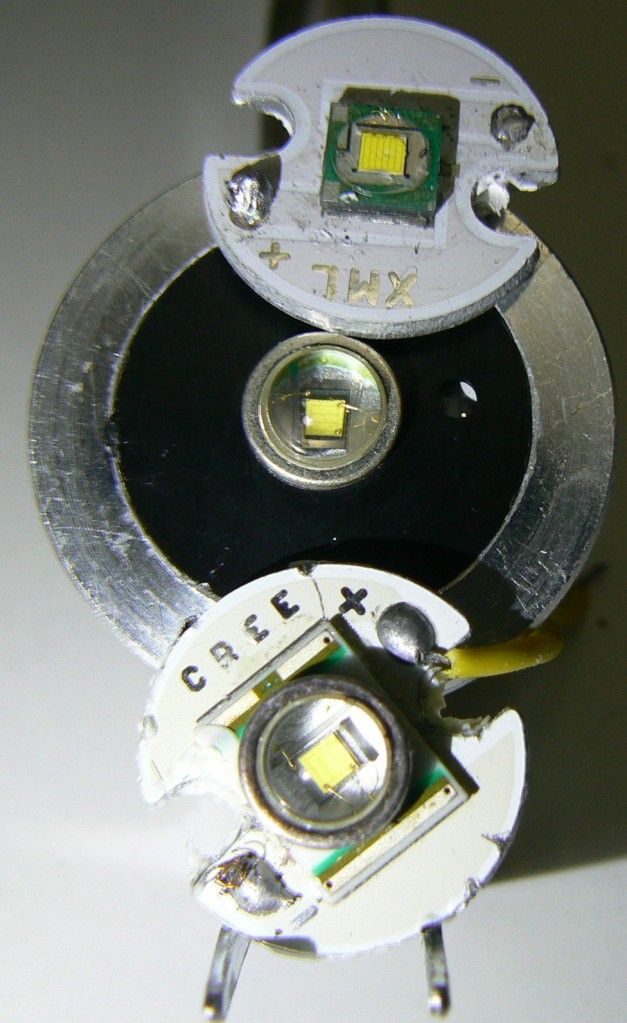

And the XR-E was indeed the smaller version EZ900. The C8 EZ900 one was in the middle, EZ1000 on bottom, XM-L disastrous dedome on top.
go wrong? Maybe we can all learn from your observations.
That dedome was unrelated :) it's there in the picture just in case anybody wants to compare XRE EZ900/1000 vs XM-L die size.
The XM-L was from the king which I tried to dedome from the front so I don't have to remove the heavily glued driver to access the led/reflector.
I let the king run for less then 5 minutes to heat the LEDs. Obviously I underestimated the king's heatsinking ability, the LED was not hot enough and the silicone peeled off together with the wires.
Luckily I had three $3.60 XM-L emitter stars from DD offer last time. :P
de-doming attempts ain’t for sissies! 8)
