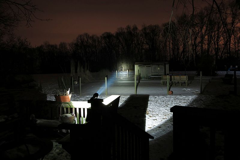

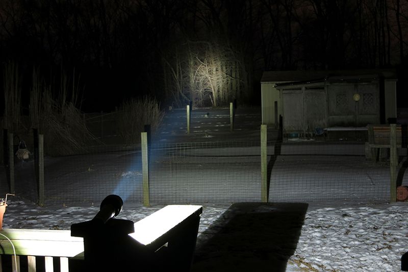

As many of you are aware of by now, these lights were on sale at home depot for $8.98! These are great lights stock, I picked up a couple of them. This is just a thread I wanted to make to let you guys know what I tryout with these lights since many of you are going to want to tinker with these too! The first thing I wanted to try is to swap out the LED. I replaced it with a De-Domed CREE XM-L2 U2 1D LED on Noctigon 20mm MCPCB, and I am really liking it. I still need to add the copper braid to the tail spring and increase the current in the driver (stacking resistors or just replacing). I plan on eventually switching to 3 x 32600 batteries but I need to order them and a driver; I am open to any recommendations for drivers… I still need to do some research.
Here is the results of just the LED swap. The woods line is about 100 yards away.
