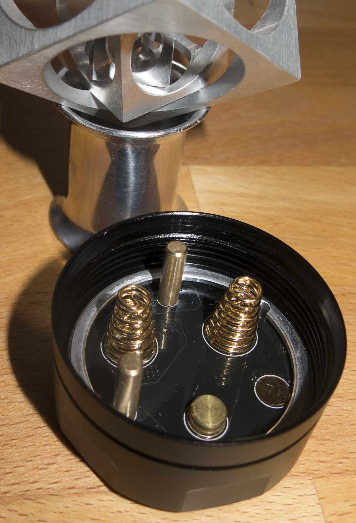

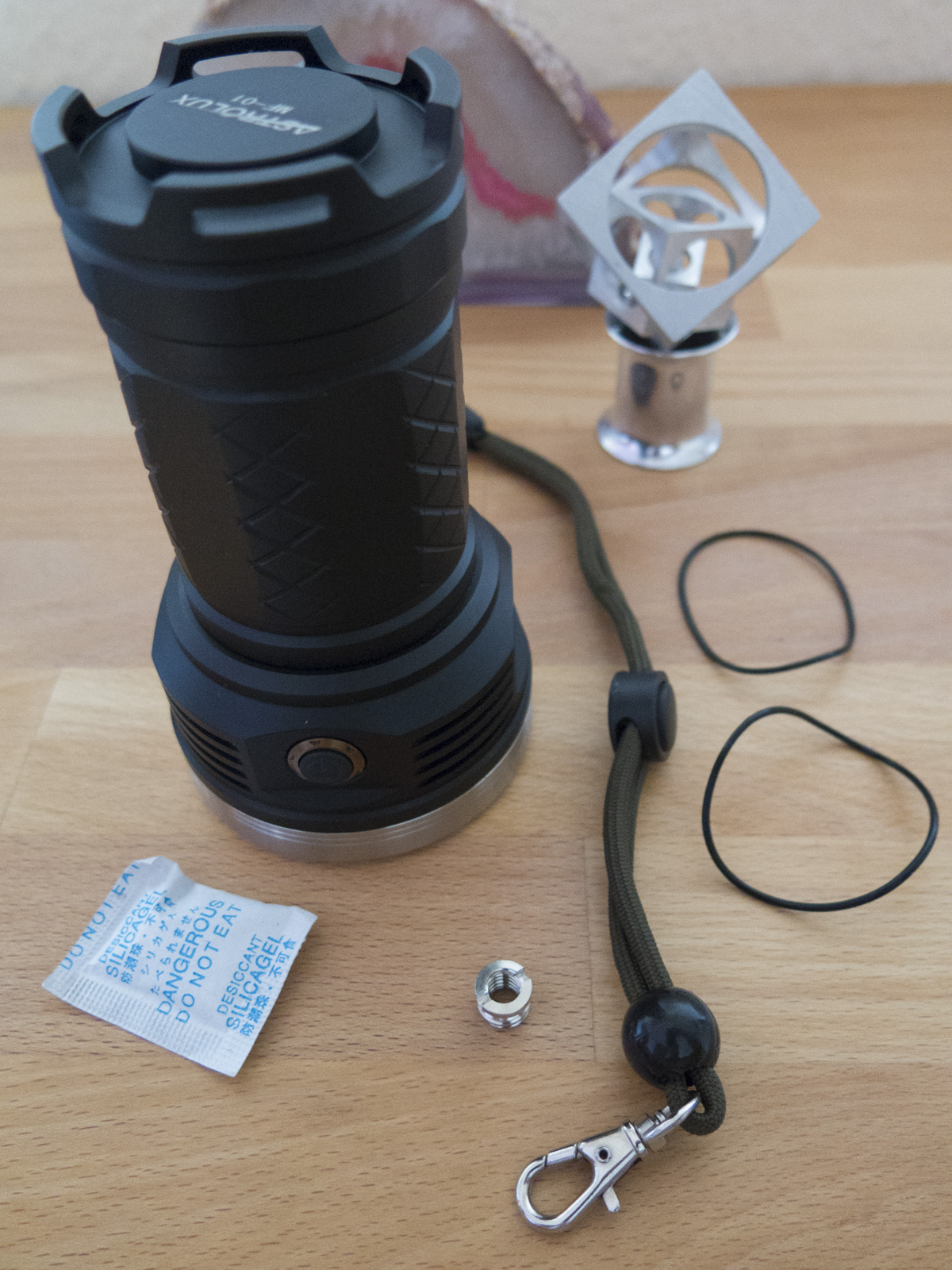

Klarus uses silicone covers with 2 o-ring shapes so it fits very tight
That big silicone boot, needs definitely something to stiff it up, like a thin PCB material attached to it, but usually glue something to silicone is a pain, maybe produce it from reinforced silicone?
but on the other hand you have a tail cap, so the silicone thing on the back is kind of counter productive
I would stick with just the tail cap, the thread not to the edge, give a few mm clearance for o-ring sealing
And make the threads square cut and with about 1mm pitch, too small triangular threads wear out too fast and can be hard to screw on with larger diameters
Also some Lanyard attachment like Tail cap with holes is always useful
and have a small cord to hold it to the body so it cant get lost, like “shit it fell in my trucks engine”
Same for the head, give the thread a clearance for o-ring and sink a groove for it on the body
Do you want to keep the body made from a pipe, then you have to machine a press fit shelf, like Klarus has in their G35 when you push the XHP70 to 12V 3-4A,
XHP70 DTP star is good, but on 12V get one that has the thermal pad insulated like SinkPad II
Those Sinkpads are OK, MTN, Fasttech and LEDDNA sells em
This LED star will not work if both the star and battery are not insulated from the body, so as if you use the tube for conducting current
I think the battery should be a LIPO, maybe a 3S or 4S 4000mah 15C or more like these these can deliver 15 amps easy to turn on the car, I have started cars using a 3S 5000 lipo
