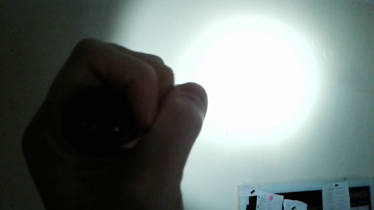

Bought 5 zanflare f1’s during the flash sale and 2 were DOA unfortunately.
Any idea what could cause this flickering and dying out?

Nope, it is not PWM for sure. When i use the “flare” mode the light spikes in output and the spikes are noticeable by human eye but not by my mobile phone camera, it is overwhelming and the small sensor of the phone camera does not even care when the change in brightness happens so i cant really film a video of that problem.

Too bad they glued the light, it might have been something easy to fix, i would gladly do that instead of arguing with gearbest stuff on how and what is wrong with the light.
