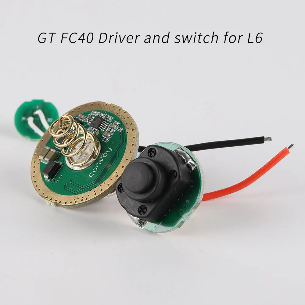

Hi all. I was interested in doing a sense resistor replacement to dial back the amps delivered by the GT FC40 Driver from Convoy. It’s a boost driver (12V nominal) and I wanted to verify that swapping the R020 next to the LED- wire for a R040 should approximately halve the mA output of the driver.
I’ve never done this to a boost driver and don’t want to nerf such a nice piece.
