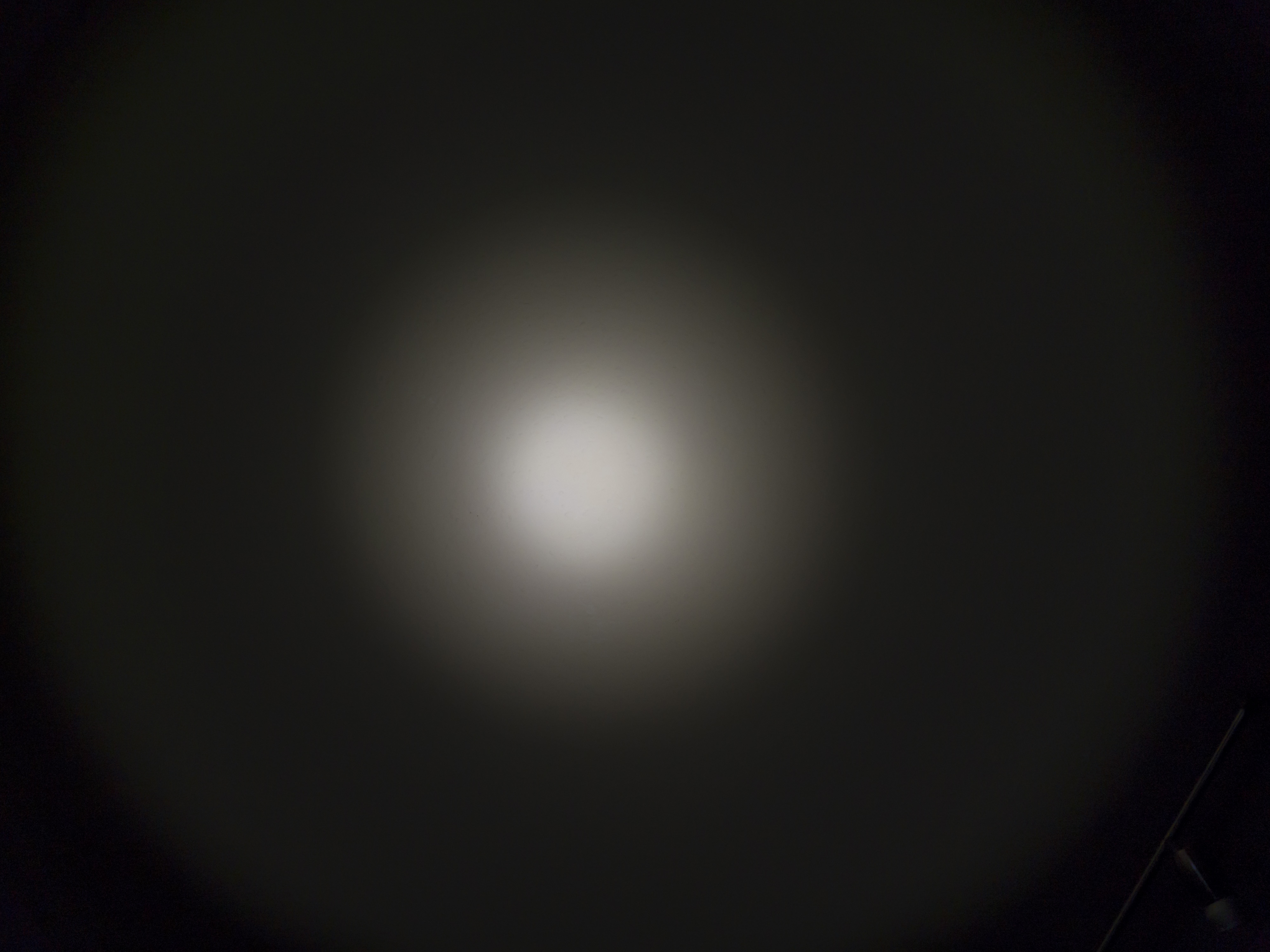

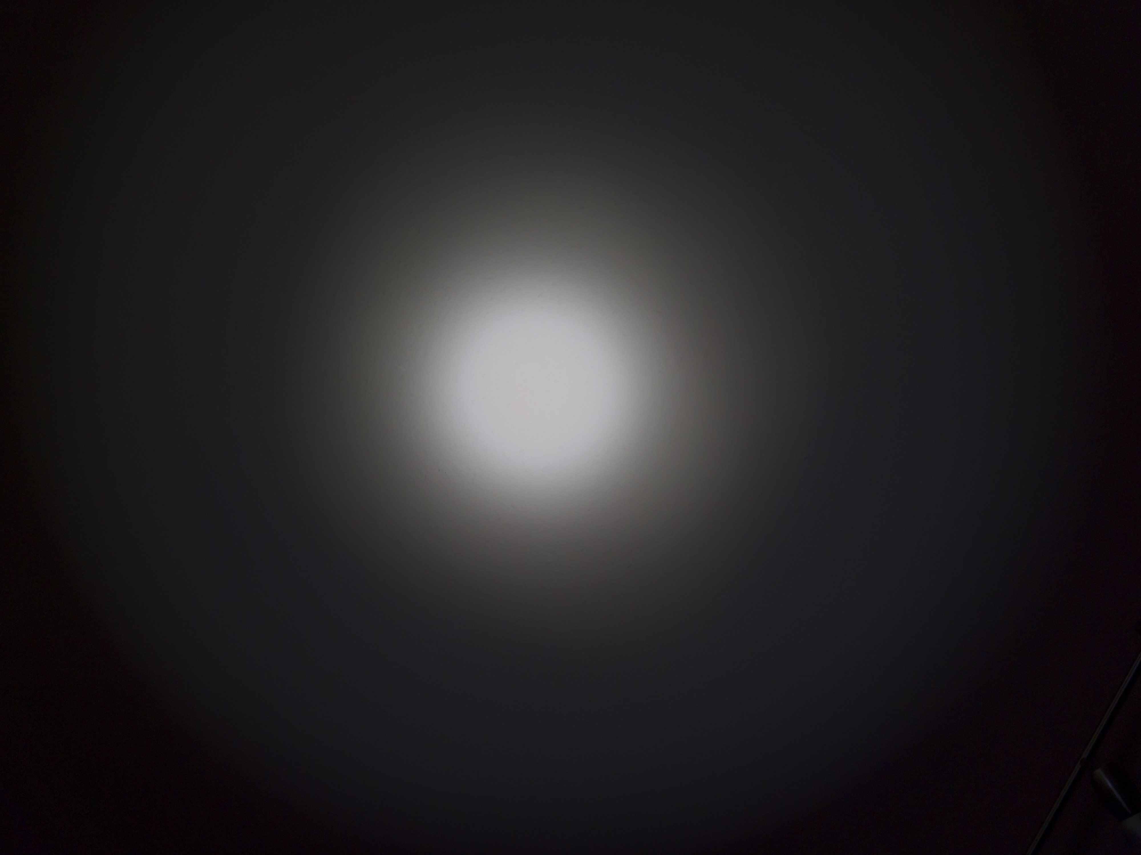

There are quite different designs for reflector shapes even if its the same size and depth
I saw different results having 2 identical sizes just the one had pretty much a very tight hotspot then degrading brightness until puse spill
the other has a tight hotspot and a cone with a brighter spill with sharp edges and rest normal spill
to get the real brightness I would need to stack a HDR image

I assume this is not a focussing issue, like the one having a thicker flat base than the other one…
I have seen a few reports of XR-E reflectors throwing farther than XM-L(2) reflectors.
Apparently they’re not all just a section of a parabola.
Could production precision be a factor too?
