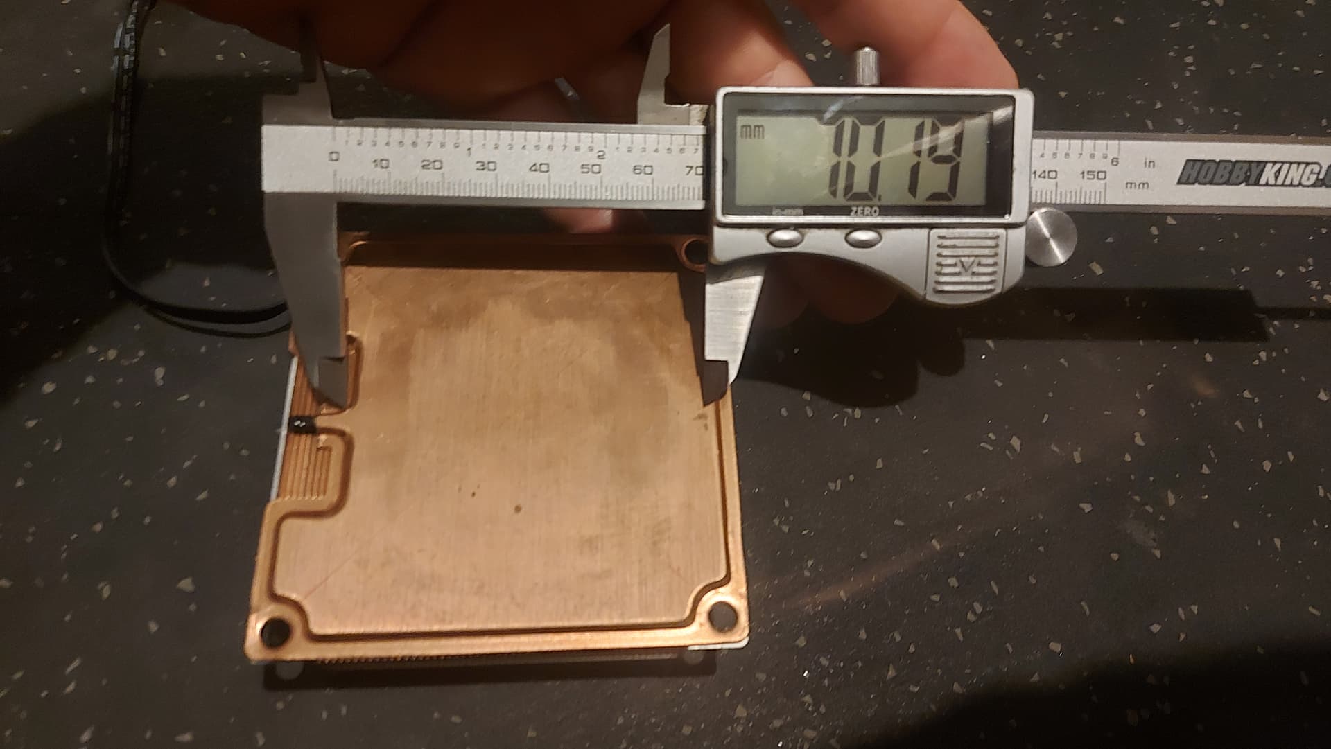

Workstation CPU coolers have a larger base, for example : NH-U12S TR4-SP3
I couldn’t find drawings, but from the pictures it looks to be around 7.5cm, which should be enough to cover the LES.

A Peltier plate will add more heat to be dissipated. A rough estimate is twice the heat. It needs substantial current as well, easily around 2kW power alone for cooling this LED.
Does the LED manufacturer suggest a cooling device?
Maybe build your own heatpipe or vapor chamber for this.
Or use a copper baseplate as a heat spreader and four of these huge Xeon coolers to shovel away the heat of the 2kW LED, without Peltier.

That was my thought, however the beefiest Xeon I was able to quickly find in terms of TPD is ~330W. Suspect that getting >4 of those to interface with a primary cooling loop might be more involved than simply using something larger.
