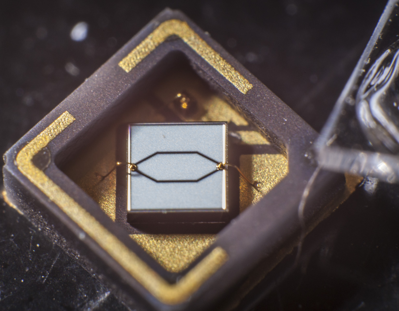

I am looking for a 1.4A boost driver which is able to run a 4.1V LED
when not running at full current the LED has lower voltage than a 4.2V Battery voltage
for this Nichia beauty
Buck-boost from zebralight?
yeah most likely a buck/boost driver, but not more than 1.5A for this UV non DTP pad LED, the additional 100mA I could bypass with a resistor
