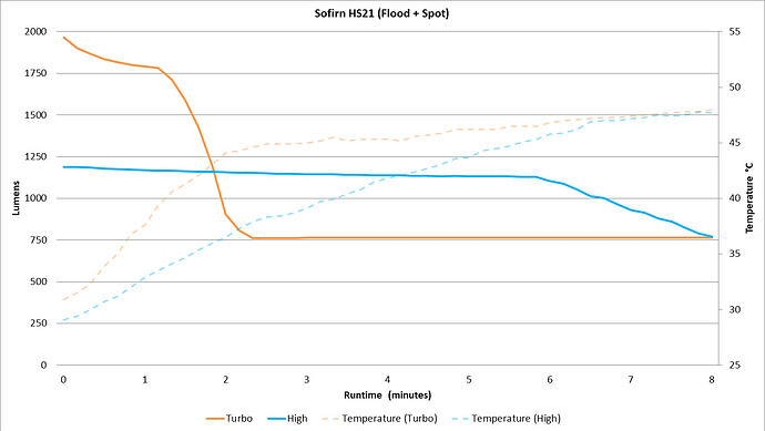

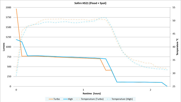

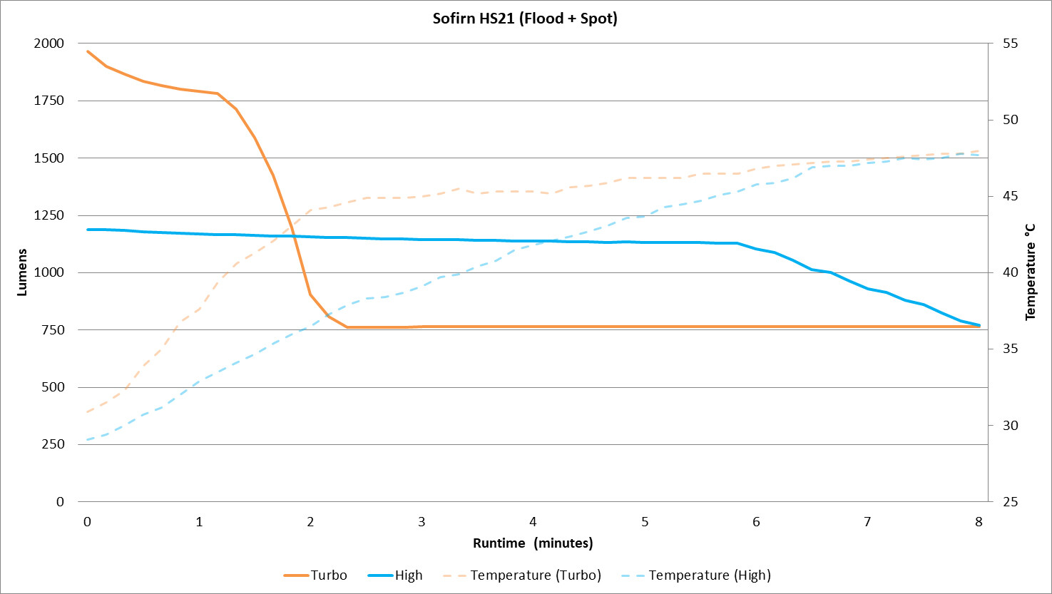

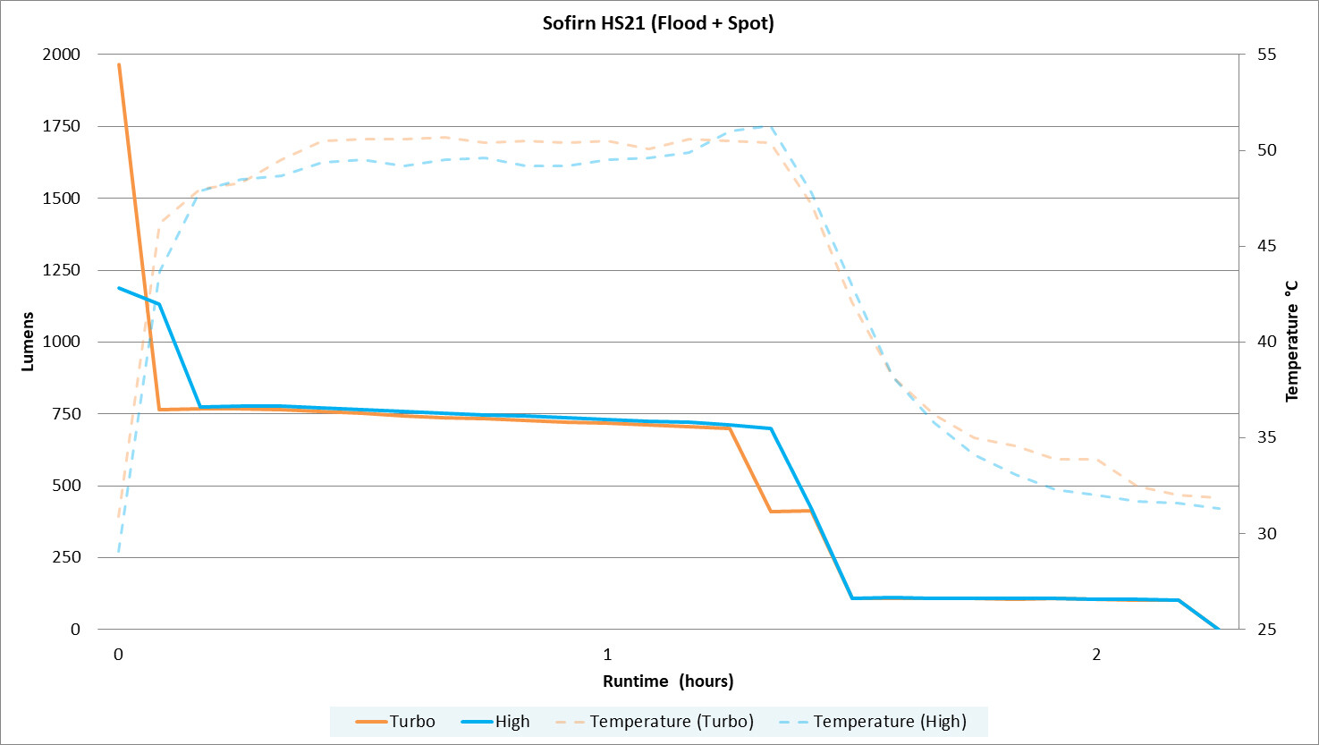

Previous Sofirn flashlights I tested said thermal regulation once temperature hits 55° C. Yet they all go passed that which is extremely hot. The HS21 manual doesn’t mention anything about thermal regulation. Looking at my runtime chart the output goes down way before it hit 55° C.

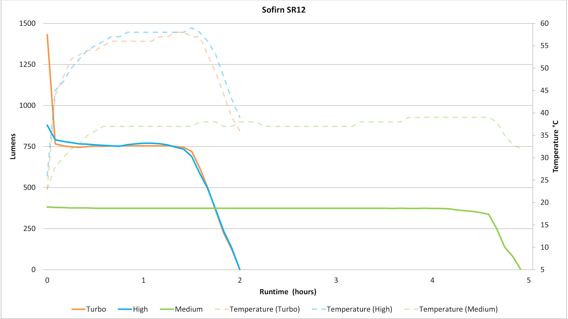

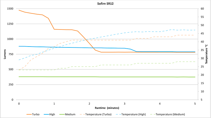

Here’s the runtime chart of the Sofirn SR12 which claims thermal regulation at 55° C. Turbo drops down quickly way before hitting that temperature and max temperature reached 58° C. Mind you I measured external temperatures so the driver temperature would’ve been higher.
