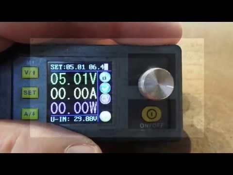

The front panel – which I have to say is VERY pretty, allows you to set up not only the maximum voltage, or maximum current but also the maximum power. Not only that but you can also set up to 10 memories for easy recall. So this immediately makes for a small, neat and very useful supply.

Stable output voltage
Of course – now you’re thinking – well, that’s all very nice but how does it perform as a power supply. Right now I’m awaiting some test gear but I set the current maximum to 1 amp, voltage at 5v and applied a 2 ohm load. Sure enough, the voltage immediately dropped to ensure no more than 1 amp flowed.
When I removed that restriction the same load (not precision resistors, just ones I had lying around) – saw 2.4 amps flow through the resistors – a total of 12w of power… all of which sounds about right. The output voltage stayed rock solid at 5v. I could only do this for a few tens of seconds as my finger were burning holding the resistors. The supply itself remained freezing cold and the fan stayed off during this time.

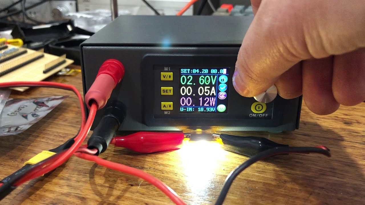

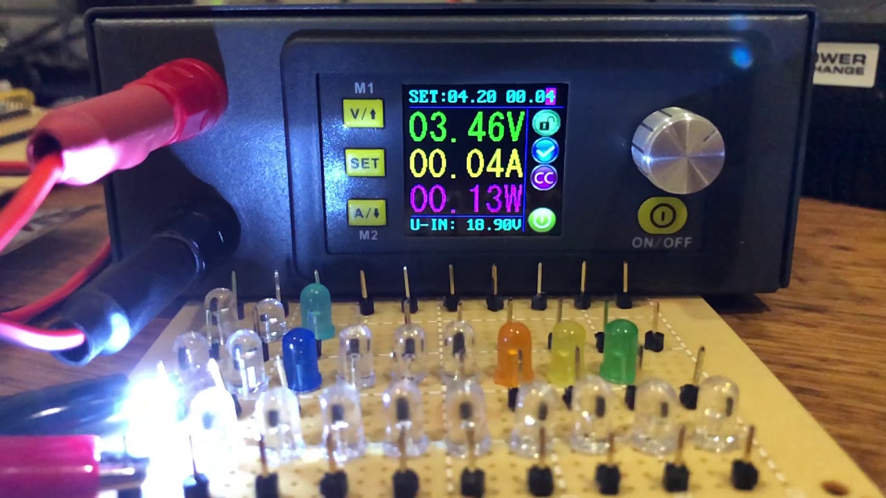

To test the other extreme, I set the output to 20ma and attached a small (disposable) LED to the output – and turned the unit on – sure enough – soft start and the LED came on nicely.

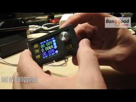

Of course, Ruideng do a range of supplies and one of the smaller ones is particularly interesting. If the powerful unit above all sounds a little over the top, there is also a little stand-alone version that all fits in the front panel container and this one came from Banggood. This unit does 20 volts maximum at 3 amps…. and is called the DPS3003 – it is VERY neat, needing just 20v DC max input. There is no serial or Bluetooth but then it is also cheaper, does not have a separate control board (it is all in the front panel) and would fit in a much smaller box. Here is the link if you’re interested.
