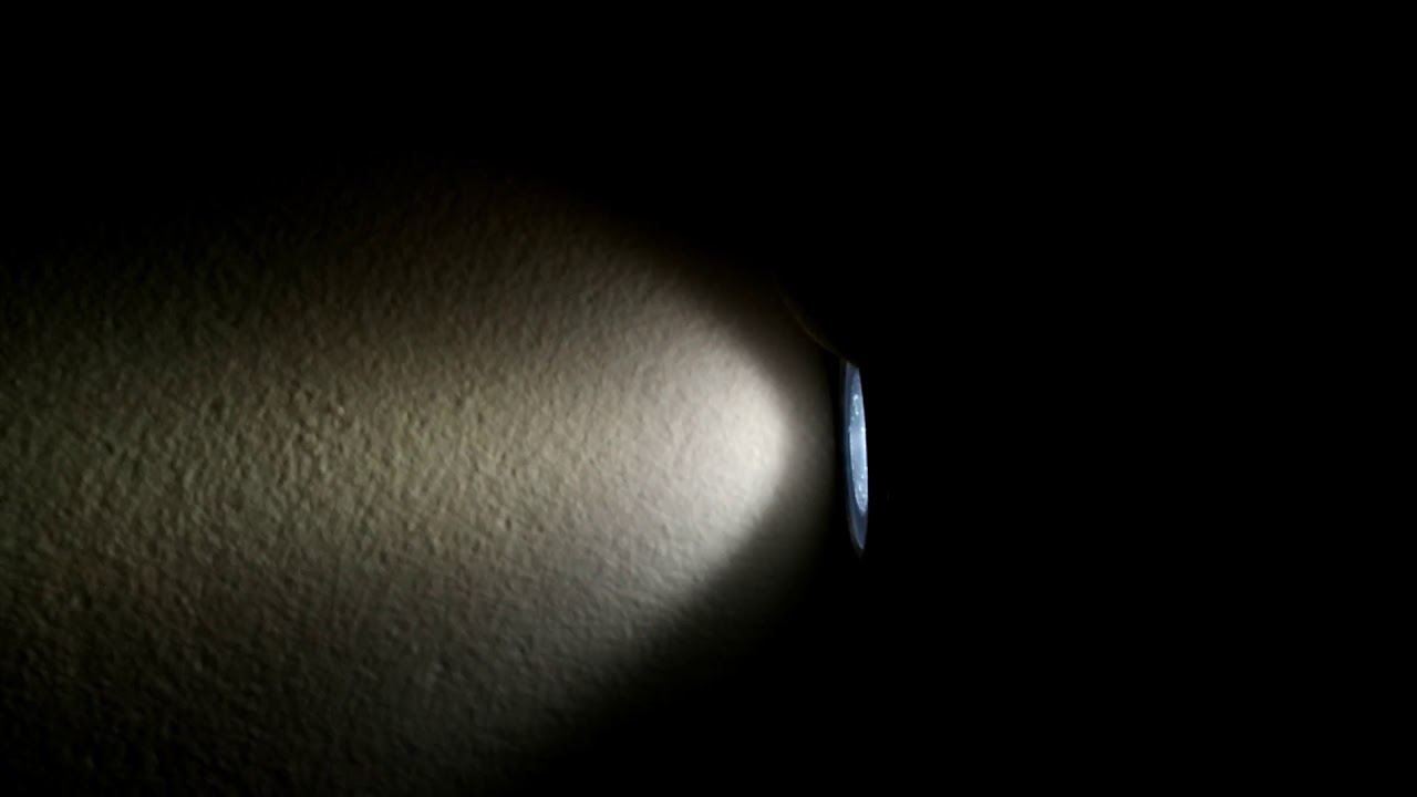

Moon with and without a mild diffusing filter:

It’s raining heavily at the moment, so no beamshots for today. I’ll take some tomorrow if the weather improves, and update this then. The reflector is from a Jetbeam JET-1 MK, and there is a mild diffusion filter, so if you’ve ever used an AA/14500 light with an XML or XPL size emitter you already have a good idea of what the beam profile looks around the house or outside. It’s a nice balance between the floody spill and some mild but usable throw, with a diffuse, smooth transition between the two.
