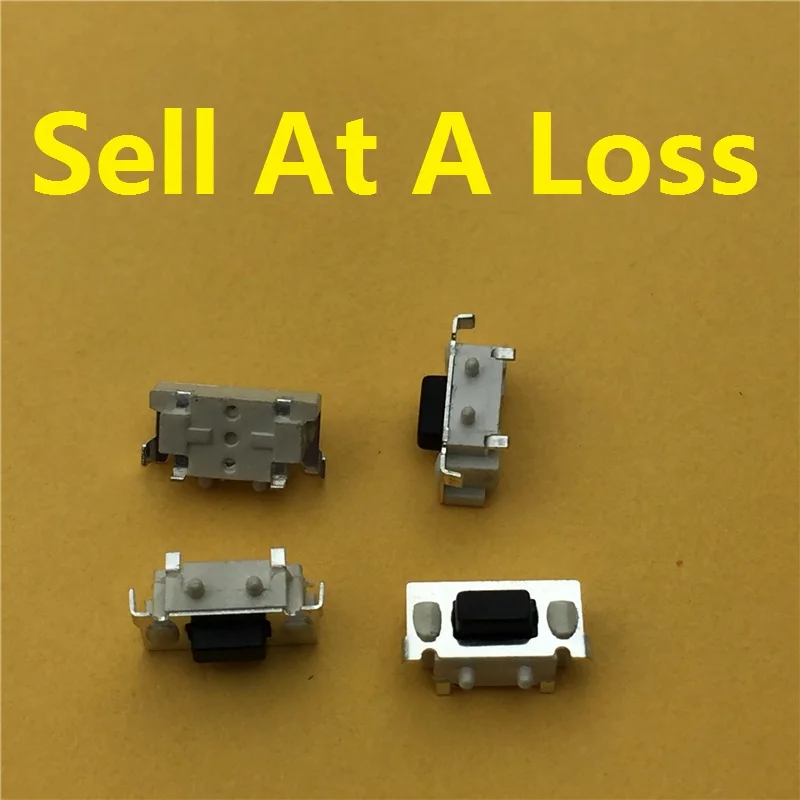

I think itās these:
$ 0.74 for 50 piecesā¦
could be that, but it has to fit EXACTLY and be EXACTLY the same size
this one looks different, has rectangular button instead of round
wle
Mine has a rectangular button, i think the one linked is exactly the same as the one i have.
