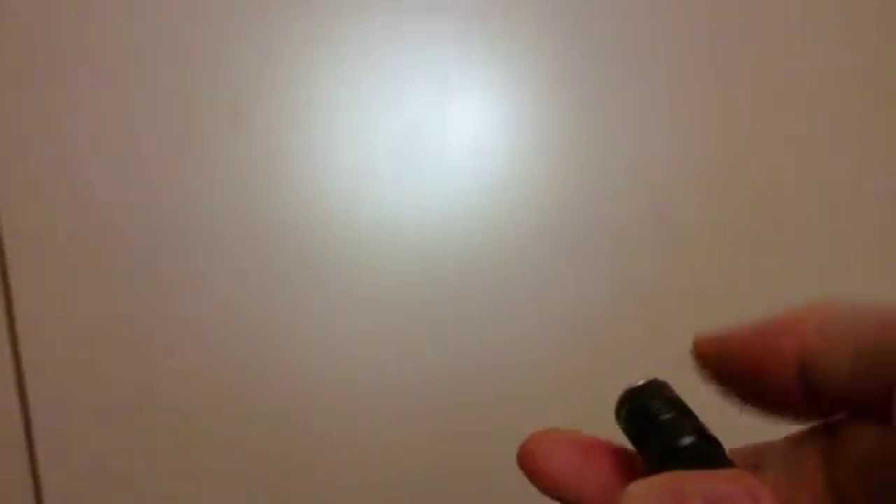

Here is my favorite the Jexree Mini, this is version 8 with a smooth modded copper beryllium spring
that makes the modes much easier to control + more output than the tiny little stiffer stock spring. I will detail the version 8 soon in my Jexree Mini mod thread.
Here is one more of the Jexree Mini mod V8 but with less room light.
This is of the stock Jexree Mini, i haven’t even lubed the threads, just dropped in a Eneloop
So it still has the stock boost driver.
