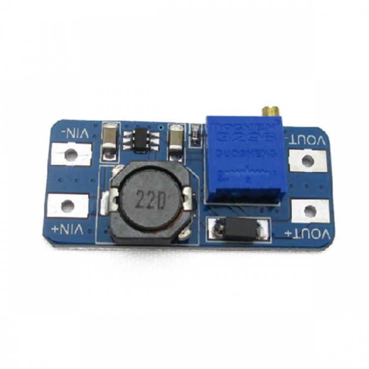

The circuit that you will need is called a Boost power supply, it will take your 3.3 to 3.0 VDC from the cell and “boost” it to the higher voltage needed for the LED.
The main components will consist of an inductor, a diode, a capacitor, a current sense resistor (low R) and a big-ass transistor. A control chip is needed to drive the transistor based upon the feedback signal from the sense resistor.
Example:
If you have the makin’s then you could roll your own; but there are boards already available that do this for low cost. Buy some and start playing around with that thang.
[edit] search for example boost boards.
MT3608 2A board
XL6019 5A board
