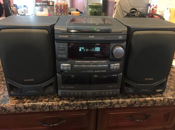

I have an old 30Wx2 Aiwa shelf system I bought a couple of decades ago. The speakers sound great, but the main amplifier unit is huge, housing a dual cassette deck, and CD changer, neither of which work, or are needed. I only use the unit for the line-in function, to play music from my phone. I would like to convert this unit over to run from an external amplifier with Bluetooth.

This is the model deck I have. One of the first nice things I purchased for myself as a teenager. Sounds great, just a lot more bulky than necessary.
