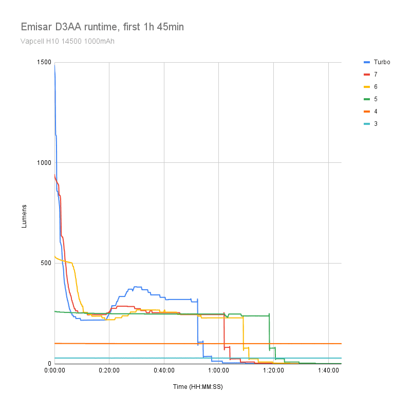

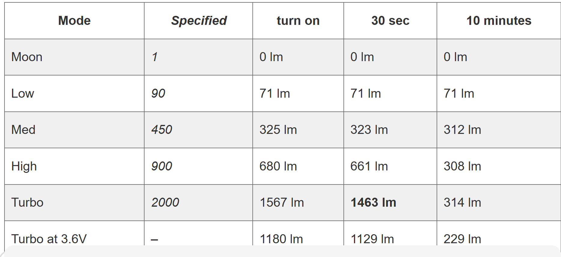

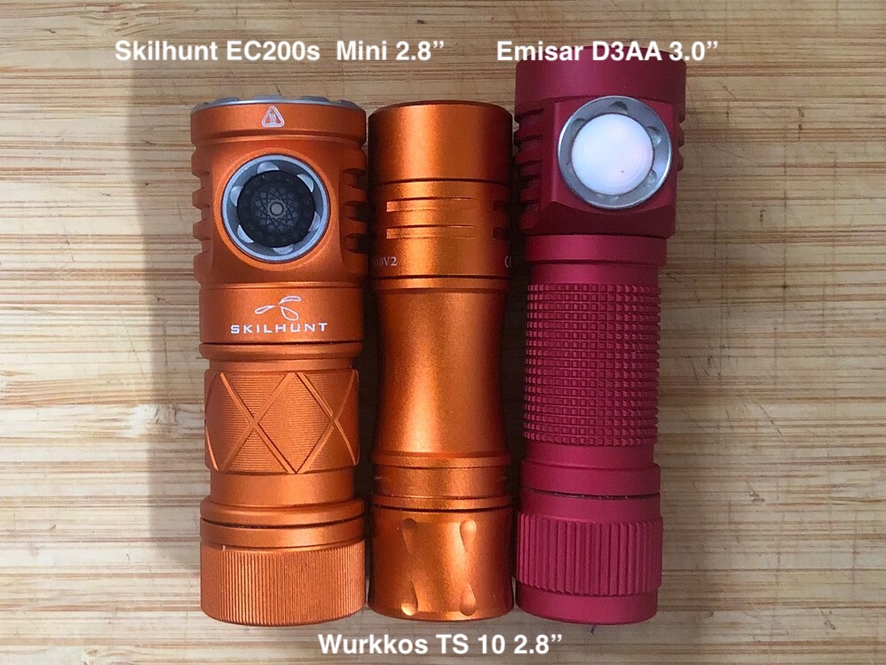

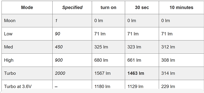

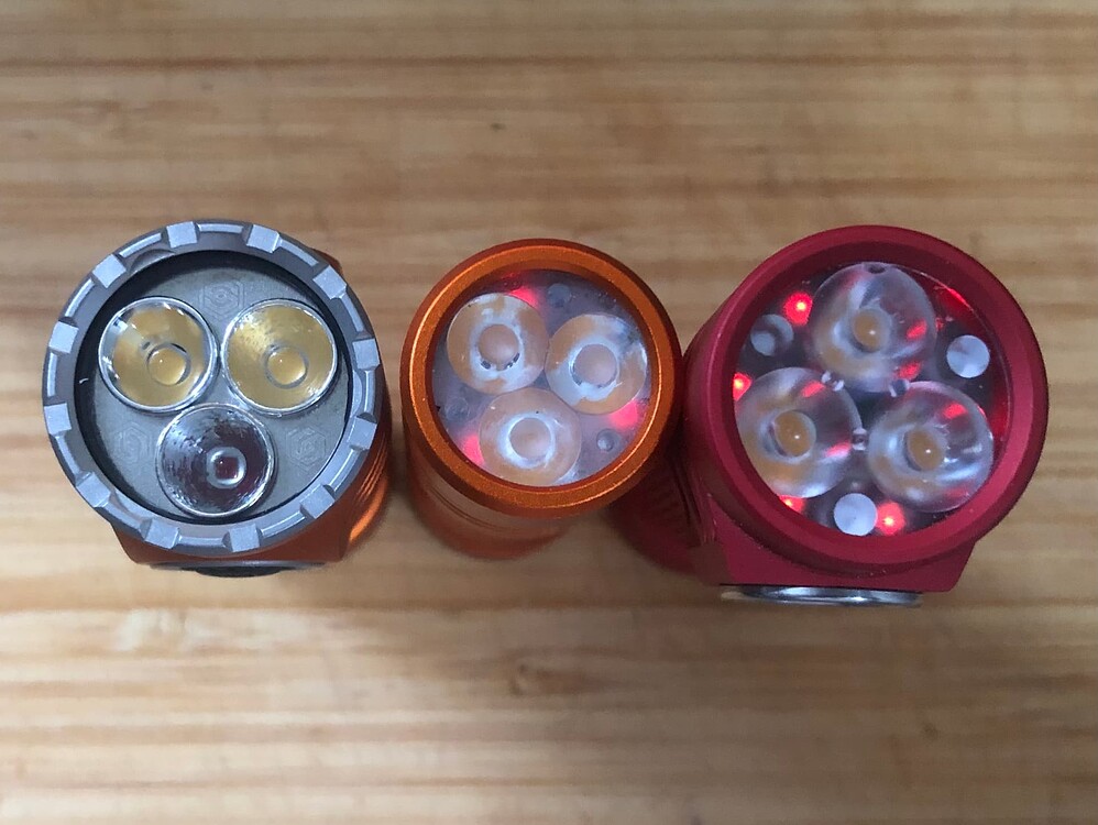

I hope you find an EDC light that suits you, here are three small lights that I enjoy. Each has a link to a review for full details, plus Im including a runtime chart so you can see realistically what the sustainable output looks like:
The Skilhunt has USB-C charging.
The TS10 is my most carried light because it is the smallest and has the lowest weight.
The D3AA can use AA batteries…
