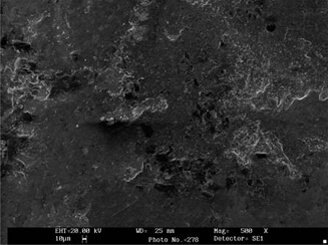

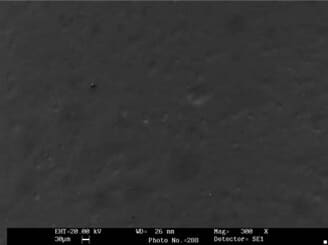

A little bit of research makes me optimistic that this is a real deal process...for stainless steel. There is even an ASTM standard for stainless (ASTM B912). Further research shows that it is used for aluminum as well.
Before and after electron microscope pics from ableelectropolishing.com.
There seem to be at least two theories as to why this works. Neither one of them make much sense to me.
