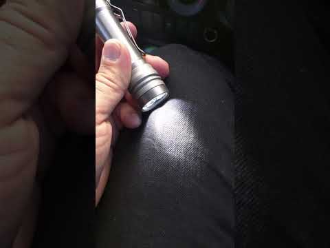

I wondered what was going on with my light last night. Turned out to be low voltage warning. Last night I checked the battery and it seemed to kick in the warning (on high mode) about 3.6v. Today at work I played with it again and the frequency of the dimming seems to have increased as the voltage gets lower. I don’t know if the light will shut off at some point and am reluctant to run the battery down to find out as it is unprotected and I have no multimeter or charger to check the battery voltage.
Low the voltage higher the frequency
Edit: when I was able to check battery voltage I kept running the light. Voltage got down to 2.7v with no shut down.
