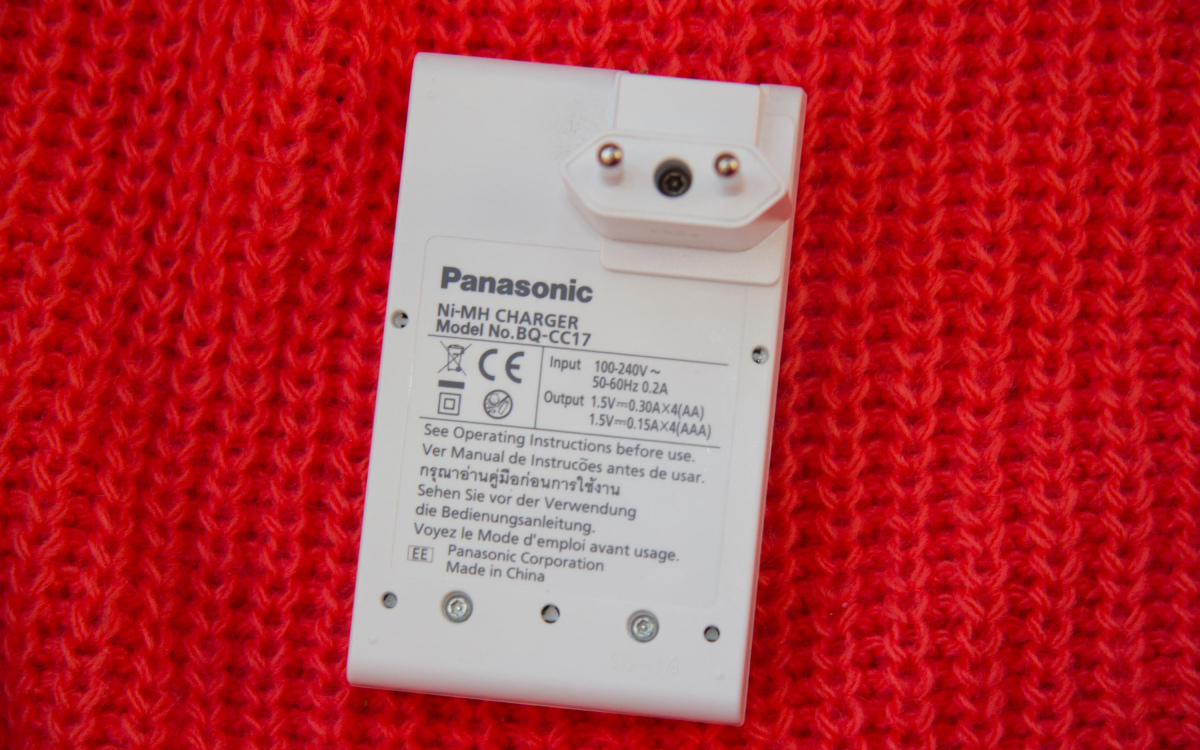

BQ-CC16 charger according to the spec sheet is supposed to be charging AAs at 550mA whereas the print on the charger says it does so at 300mA. :stuck_out_tongue:
That’s funny because it’s the BQ-CC17 that does so.
Here are some pics— open em’ in new tabs to see full size
take a look at the spec print on the charger’s back side :slight_smile:
and now take a look at the spec printed on the instruction manual that came along with it
That’s right. AA 300mA and AAA 150mA on the charger and AA 550mA and AAA 275mA on the manual.

I’m Guessing somebody took the effort to re-print either the model number or spec on the charger but got lazy when they got to the packaging and manual part?
