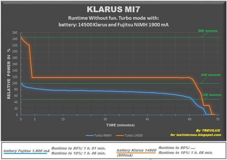

I have make 2 version in english of the runtime graph for show here in BLF (review with one unit bought by me)
1. Tested without fan in the hightest modes with NiMH Fujitsu 1.900 mA and Klarus 14500 (800mA), for see datail of step down;
Now complete runtime without fan, with the same batteries:
When finish I remove the battery and I have measured 3.12V with the Klarus 14500 and 0.9V with the NiMH:
