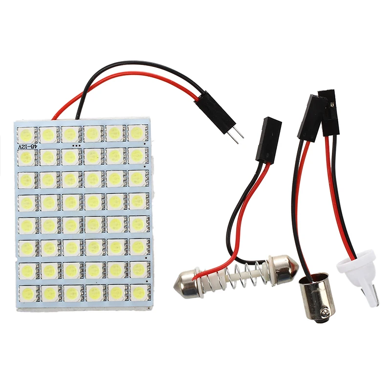

I got something that looks a bit more like this:
Rather than a COB. Mine was some real brand sold at a brick&mortar store in the US, but also about four years ago… It did have some circuitry involved, so I hope it has some sort of current regulation.

I ordered some warm white LED festoons from Aliexpress and they weren’t as bright as I was hoping for. First I tried the 6x 5050s and then the brighter 6x 3030s, which ran hot. I also didn’t like the tint.
However, I’ve been quite satisfied with the 48x 3528s using a festoon adapter similar to the one posted by Scallywag. Also the tint is decent. This is the one I got:
